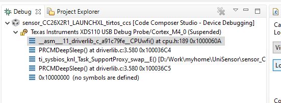

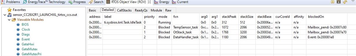

  • It seems that device is responsive. See the images attached. If I set a brakepoint in OtStack_task there comes some events (OtStack_procQueueCmd_alarm, OtStack_procQueueCmd_tasklets, etc) but not very often - so this task is not looping. The same with tempsensor_task and datahandler task - they are alive but not looping. It seems that the main core is in deep sleep.
    Thus - can it be that network processor is looping consuming the power?
