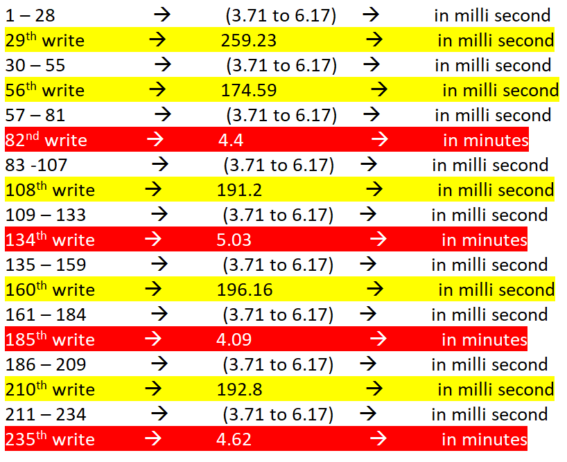

The first experiment they ran is as follows:
While using NVS library, we experienced varied write times.
We did following steps:
    1. Defined a structure of 276 bytes
    2. capture current time (t1)
    3. used NV api function (pNV->writeItem) to perform write operation.
    4. capture current time (t2)
    5. calculate time taken for write operation (t2-t1)
    6. Repeat steps 1-5 for longer duration approx. 1hr
(delay given between 2 consecutive writes = 200 msec)

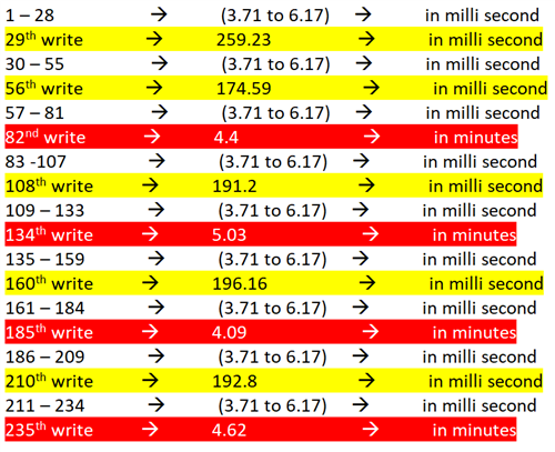

If you look at the yellow highlighted sections, and do the math on the sector size of 8K and structure size of 276 bytes, it makes sense that these likely line up with compaction. However, what is very concerning is the lines highlighted in red that take minutes to complete. The customer decided to perform another experiment with smaller data sizes to investigate further, and it yields some interesting results:
It seems that the longer write times (several minutes), seems to be somehow tied to write structure size. Is there some insight into the write algorithm or configuration that can be undertaken in order to improve performance for the customer's use case?

  • Hello Stuart,
    The Compaction theory makes sense. I am not sure however about what happens in the red slots. It seems to occur at roughly every 50 iterations.
    1) Which SDK is this?

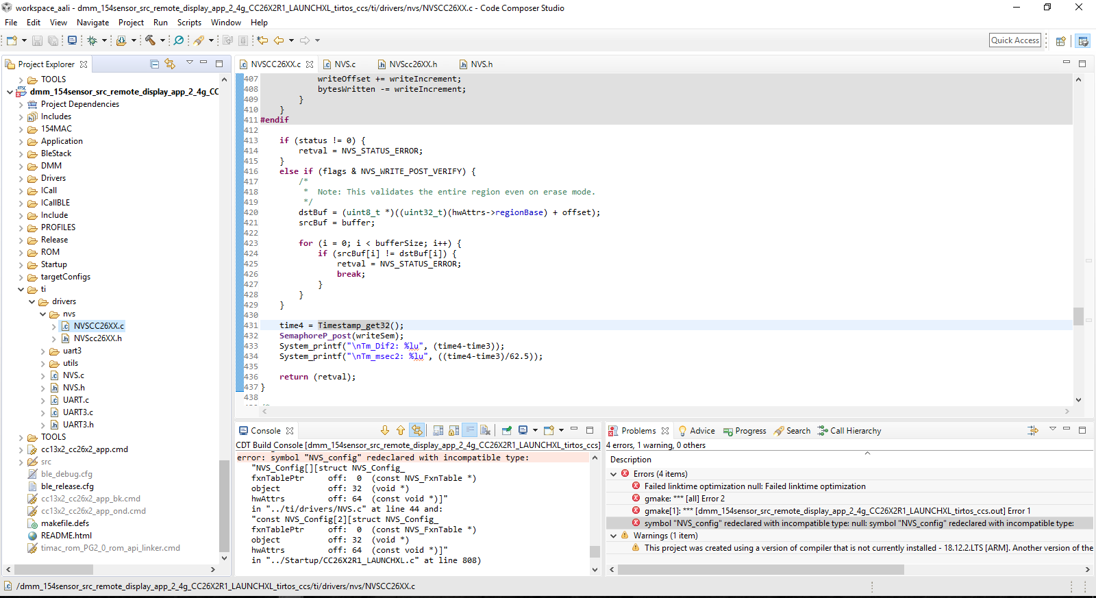

  • Console Logs:
    **** Build of configuration Release for project dmm_154sensor_src_remote_display_app_2_4g_CC26X2R1_LAUNCHXL_tirtos_ccs ****
    "C:\\ti\\ccs901\\ccs\\utils\\bin\\gmake" -k -j 4 all -O
    making ../src/sysbios/rom_sysbios.aem4f ...
    gmake[1]: Nothing to be done for 'all'.
    Building file: "../ti/drivers/NVS.c"
    Invoking: ARM Compiler
    Flags: --cmd_file="C:/ti/Aali_SRS/dmm_154sensor_src_remote_display_app_2_4g_CC26X2R1_LAUNCHXL_tirtos_ccs/TOOLS/defines/dmm_154sensor_remote_display_app_2_4g_FlashROM.opts" --cmd_file="C:/ti/Aali_SRS/dmm_154sensor_src_remote_display_app_2_4g_CC26X2R1_LAUNCHXL_tirtos_ccs/TOOLS/build_components.opt" --cmd_file="C:/ti/Aali_SRS/dmm_154sensor_src_remote_display_app_2_4g_CC26X2R1_LAUNCHXL_tirtos_ccs/TOOLS/factory_config.opt" --cmd_file="C:/ti/Aali_SRS/dmm_154sensor_src_remote_display_app_2_4g_CC26X2R1_LAUNCHXL_tirtos_ccs/TOOLS/build_config.opts" -mv7M4 --code_state=16 --float_support=FPv4SPD16 -me -O4 --opt_for_speed=0 --include_path="C:/ti/Aali_SRS/dmm_154sensor_src_remote_display_app_2_4g_CC26X2R1_LAUNCHXL_tirtos_ccs" --include_path="C:/ti/ccs901/ccs/tools/compiler/ti-cgt-arm_18.12.1.LTS/include" --include_path="C:/ti/xdctools_3_51_02_21_core/packages" --include_path="C:/ti/Aali_SRS/dmm_154sensor_src_remote_display_app_2_4g_CC26X2R1_LAUNCHXL_tirtos_ccs/154MAC/HighLevel" --include_path="C:/ti/simplelink_cc13x2_26x2_sdk_3_10_00_53/kernel/tirtos/packages" --include_path="C:/ti/simplelink_cc13x2_26x2_sdk_3_10_00_53/source" --include_path="C:/ti/simplelink_cc13x2_26x2_sdk_3_10_00_53/source/ti" --include_path="C:/ti/simplelink_cc13x2_26x2_sdk_3_10_00_53/source/ti/dmm" --include_path="C:/ti/simplelink_cc13x2_26x2_sdk_3_10_00_53/source/ti/devices/cc13x2_cc26x2" --include_path="C:/ti/simplelink_cc13x2_26x2_sdk_3_10_00_53/source/ti/devices/cc13x2_cc26x2/inc" --include_path="C:/ti/simplelink_cc13x2_26x2_sdk_3_10_00_53/source/ti/devices/cc13x2_cc26x2/driverlib" --include_path="C:/ti/Aali_SRS/dmm_154sensor_src_remote_display_app_2_4g_CC26X2R1_LAUNCHXL_tirtos_ccs/Application/154Sensor" --include_path="C:/ti/Aali_SRS/dmm_154sensor_src_remote_display_app_2_4g_CC26X2R1_LAUNCHXL_tirtos_ccs/Application/154Sensor/2_4g" --include_path="C:/ti/simplelink_cc13x2_26x2_sdk_3_10_00_53/source/ti/dmm/apps/dmm_154sensor_remote_display/source/sensor" --include_path="C:/ti/simplelink_cc13x2_26x2_sdk_3_10_00_53/source/ti/dmm/apps/dmm_154sensor_remote_display/source/sensor/mac_util" --include_path="C:/ti/simplelink_cc13x2_26x2_sdk_3_10_00_53/source/ti/dmm/apps/dmm_154sensor_remote_display/source/sensor/jdllc" --include_path="C:/ti/simplelink_cc13x2_26x2_sdk_3_10_00_53/source/ti/dmm/apps/dmm_154sensor_remote_display/source/sensor/2_4g" --include_path="C:/ti/simplelink_cc13x2_26x2_sdk_3_10_00_53/source/ti/ti154stack" --include_path="C:/ti/simplelink_cc13x2_26x2_sdk_3_10_00_53/source/ti/ti154stack/common" --include_path="C:/ti/simplelink_cc13x2_26x2_sdk_3_10_00_53/source/ti/ti154stack/common/osal_port" --include_path="C:/ti/simplelink_cc13x2_26x2_sdk_3_10_00_53/source/ti/ti154stack/common/boards" --include_path="C:/ti/simplelink_cc13x2_26x2_sdk_3_10_00_53/source/ti/ti154stack/common/boards/2_4g" --include_path="C:/ti/simplelink_cc13x2_26x2_sdk_3_10_00_53/source/ti/ti154stack/common/inc" --include_path="C:/ti/simplelink_cc13x2_26x2_sdk_3_10_00_53/source/ti/ti154stack/fh" --include_path="C:/ti/simplelink_cc13x2_26x2_sdk_3_10_00_53/source/ti/ti154stack/high_level" --include_path="C:/ti/simplelink_cc13x2_26x2_sdk_3_10_00_53/source/ti/ti154stack/inc" --include_path="C:/ti/simplelink_cc13x2_26x2_sdk_3_10_00_53/source/ti/ti154stack/rom" --include_path="C:/ti/simplelink_cc13x2_26x2_sdk_3_10_00_53/source/ti/ti154stack/inc/cc13xx" --include_path="C:/ti/simplelink_cc13x2_26x2_sdk_3_10_00_53/source/ti/ti154stack/low_level/cc13xx" --include_path="C:/ti/simplelink_cc13x2_26x2_sdk_3_10_00_53/source/ti/ti154stack/low_level/cc13xx/2_4g" --include_path="C:/ti/simplelink_cc13x2_26x2_sdk_3_10_00_53/source/ti/ti154stack/tracer" --include_path="C:/ti/simplelink_cc13x2_26x2_sdk_3_10_00_53/source/ti/ti154stack/services/src" --include_path="C:/ti/simplelink_cc13x2_26x2_sdk_3_10_00_53/source/ti/ti154stack/services/src/saddr" --include_path="C:/ti/simplelink_cc13x2_26x2_sdk_3_10_00_53/source/ti/dmm/remote_display_profile_154" --include_path="C:/ti/simplelink_cc13x2_26x2_sdk_3_10_00_53/source/ti/dmm/provisioning_profile" --include_path="C:/ti/simplelink_cc13x2_26x2_sdk_3_10_00_53/source/ti/dmm/apps/dmm_154sensor_remote_display/source/ble_remote_display/app/" --include_path="C:/ti/simplelink_cc13x2_26x2_sdk_3_10_00_53/source/ti/dmm/apps/dmm_154sensor_remote_display/source/ble_remote_display/" --include_path="C:/ti/simplelink_cc13x2_26x2_sdk_3_10_00_53/source/ti/dmm/apps/dmm_154sensor_remote_display/source/" --include_path="C:/ti/Aali_SRS/dmm_154sensor_src_remote_display_app_2_4g_CC26X2R1_LAUNCHXL_tirtos_ccs/Startup" --include_path="C:/ti/Aali_SRS/dmm_154sensor_src_remote_display_app_2_4g_CC26X2R1_LAUNCHXL_tirtos_ccs/PROFILES" --include_path="C:/ti/Aali_SRS/dmm_154sensor_src_remote_display_app_2_4g_CC26X2R1_LAUNCHXL_tirtos_ccs/Include" --include_path="C:/ti/simplelink_cc13x2_26x2_sdk_3_10_00_53/source/ti/" --include_path="C:/ti/simplelink_cc13x2_26x2_sdk_3_10_00_53/source/ti/dmm/apps/" --include_path="C:/ti/simplelink_cc13x2_26x2_sdk_3_10_00_53/source/ti/dmm/apps/dmm_wsnnode_remote_display" --include_path="C:/ti/simplelink_cc13x2_26x2_sdk_3_10_00_53/source/ti/dmm/apps/dmm_wsnnode_remote_display/source/" --include_path="C:/ti/simplelink_cc13x2_26x2_sdk_3_10_00_53/source/ti/ble5stack/controller/cc26xx/inc" --include_path="C:/ti/simplelink_cc13x2_26x2_sdk_3_10_00_53/source/ti/ble5stack/inc" --include_path="C:/ti/simplelink_cc13x2_26x2_sdk_3_10_00_53/source/ti/ble5stack/rom" --include_path="C:/ti/simplelink_cc13x2_26x2_sdk_3_10_00_53/source/ti/ble5stack/common/cc26xx" --include_path="C:/ti/simplelink_cc13x2_26x2_sdk_3_10_00_53/source/ti/ble5stack/icall/inc" --include_path="C:/ti/simplelink_cc13x2_26x2_sdk_3_10_00_53/source/ti/ble5stack/target" --include_path="C:/ti/simplelink_cc13x2_26x2_sdk_3_10_00_53/source/ti/ble5stack/profiles" --include_path="C:/ti/simplelink_cc13x2_26x2_sdk_3_10_00_53/source/ti/ble5stack/profiles/dev_info" --include_path="C:/ti/simplelink_cc13x2_26x2_sdk_3_10_00_53/source/ti/ble5stack/hal/src/target/_common" --include_path="C:/ti/simplelink_cc13x2_26x2_sdk_3_10_00_53/source/ti/ble5stack/hal/src/target/_common/cc26xx" --include_path="C:/ti/simplelink_cc13x2_26x2_sdk_3_10_00_53/source/ti/ble5stack/hal/src/inc" --include_path="C:/ti/simplelink_cc13x2_26x2_sdk_3_10_00_53/source/ti/ble5stack/heapmgr" --include_path="C:/ti/simplelink_cc13x2_26x2_sdk_3_10_00_53/source/ti/ble5stack/icall/src/inc" --include_path="C:/ti/simplelink_cc13x2_26x2_sdk_3_10_00_53/source/ti/ble5stack/osal/src/inc" --include_path="C:/ti/simplelink_cc13x2_26x2_sdk_3_10_00_53/source/ti/ble5stack/services/src/saddr" --include_path="C:/ti/simplelink_cc13x2_26x2_sdk_3_10_00_53/source/ti/ble5stack/services/src/sdata" --include_path="C:/ti/simplelink_cc13x2_26x2_sdk_3_10_00_53/source/ti/ble5stack/services/src/nv" --include_path="C:/ti/simplelink_cc13x2_26x2_sdk_3_10_00_53/source/ti/ble5stack/services/src/nv/cc26xx" --include_path="C:/ti/simplelink_cc13x2_26x2_sdk_3_10_00_53/source/ti/ble5stack/services/src/appasrt" --include_path="C:/ti/Aali_SRS/dmm_154sensor_src_remote_display_app_2_4g_CC26X2R1_LAUNCHXL_tirtos_ccs/Application/154Sensor/ResideoSensor" --include_path="C:/ti/Aali_SRS/dmm_154sensor_src_remote_display_app_2_4g_CC26X2R1_LAUNCHXL_tirtos_ccs/Application/154Sensor/ResideoSensor/oad/native_oad" --include_path="C:/ti/Aali_SRS/dmm_154sensor_src_remote_display_app_2_4g_CC26X2R1_LAUNCHXL_tirtos_ccs/Application/154Sensor/ResideoSensor/ResideoSensorSampleApp" --include_path="C:/ti/Aali_SRS/dmm_154sensor_src_remote_display_app_2_4g_CC26X2R1_LAUNCHXL_tirtos_ccs/Application/154Sensor/ResideoSensor/oad/crc" --include_path="C:/ti/Aali_SRS/dmm_154sensor_src_remote_display_app_2_4g_CC26X2R1_LAUNCHXL_tirtos_ccs/Application/154Sensor/ResideoSensor/SensorEnrollment" --preinclude="C:/ti/Aali_SRS/dmm_154sensor_src_remote_display_app_2_4g_CC26X2R1_LAUNCHXL_tirtos_ccs/Application/154Sensor/2_4g/features.h" --define=RESIDEO_SENSOR_CHANGES=1 --define=SCHEDULE_DATAREQ=1 --define=xFEATURE_ENHANCED_ACK --define=xDBG_PINS --define=FREQ_2_4G --define=CC26XX --define=CC26X2
    Flags (cont-d): --define=CC26X2R1_LAUNCHXL --define=DeviceFamily_CC26X2 --define=REMOVE_PWRMAN --define=xDMM_SCHEDULE_FIX --define=CCFG_FORCE_VDDR_HH=0 --define=SET_CCFG_BL_CONFIG_BL_LEVEL=0x00 --define=SET_CCFG_BL_CONFIG_BL_ENABLE=0xC5 --define=SET_CCFG_BL_CONFIG_BL_PIN_NUMBER=0x0D --define=SET_CCFG_BL_CONFIG_BOOTLOADER_ENABLE=0xC5 --define=SUPPORT_PHY_CUSTOM --define=SUPPORT_PHY_2_4_100KBPS2GFSK --define=RESIDEO_15_4_SENSOR=01 --define=NV_RESTORE --define=NVSSPI=1 --define=FEATURE_NATIVE_OAD=1 -g --c99 --gcc --diag_warning=225 --diag_warning=255 --diag_wrap=off --display_error_number --gen_func_subsections=on --abi=eabi --preproc_with_compile --preproc_dependency="ti/drivers/NVS.d_raw" --obj_directory="ti/drivers" --cmd_file="configPkg/compiler.opt"
    "C:/ti/ccs901/ccs/tools/compiler/ti-cgt-arm_18.12.1.LTS/bin/armcl" -@"ti/drivers/NVS_ccsCompiler.opt"
    Finished building: "../ti/drivers/NVS.c"
    gmake[2]: Nothing to be done for 'all'.
    Building target: "dmm_154sensor_src_remote_display_app_2_4g_CC26X2R1_LAUNCHXL_tirtos_ccs.out"
    Invoking: ARM Linker
    Flags: --cmd_file="C:/ti/Aali_SRS/dmm_154sensor_src_remote_display_app_2_4g_CC26X2R1_LAUNCHXL_tirtos_ccs/TOOLS/defines/dmm_154sensor_remote_display_app_2_4g_FlashROM.opts" --cmd_file="C:/ti/Aali_SRS/dmm_154sensor_src_remote_display_app_2_4g_CC26X2R1_LAUNCHXL_tirtos_ccs/TOOLS/build_components.opt" --cmd_file="C:/ti/Aali_SRS/dmm_154sensor_src_remote_display_app_2_4g_CC26X2R1_LAUNCHXL_tirtos_ccs/TOOLS/factory_config.opt" --cmd_file="C:/ti/Aali_SRS/dmm_154sensor_src_remote_display_app_2_4g_CC26X2R1_LAUNCHXL_tirtos_ccs/TOOLS/build_config.opts" -mv7M4 --code_state=16 --float_support=FPv4SPD16 -me -O4 --opt_for_speed=0 --preinclude="C:/ti/Aali_SRS/dmm_154sensor_src_remote_display_app_2_4g_CC26X2R1_LAUNCHXL_tirtos_ccs/Application/154Sensor/2_4g/features.h" --define=RESIDEO_SENSOR_CHANGES=1 --define=SCHEDULE_DATAREQ=1 --define=xFEATURE_ENHANCED_ACK --define=xDBG_PINS --define=FREQ_2_4G --define=CC26XX --define=CC26X2 --define=CC26X2R1_LAUNCHXL --define=DeviceFamily_CC26X2 --define=REMOVE_PWRMAN --define=xDMM_SCHEDULE_FIX --define=CCFG_FORCE_VDDR_HH=0 --define=SET_CCFG_BL_CONFIG_BL_LEVEL=0x00 --define=SET_CCFG_BL_CONFIG_BL_ENABLE=0xC5 --define=SET_CCFG_BL_CONFIG_BL_PIN_NUMBER=0x0D --define=SET_CCFG_BL_CONFIG_BOOTLOADER_ENABLE=0xC5 --define=SUPPORT_PHY_CUSTOM --define=SUPPORT_PHY_2_4_100KBPS2GFSK --define=RESIDEO_15_4_SENSOR=01 --define=NV_RESTORE --define=NVSSPI=1 --define=FEATURE_NATIVE_OAD=1 -g --c99 --gcc --diag_warning=225 --diag_warning=255 --diag_wrap=off --display_error_number --gen_func_subsections=on --abi=eabi -z -m"dmm_154sensor_src_remote_display_app_2_4g_CC26X2R1_LAUNCHXL_tirtos_ccs.map" -i"C:/ti/ccs901/ccs/tools/compiler/ti-cgt-arm_18.12.1.LTS/lib" --reread_libs --define=FLASH_ROM_BUILD=2 --diag_suppress=16002-D --diag_suppress=10247-D --diag_suppress=10325-D --diag_suppress=10229-D --diag_suppress=16032-D --diag_wrap=off --display_error_number --warn_sections --xml_link_info="dmm_154sensor_src_remote_display_app_2_4g_CC26X2R1_LAUNCHXL_tirtos_ccs_linkInfo.xml" --rom_model
    "C:/ti/ccs901/ccs/tools/compiler/ti-cgt-arm_18.12.1.LTS/bin/armcl" -@"ccsLinker.opt" -o "dmm_154sensor_src_remote_display_app_2_4g_CC26X2R1_LAUNCHXL_tirtos_ccs.out"
    <Linking>
    error: symbol "NVS_config" redeclared with incompatible type:
    "NVS_Config[][struct NVS_Config_
    fxnTablePtr off: 0 (const NVS_FxnTable *)
    object off: 32 (void *)
    hwAttrs off: 64 (const void *)]"
    in "../ti/drivers/NVS.c" at line 44 and:
    "const NVS_Config[2][struct NVS_Config_
    in "../Startup/CC26X2R1_LAUNCHXL.c" at line 808)
    >> Compilation failure
    >> Compilation failure
    >> Compilation failure
    makefile:340: recipe for target 'dmm_154sensor_src_remote_display_app_2_4g_CC26X2R1_LAUNCHXL_tirtos_ccs.out' failed
    fatal error #10192: Failed linktime optimization
    gmake[1]: *** [dmm_154sensor_src_remote_display_app_2_4g_CC26X2R1_LAUNCHXL_tirtos_ccs.out] Error 1
    makefile:333: recipe for target 'all' failed
    gmake: *** [all] Error 2
    **** Build Finished ****

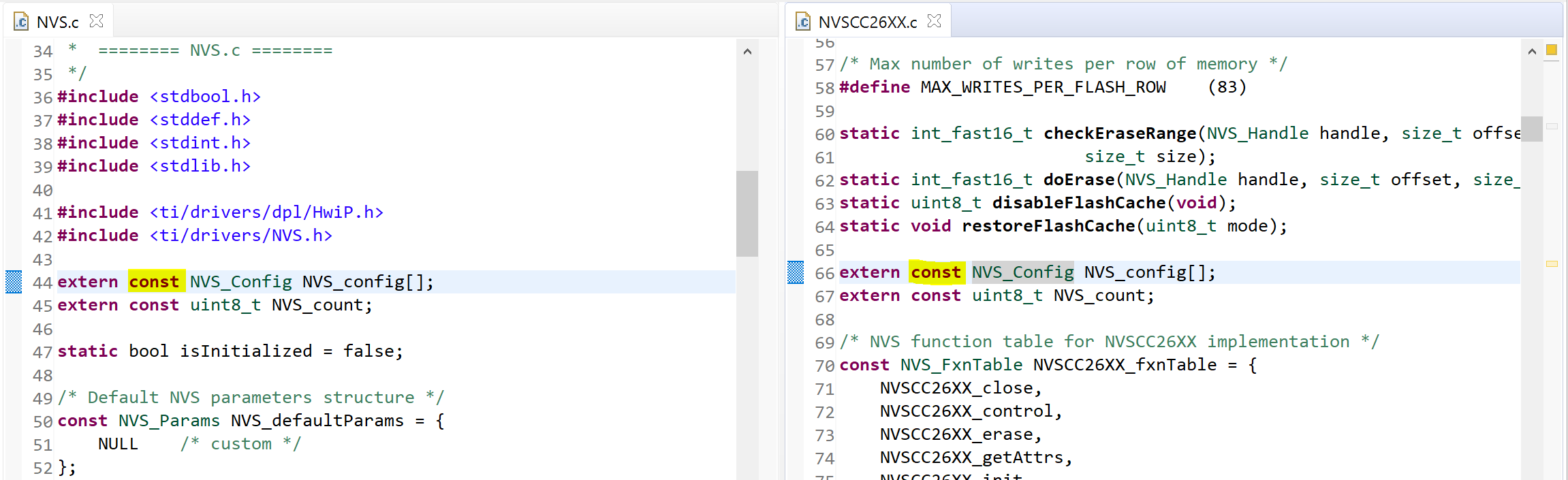

  • Hi Erik
    We are getting compilation errors as shown above when we try to compile by your suggested methodology.
    Could you or Stuart do the required and see if you are getting the same results as we are getting?
    I also do not see your response to Stuarts comment,
    "This is not a sysconfig project. I don't know what you mean by BLE SNV and 15.4 using different memory pages, could you explain?"
  • Virendra,
    I have identified the source of the build failure. Please add a const qualifier to the NVS_config[] prototype near the top of NVS.c and NVSCC26XX.c:
    Stuart

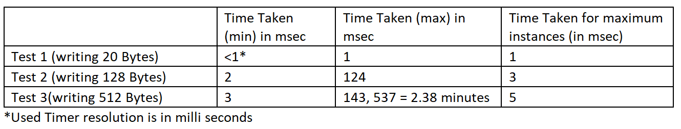

  • Hi Stuart,
    I have done the following 2 experiments as suggested:
    1. Fixed the compilation issue with your resolution, added print at the semaphore under NVSCC26XX.c file. This is with my working code directory.
    2. Took TI base code(release code for sensor on 25th March) and did the same activity(writing into PDM) as we are doing in our application.
    RESULT:
    Experiment 1 - The logs get stuck at similar writes as mentioned in our earlier sessions at somewhere 28th, 52nd, 83rd write and so on. It takes minutes to recover once the logs are stuck. And after that a few more writes and then it is stuck again. And this phenomena keeps repeating. I was unable to furnish the logs as they are getting stuck.
    Experiment 2 - The issue is easily reproduced even with TI base code(sensor release code as of 25th March, 2020). I am attaching the screen capture of the code snippet.

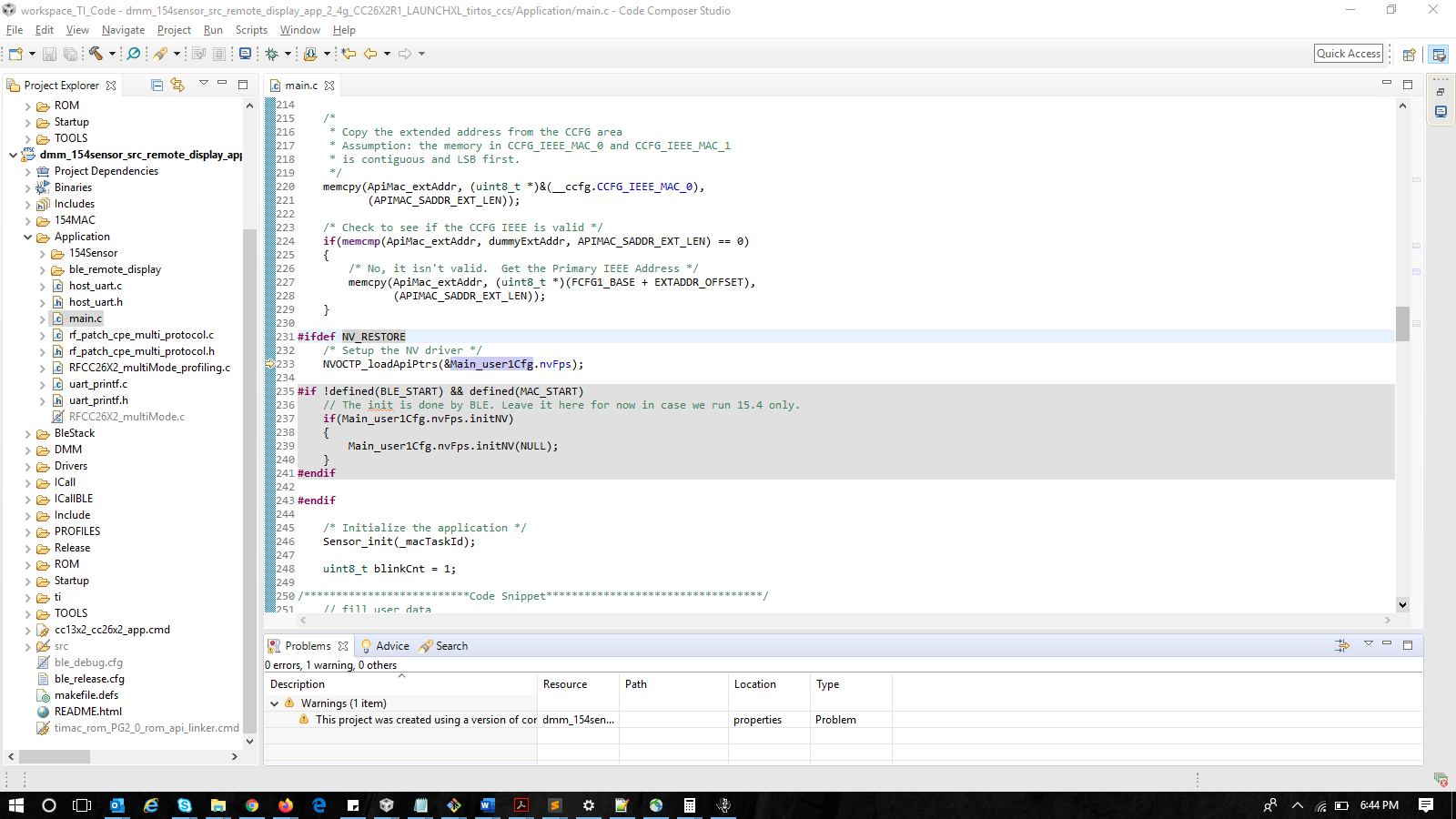

    Adding stub code for easier reference:
    //stub code
    #include <xdc/runtime/Timestamp.h>
    #define USER_DATA_SIZE 512
    #define NVS_WRITE_ITERATION 1000
    /* NV Item ID - User Data information */
    #define SSF_NV_USER_DATA 0x0009
    uint8_t NVS_wrArray[USER_DATA_SIZE];
    /* code snippet to save user data to NVS region*/
    void NVS_DataWrite(void)
    NVINTF_itemID_t id;
    uint8_t nvData[USER_DATA_SIZE];
    /* Setup NV ID */
    id.systemID = NVINTF_SYSID_APP;
    id.itemID = SSF_NV_USER_DATA;
    id.subID = 0;
    // make a local copy of the global data array
    memcpy(&nvData[0], &NVS_wrArray[0], USER_DATA_SIZE);
    /* Read Network Information from NV */
    if ((Main_user1Cfg.nvFps.writeItem != NULL) && (nvData != NULL))
    if (Main_user1Cfg.nvFps.writeItem(id, USER_DATA_SIZE, nvData) != NVINTF_SUCCESS)
    vDebugRTF("\nNVS_ERR\n");
    /**************************Code Snippet**********************************/
    // fill user data
    memset(&NVS_wrArray[0], 0xAF, sizeof(NVS_wrArray));
    // write into NV region
    for (i = 0; i<NVS_WRITE_ITERATION; i++)
    time1 = 0;
    time2 = 0;
    vDebugRTF("\n[i]: ");
    vDebugHexRTF(i, 2);
    time1 = Timestamp_get32();
    NVS_DataWrite();
    time2 = Timestamp_get32();
    vDebugRTF("\nTm_msec:");
    vDebugHexRTF(((time2-time1)/62.5), 8);

  • In addition to above I am still waiting your response to Stuarts comment,

  • I have also test NVS-Read times. In my program, 3-page(24K Byte) is set.
    In zigbee application, NV-item "ZCD_NV_NWK_ACTIVE_KEY_INFO" is read frequently when zigbee transmiting. The latency of reading this NV-item can increase to 5 or 6 millisecond. But after restart system, the  latency can reduce to 1 ~ 2 millisecond.
  • Aries,
    If you read the nvoctp.c doxygen it states that "Obsolete items marked accordingly but a search for the newest instance of an item is sped up by starting the search at the last entry in the page (higher memory address)". I would expect that older entries takes longer to find as more items are added to nv storage and the list that needs to be traversed grows.
    Virendra Rathore,
    I was not aware that this use the nvoctp (2 page nv implementation, part of stack). The 2 page region is defined by default in the board file (CC26X2R1_LAUNCHXL.c). Seems like this is shared.

  • Hello Aftab Ali,
    1)
    I see now that this use the nvoctp (NV driver for CC26x2 devices - On-Chip Two-Page Flash Memory). These files are added to the project by default and you can debug within nvoctp.c. But The following limitations apply to those using NV alongside the BLE5-Stack.
    • NV inmplementations (i.e. NVOCTP) must not be used directly, instead the application should access NV through OSAL SNV. See Using SNV Example Code
    file:///C:/ti/simplelink_cc13x2_26x2_sdk_3_10_00_53/docs/ble5stack/ble_user_guide/html/ble-stack-common/flash_memory-cc13x2_26x2.html?highlight=nvoctp#limitations-and-intended-use
    2)
    In simplelink_cc13x2_26x2_sdk_3_10_00_53 there seems to be 2 different implementations for ble5stackstack and ti154stack:
    C:\ti\simplelink_cc13x2_26x2_sdk_3_10_00_53\source\ti\ti154stack\source\common\nv
    C:\ti\simplelink_cc13x2_26x2_sdk_3_10_00_53\source\ti\ble5stack\services\src\nv\cc26xx
    This is consolidated in later releases also with the addition of nvocmp (On-Chip Multi-Page Flash Memory).:
    C:\ti\simplelink_cc13x2_26x2_sdk_4_10_00_78\source\ti\common\nv
    There seems to be many fixes that could be relevant. Even though the tips in 1) still apply (use OSAL SNV) you can try to use the latest  version of the driver.

  • Hello ,
    How do you define and configure Main_user1Cfg in your test code?
  • Hi Erik,
    please refer the snapshot:
    Erik, please assure that using NV through OSAL SNV and using the latest release will solve the issue.
  • The root cause of this issue has been identified as a known bug in an older version of nvoctp.c. An updated version exists in the 3.10 SDK under:
    source/ti/ti154stack/source/common/nv/nvoctp.c
    The older project local version of this file was replaced resolving the issue.
    Stuart
