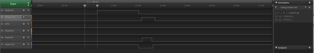

I saw that compared to your last SDKs, there is a big delay of 0.5 mSec from calling to post command (RF_postCmd) until the rising of the PA.
I used GPIO to measure it and it was rised right before the calling to RF_postCmd.
In the post command I sending a Tx structure, rfc_CMD_IEEE_TX_t  which chained to Rx structure of type rfc_CMD_IEEE_RX_t.
It chained by pNextOp.
In the attached logic print you can see the device that sent a message and received ACK from the central unit.
There is 0.51 mSec from the GPIO rise until the PA rise.
Please advise in advanced.

  • Hi Ammar,
    We're not using TI's stack but we use your 802.15.4  APIs like  rfc_CMD_IEEE_TX_t  and rfc_CMD_IEEE_RX_t.
    Dekel
  • Hi Dekel,
    Could you share how you test this? Depending on how the setup is setup you could have quicker or slower "post-to-run" time depending on if the RF Core is powered up already and if the driver needs to configure and patch the radio prior to sending out your command.
    I attached my RF settings files which based on smart RF studio.
    The RX was switched off on sending the post command of the transmission.
    The GPIO was set right before calling the post command and I measured the gap between this GPIO rise and the PA rise.
    The Tx command is chained to a Rx command by pNextOp.

  • Hi Dekel,
    I would have expected a "RF_Mode" struct (passing into the RF_open() API), is this defined somewhere else in your application?
    There is a few things to consider in this case. First of is the CC1352P really assumes the radio to be patched in order for the PA switching to work as expected. The presence of a patch will add to the radio "wake-up" time, I would say 150-200 us would be a reasonable headroom number for this patch to be performed. The patch time could be quicker in case the radio was already patched once before (as there is some level of retention in the radio RAM) but for now we assume a "cold boot" of the radio.
    Coming from a cold boot, there is a few things that would need to happen before the radio is ready to TX:
    1) The driver would need to turn on and swtich to XOSC HF as it is typically not in use when the radio is of (to save power). This is to some degree able to run in parallel but it is still some processing time needed.
    2) The radio need to be booted up and configured. This would include the patching etc.
    Assume 1 and 2 could be done in parallel and the processing time is "small", we could choose to count with patch time only: ~150 us.
    3) The driver would need to run the "Setup" and "FS" command to get the radio properly running before TX. This would add additional time to the "responds" where the FS is likely the largest portion of this as the synthesizer would need lock. Just a ball park number here, 100-150 us might be a good number.
    A thing you could do here is to also route out the "Calibration done" radio signal to a IO and observe this alongside the other IOs. This will show you the delay from "post" to "calibration done" to "PA enable". It should help give a better picture of where most of the delay is located.
    Assume we now have at least 300 us worth of processing done and now are ready to start the TX, there is internal processing delays related to setting up and priming TX buffers etc etc. Accounting for a 90-100 us delay here.
    We are now at ~400 us (based on the assumptions above). This is not considering any of the processing delays in the device (interrupts that need to bounce back and forth between the CM4 and the Radio Core, the RD driver state machine etc etc) which could quickly add up to a few us worth of "delay" as well.
    To boil everything down, ~500us is not an unreasonable number assuming the radio is booted up from complete shutdown. I would assume the number to be smaller if you ran the exact same command again without turning of the radio or going into standby (as the radio should be up and running already).
    Could you test this in addition to routing out the calibration signal (CPE_GPO2) and observing this?
    https://dev.ti.com/tirex/explore/node?a=pTTHBmu__3.20.00.68&node=AOFmdaK8impnxmEqGU3jkg__pTTHBmu__LATEST
