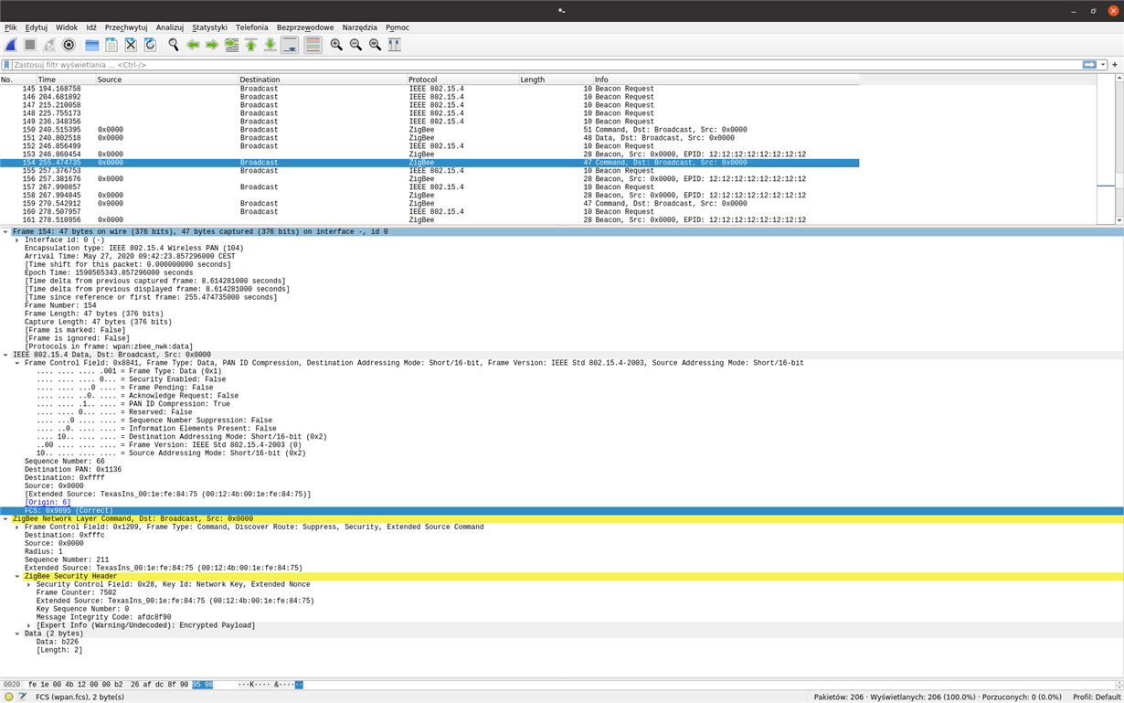

Make sure that the ZC shows the same PAN ID when it comes back online. Does the ZC respond to the ZED's Beacon Request (after entering an orphan state) and Network Rejoin (if one is provided)? Please provide the full sniffer log if possible.

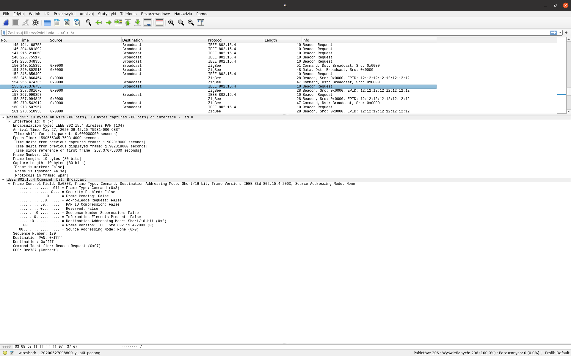

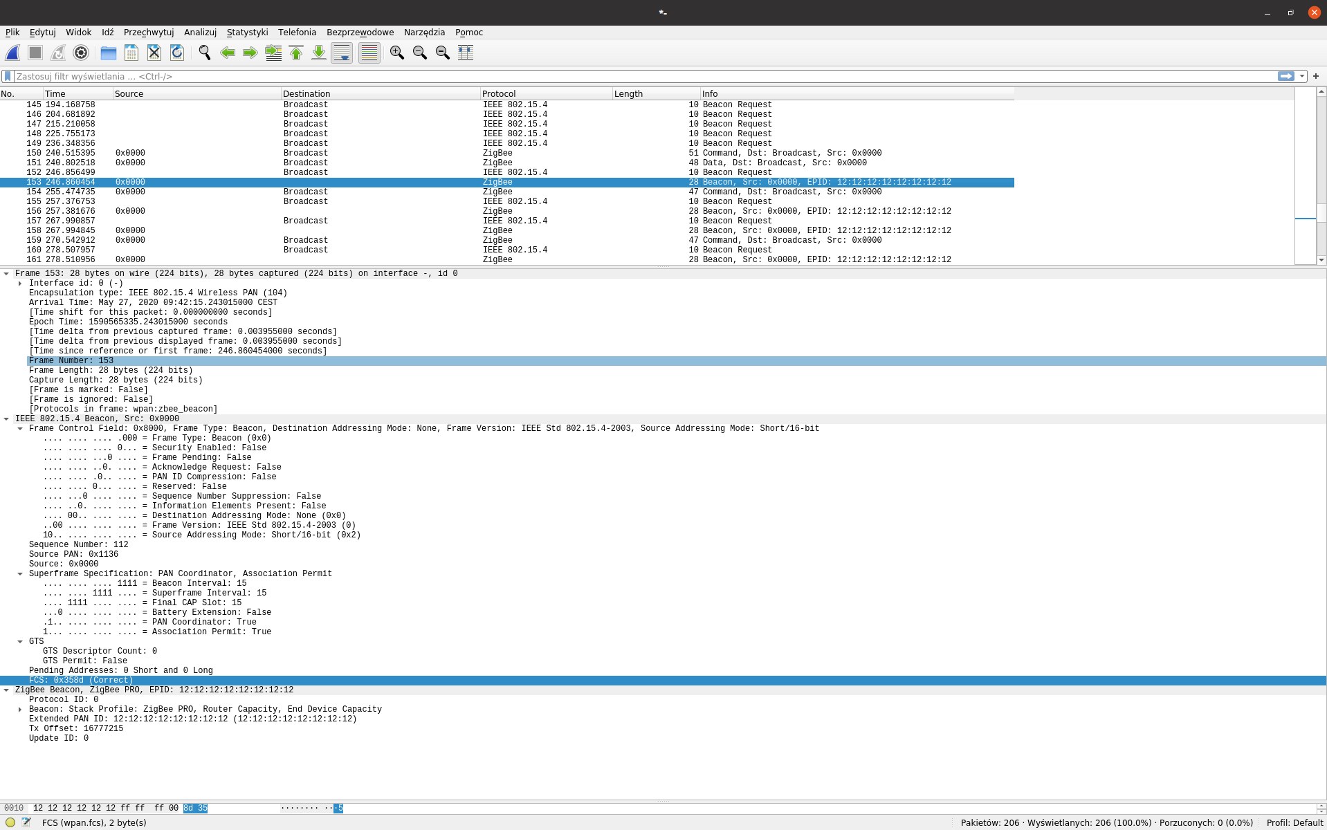

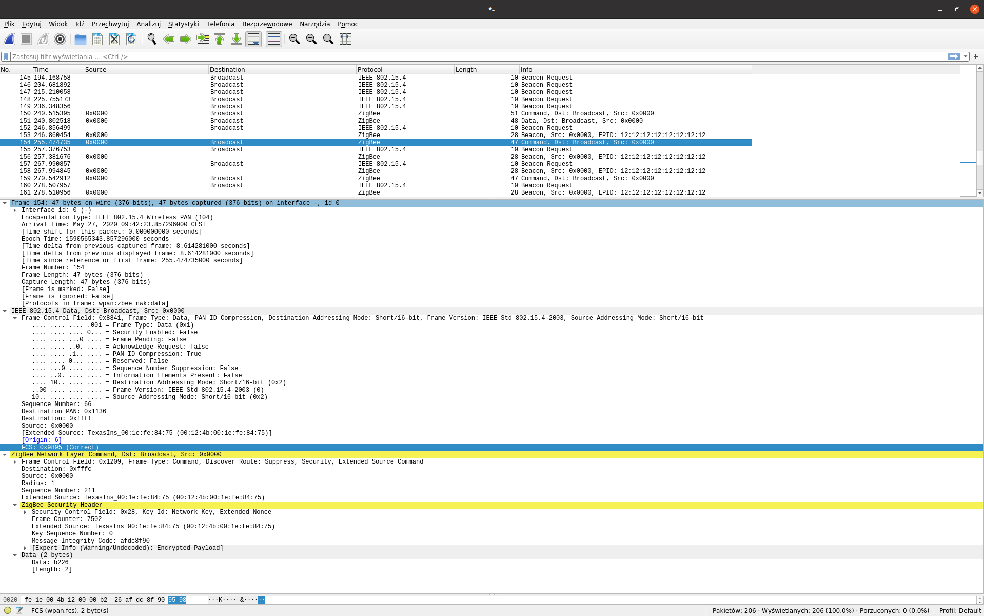

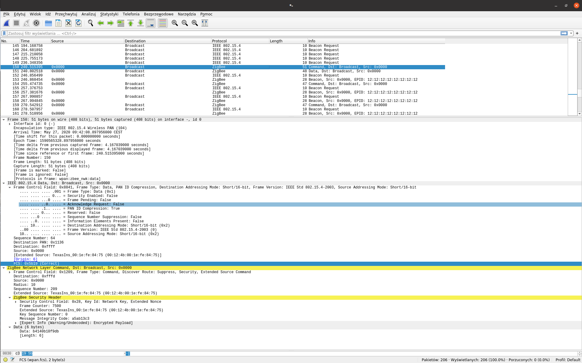

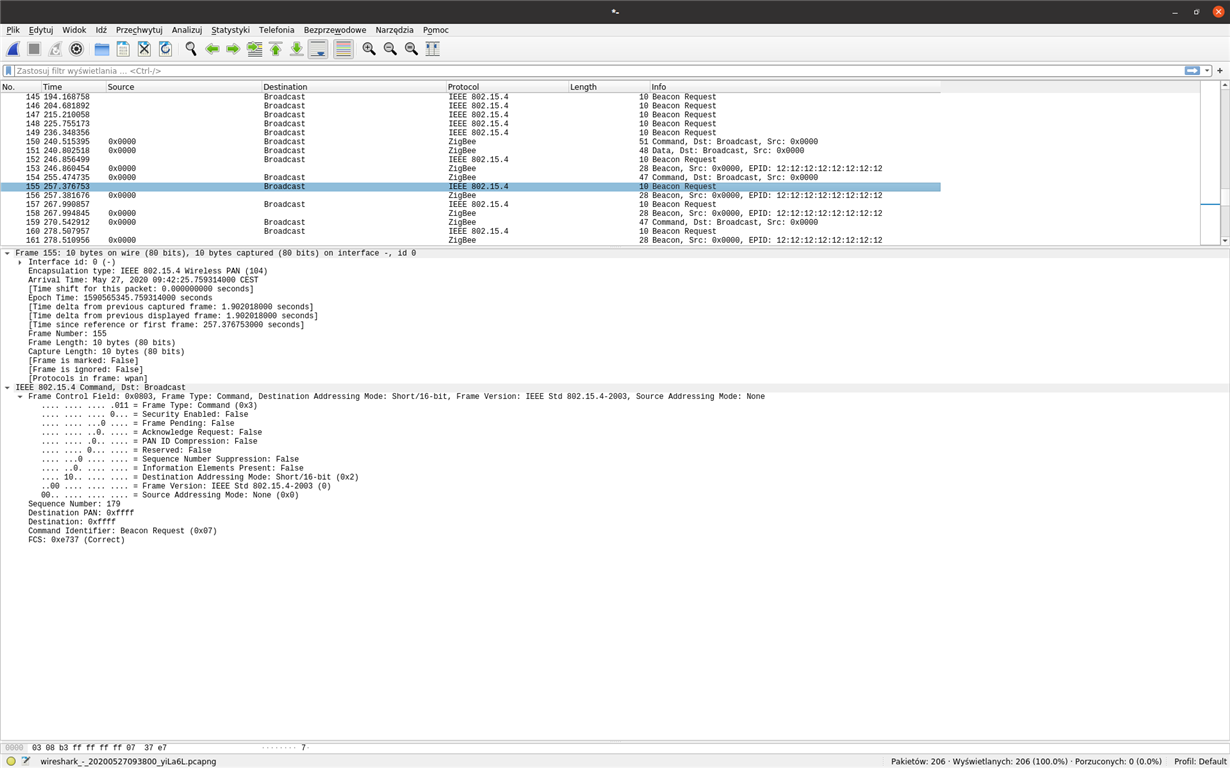

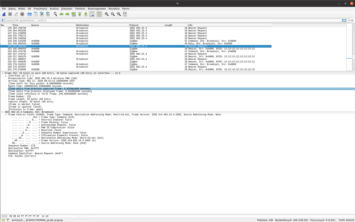

Here is my full sniffer log. In text file, and on the screenshots. I can see that i got some Beacon response from the ZC but this is all. I also tried to use ext pan id but it didn't change anything.
Hi Arkadiusz,
Thanks for providing what we asked for. Based on the sniffer log, this appears to be an issue with the ZED as it does not send a Rejoin Request after getting a Beacon Response from the ZC. Are you using a TI-provided example (clarify which) and what modifications have been made? It appears that a ZR is not required to replicate the issue but this is not expected behavior from typical Z-Stack 3.0.2 operation. If you can debug the ZED please try to determine if bdb_rejoinNwk is entered inside ZDApp.c and why ZSuccess is not returned.
Ryan
Thanks Ryan! It works. That was what i was looking for. I didn't know where to start debugg... The problem was that i modified part of logic that was responible for the buttons/interrupts and There is a code that restores network parameters. It was triggered all the time. Now everything works perfect. Thanks!
