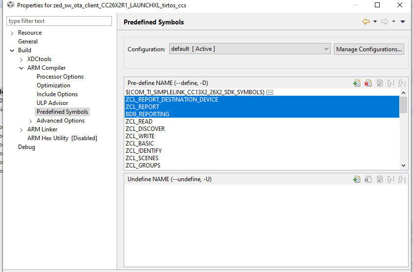

Hi TI Team,
Previously we did not encounter any problem when we used zed switch (non-ota) where coordinator send report data to ZED upon commissioning.
We want to expand our ZED devices with FOTA using sdk 310.
Note: we reset first, and load the BIM using uniflash also and FOTA operation can work..
Here is basic config as below using  zed switch-ota :

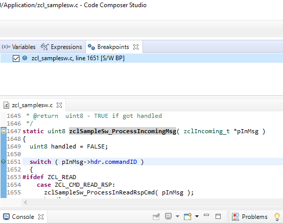

But when I just run debug and put breakpoint in zclSampleSw_ProcessInReportCmd function, but the breakpoint is not kicking in.
1. Did we miss anything in configuration of sample code with FOTA?

  • Hi TI Team,
    I used the zed switch non-ota with exactly the same basic modification as zed switch with ota sample code.
    When I just run debug and put breakpoint in zclSampleSw_ProcessInReportCmd function, the breakpoint is kicking in.
    It seems an SDK issue please confirm.
    Also, please note that the issue is only incoming message. Sending outgoing message can send successfully.
    Walter

  • Hi Walter,
    Are you able to break inside zclParseInReportCmd or zclSampleSw_ProcessIncomingMsg for an attribute report?  Have you compared the zcl_samplesw[_data].c/.h files for any differences?  Is the issue replicable with the v4.10 SDK?
    Ryan
  • Hi Ryan,
    We compared no difference zcl_samplesw[_data].c/.h  between the sample code with ota and with no-ota.
    Also, cannot break inside zclSampleSw_ProcessIncomingMsg.This problem in zed switch ota we saw in sDK3.10 and SDK3.20. No problem in sample switch(non-ota) in  in sDK3.10.
    For latest SDK I will try and let you know.
    Can anyone confirm this problem in zed switch ota sample code?
    Walter
  • Hi Ryan,
    I used the sdk310/3.20, it can break in zclParseInReportCmd in zcl.c but not in zclSampleSw_ProcessIncomingMsg.
    Please give us idea how to resolve.
    Walter
  • Hi Walter,
    Thank you for bringing this to our attention.  Using OTAClient_SetEndpoint(SAMPLESW_ENDPOINT); calls zclport_registerZclHandleExternal(OTA_ProcessUnhandledFoundationZCLMsgs); which overwrites zclport_registerZclHandleExternal(zclSampleSw_ProcessIncomingMsg);.  Currently, Z-Stack applications only register one function to zcl_HandleExternal and therefore only a single callback can handle ZCL messages.  This appears problematic when attempting to have 2 or more endpoints coexist, such as OTA alongside an application.  All SDK versions are affected by this issue.  I will work with the Software Development Team to resolve the issue and provide a workaround as soon as possible.
    Ryan

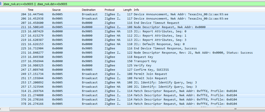

  • Hi Aries/Ryan,
    After adding Aries solution FOTA is working but, I noticed that the commissioning not completing properly.
    We are using smart switch_ota sample code in SDK 3.10.
    Please take a look at the sniffer log.
    https://e2e.ti.com/cfs-file/__key/communityserver-discussions-components-files/158/snifferlog-cannot-complete-commisoning-0x9005.7z
    Walter
  • Hi Walter,
    I assume the PAN ID in question is 0x7E91?  Device short address 0x9005 joins correctly and starts sending regular data requests so can you please clarify what else you are expecting to occur?  If the coordinator is to take further F&B action then please ensure that it has this feature enabled during this time.
    Ryan
  • Hi Ryan,
    My original implementation like this, using non-fota code like this. After node descriptor request/response it can join completely:
     FOTA switch sample code.
    The device in question is 0x9005. After node descriptor request/response it cannot join completely:
    and, Why device sending too many match descriptor request. Is it correct?
  • Hi Walter,
    The ZED joins the network successfully but does not complete binding.  The ZC parent does not respond to Identify Requests, which is why I suggested that you enable F&B mode in the previous reply.  Therefore the ZED never sends a Node Descriptor Request from which to form a bind and start sending attribute reports.  As for the Match Descriptor Requests, this is from ZCL_OTA_SEND_MATCH_DESCRIPTOR_EVT in order to discover the OTA server, which the ZC is also not responding to.  So you would need to further investigate your ZC OTA server solution.
    Note: The newest SIMPLELINK-CC13X2-26X2-SDK version includes several improvements to the OTA solution and I highly implore you to migrate accordingly.
    Ryan
