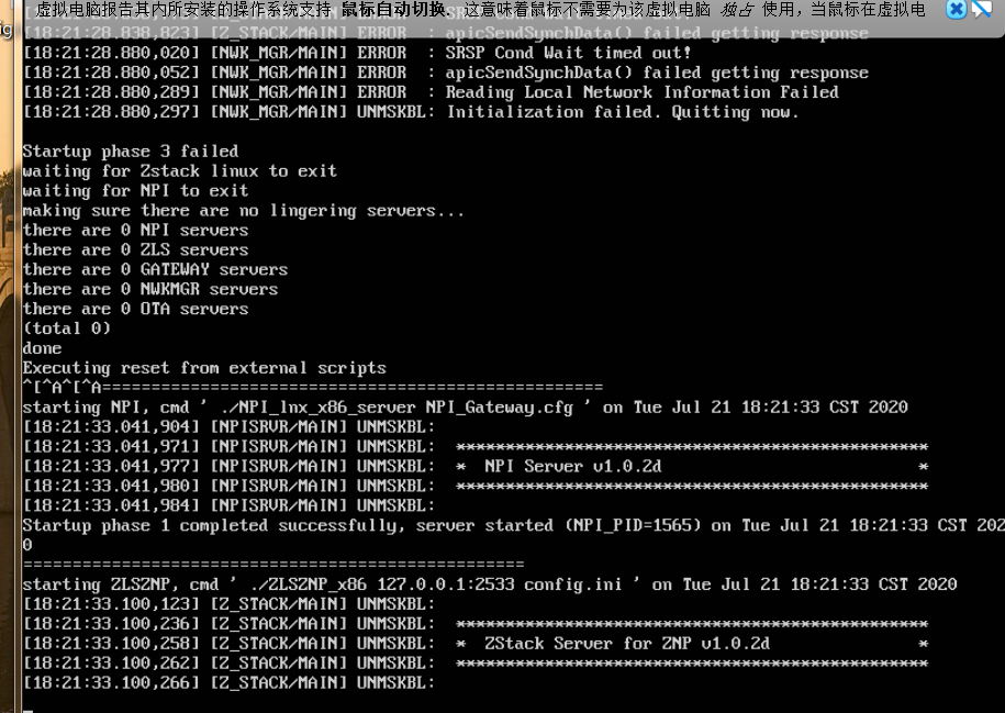

according to zigbee linux quick start PDF,I had encounter problem.
I had no TI Cortex-A8 board,in my ubuntu16.04, building it.
has this picture error,
I want to know that I had a 2652 demo board, How can I keep run according to zigbee linux quick start PDF.
Thanks!

  • It seems that you don’t build everything successfully. Try to follow the steps in section 5.2 of user guide at
  • Yes, TARGET_PLATFORM="x86".  And you do not need to have the LAUNCHXL-CC26X2R1 connected during this stage of the gateway build process.
    Ryan

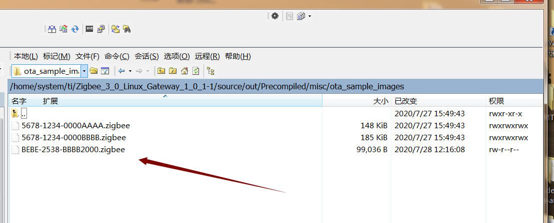

  • I don't think it's feasible to use terminal tool such as SecureCRT to do OTA.
  • Hi YiKai Chen
    Z-Stack_Linux_Gateway-1_0_1-src-linux-installer.run and Zigbee_3_0_Linux_Gateway_1_0_1.run has any difference?
    I found that it said about the open source code is the Z-Stack_Linux_Gateway-1_0_1-src-linux-installer.run.
    I should use this[Z-Stack_Linux_Gateway-1_0_1-src-linux-installer.run]?

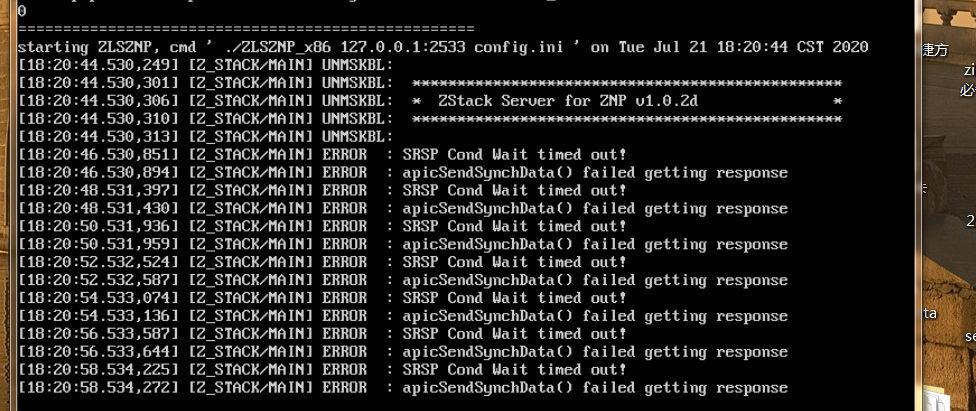

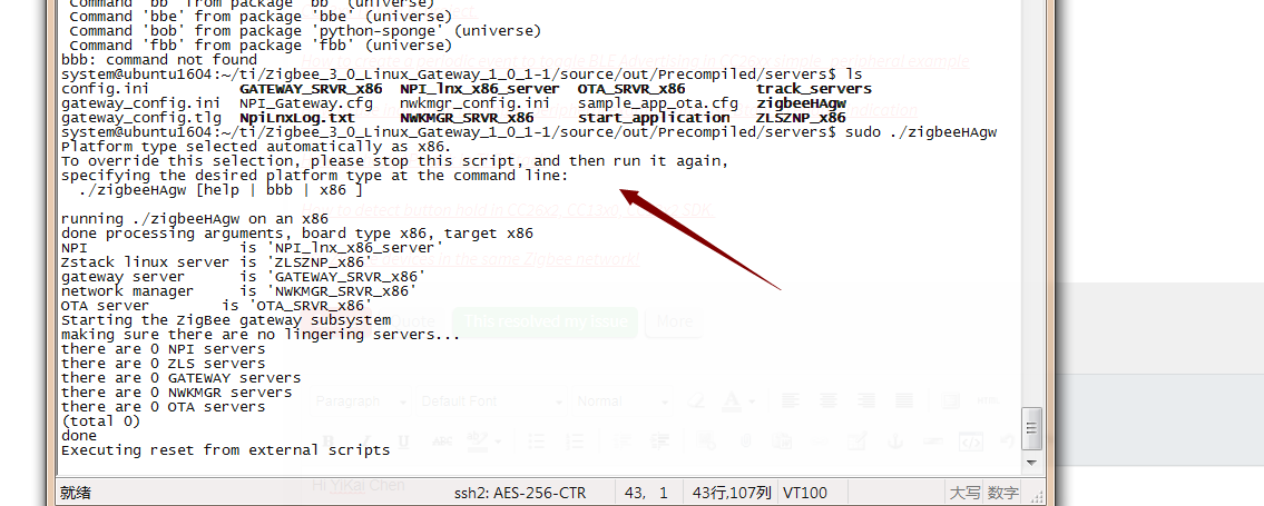

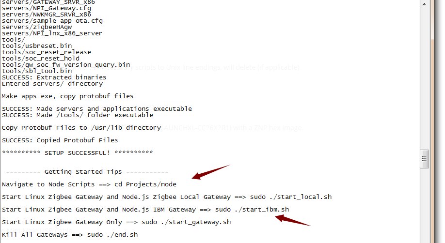

  • Hi YiKai Chen
    Why had  the second picture.
    I had build successfully and connect the 2652 demo board,and load firmware with the ZNP.hex
    Thanks!
  • This is for node.js to setup http Web UI of Zigbee Gateway and send messages to IBM cloud. If you don't need them, you can run ./start_gateway.sh and skip those two.

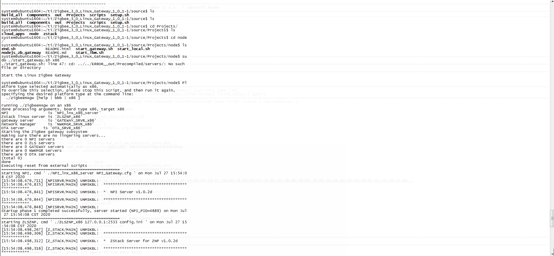

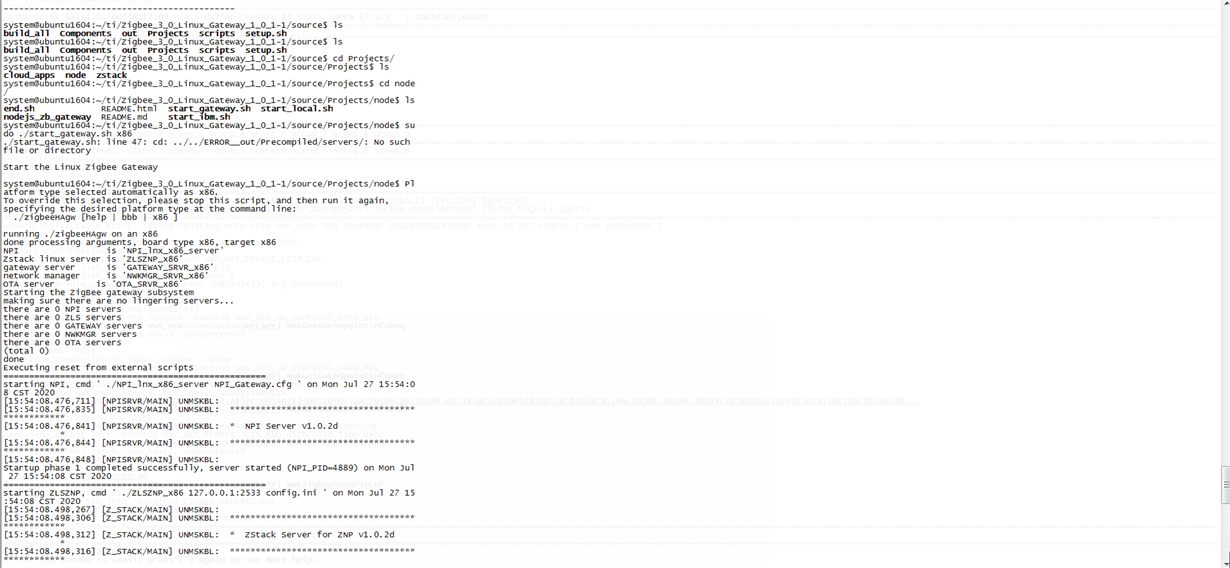

  • Hi YiKai Chen
    I mean that I had build the SDK successfully, and run the script[sudo ./zigbeeHAgw] ,it appeared this:
    this mean that I should run on x86 chip?  I heard my friend run the zigbee linux gateway on the ubuntu,and connect the 2538/2652 demo board,can run.
    So I had to try it.
    Thanks!
  • You can try "./zigbeeHAgw bbb"

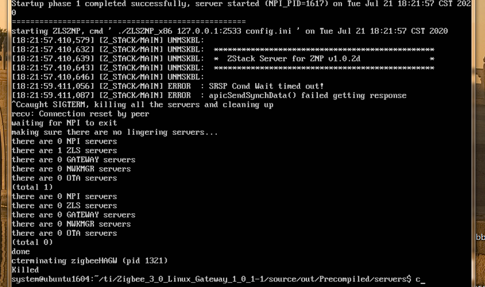

  • Hi YiKai Chen
    I had enabled the  serial port into the ubuntu1604.
    But the name is not /dev/ttyACM0.the name is /dev/ttyUSB0.
    so I modify the zigbeeHAgw script,[set ff=unix, chmod 777 xxx]
    but seem that had no run entirely.
    Thanks!
  • It seems that your ZNP doesn’t respond. What’s your ZNP and are you sure you connect it to serial-to-USB converter well?

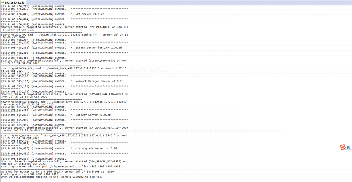

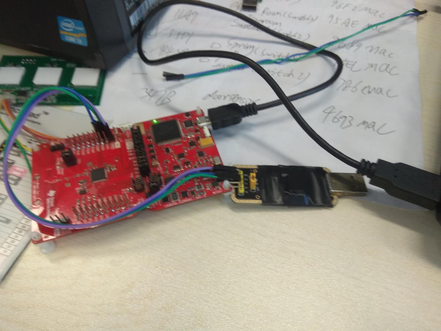

  • Hi YiKai Chen
    I used the CC2652 demo bard,as the picture 1 show,and the USB cable driver is added into the ubuntu16.04.
    And can check the /dev/ttyACM0 driver exist.
    excute the shell command:sudo ./zigbeeHAgw.sh x86,show that run it successfully.
    Thanks!
  • Cool and It's good to know it works now.

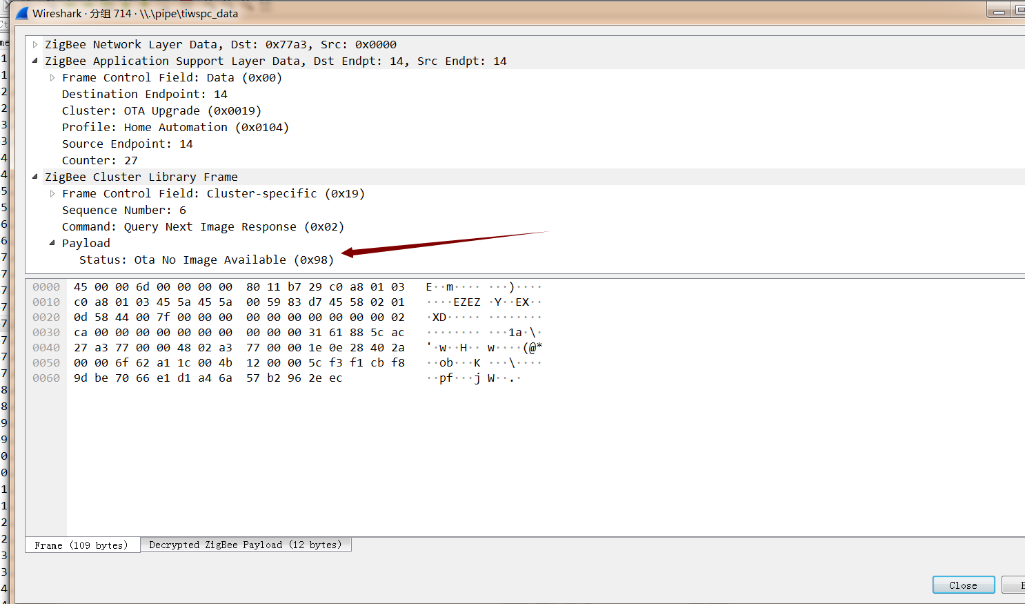

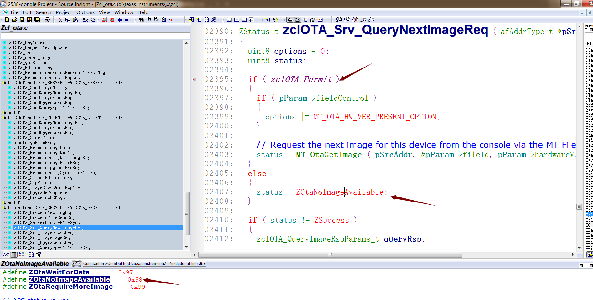

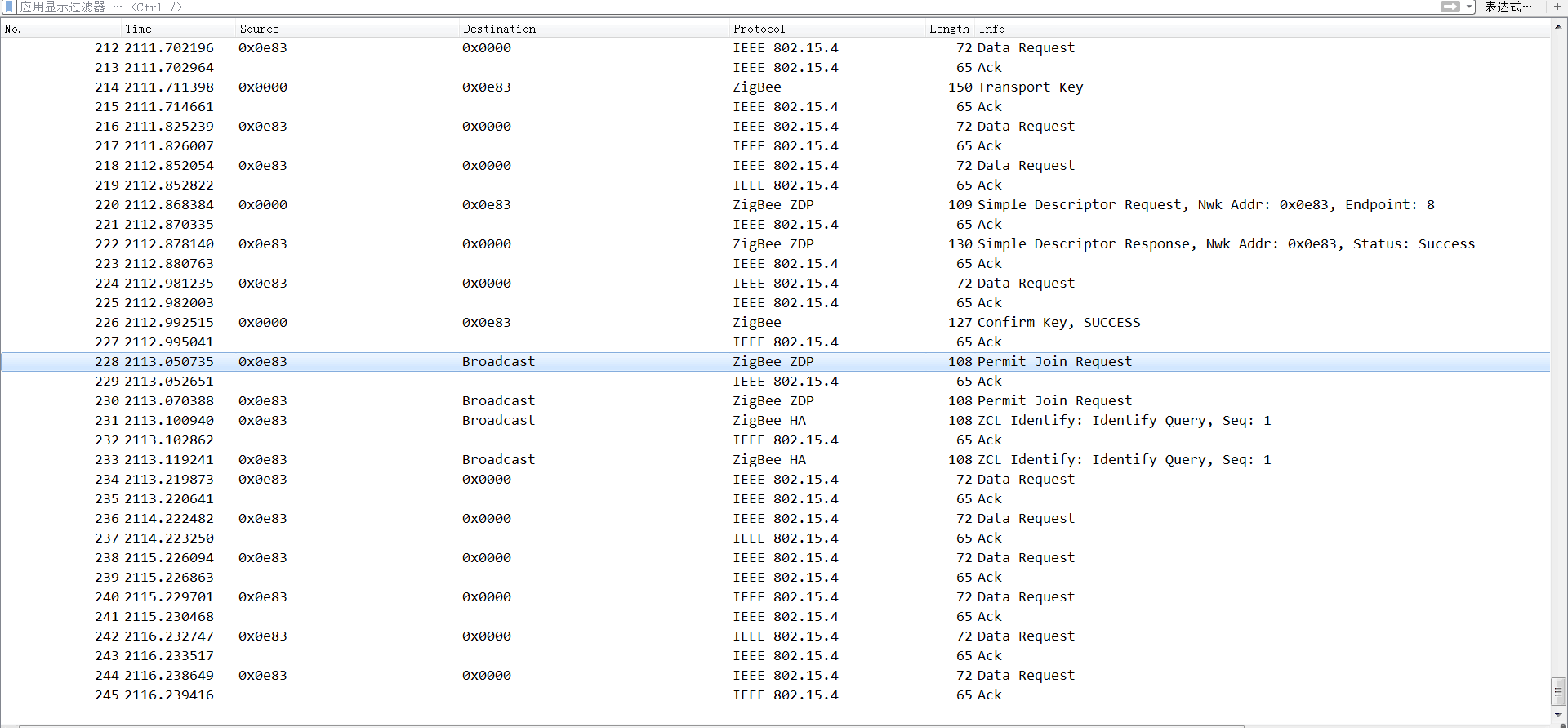

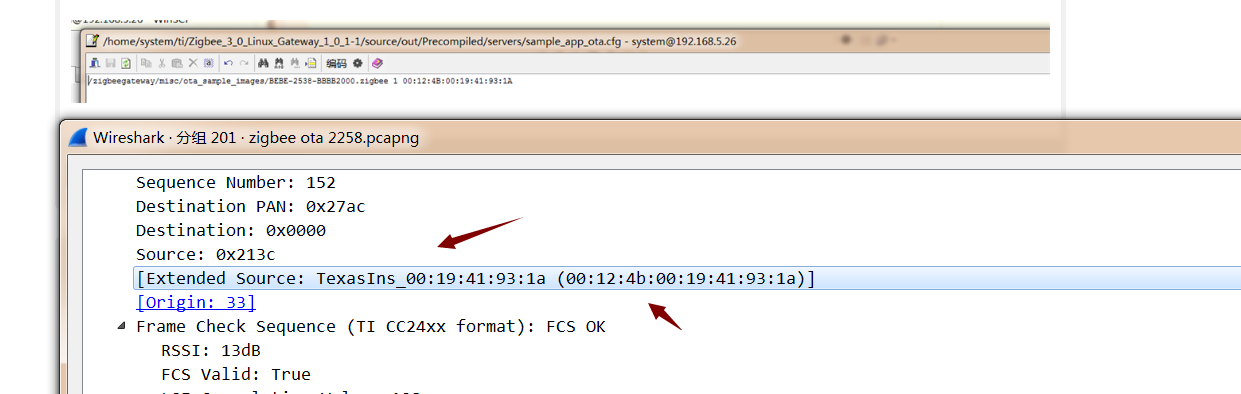

    I had run it successfully,but I let 2538 run end device code,on the same channel 13(zigbee linux gateway default 13),the result see the picture,
    can not pair.
    Thanks!
  • Cannot pair? Do you use sniffer to check what happens over the air?

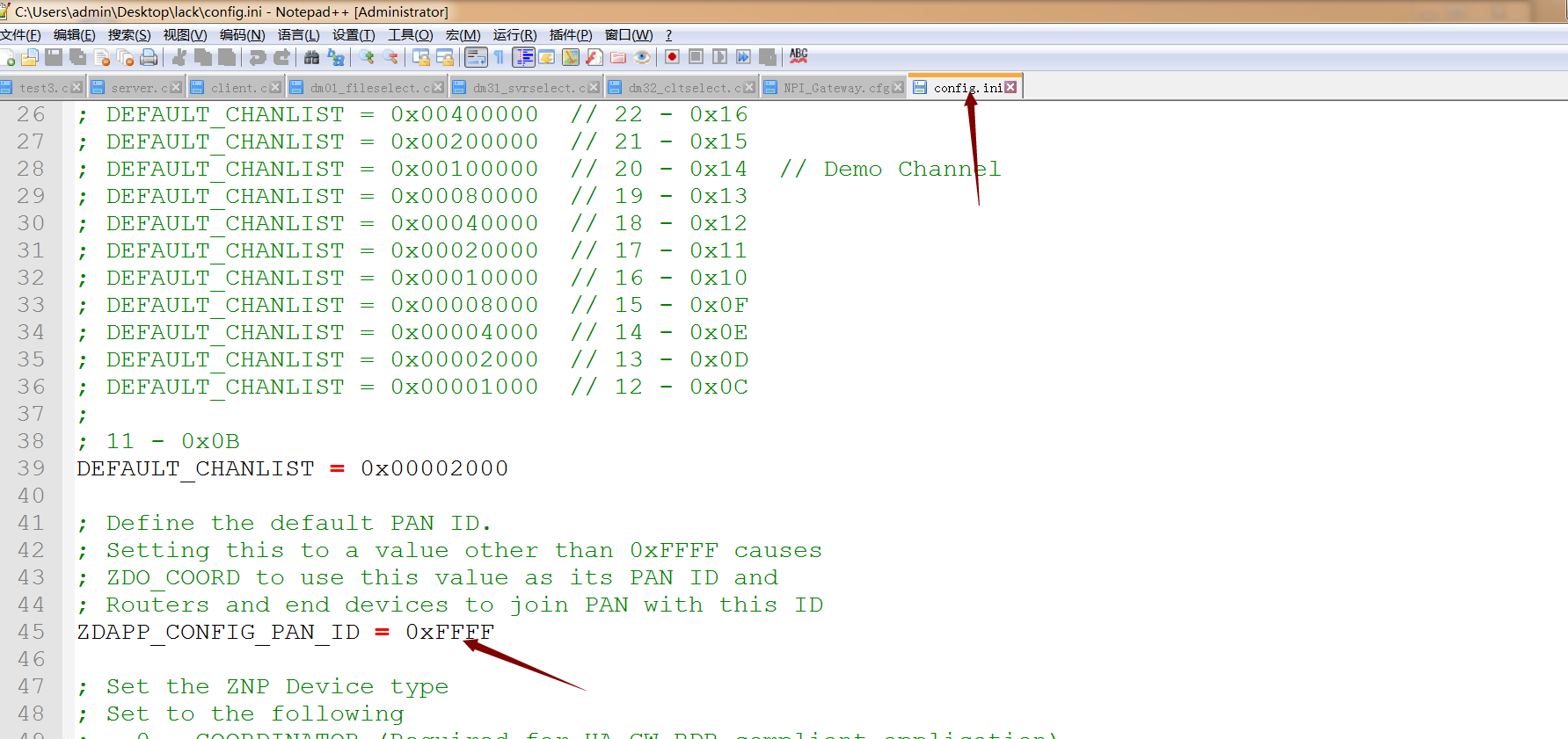

  • has no any chanage these parameter. it seem that it has no open network,But I seen the network times 60 seconds go on from the SecureCRT.
  • According to your sniffer log, your coordinator doesn't enable permit join for device to join.
  • Hi YiKai Chen
    yes,I had check the log,
    But I had seen the SecureCRT the Network time 60 s is going on,60,59,58.....0.
    Oh,What is the matter for this problem?
    Thanks!
  • You might need to debug into ZNP to know the reason.

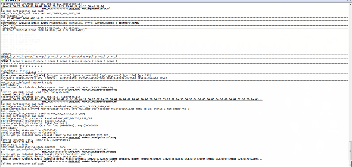

    ok,it seem that it can pair,I just re-run the environment.
    I try more times again.
    Thanks!
  • So, it works without problem now, right?

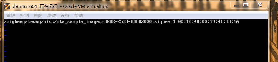

  • Hi YiKai Chen

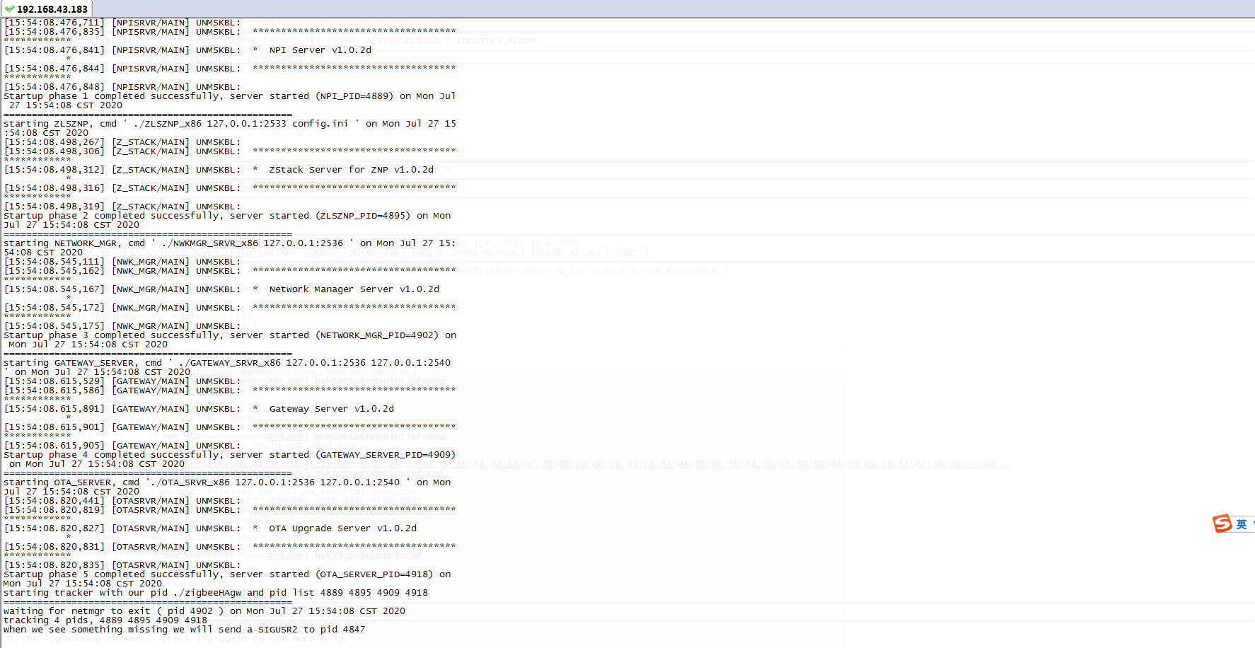

    yes,now my environment on ubuntu16.04,and send a commond to CC2652 demo board,CC2538 as a end device,
    excute the Z-Stack Linux Gateway - Quick Start Guide command,
    can let it pair,next step I will use this to excute zigbee ota and add this into MT7688.
    Thanks!
  • Hi YiKai Chen
    the zibgee linux gateway seem that it no-normal run on ubuntu1604.
    sometimes it can,I want to test the zigbee ota end device.this is the log.
    starting ZLSZNP, cmd ' ./ZLSZNP_x86 127.0.0.1:2533 config.ini ' on Fri Jul 24 15:30:15 CST 2020

    starting NPI, cmd ' ./NPI_lnx_x86_server NPI_Gateway.cfg ' on Fri Jul 24 15:30:24 CST 2020
    tee: /tmp/GW_SRVRS.out: Permission denied
    [15:30:24.548,571] [NPISRVR/MAIN] UNMSKBL:
    [15:30:24.548,615] [NPISRVR/MAIN] UNMSKBL:  ************************************************
    [15:30:24.548,620] [NPISRVR/MAIN] UNMSKBL:  *  NPI Server v1.0.2d                          *
    [15:30:24.548,624] [NPISRVR/MAIN] UNMSKBL:  ************************************************
    [15:30:24.548,627] [NPISRVR/MAIN] UNMSKBL:
    Startup phase 1 completed successfully, server started (NPI_PID=11561) on Fri Jul 24 15:30:24 CST 2020
    starting ZLSZNP, cmd ' ./ZLSZNP_x86 127.0.0.1:2533 config.ini ' on Fri Jul 24 15:30:24 CST 2020
    tee: open: Permission denied
    [15:30:24.571,386] [Z_STACK/MAIN] UNMSKBL:
    [15:30:24.571,440] [Z_STACK/MAIN] UNMSKBL:  ************************************************
    [15:30:24.571,445] [Z_STACK/MAIN] UNMSKBL:  *  ZStack Server for ZNP v1.0.2d               *
    [15:30:24.571,449] [Z_STACK/MAIN] UNMSKBL:  ************************************************
    [15:30:24.571,452] [Z_STACK/MAIN] UNMSKBL:
    Startup phase 2 completed successfully, server started (ZLSZNP_PID=11567) on Fri Jul 24 15:30:24 CST 2020
    starting NETWORK_MGR, cmd ' ./NWKMGR_SRVR_x86 127.0.0.1:2536 ' on Fri Jul 24 15:30:24 CST 2020
    [15:30:24.659,687] [NWK_MGR/MAIN] UNMSKBL:
    [15:30:24.659,878] [NWK_MGR/MAIN] UNMSKBL:  ************************************************
    [15:30:24.659,883] [NWK_MGR/MAIN] UNMSKBL:  *  Network Manager Server v1.0.2d              *
    [15:30:24.659,887] [NWK_MGR/MAIN] UNMSKBL:  ************************************************
    [15:30:24.659,890] [NWK_MGR/MAIN] UNMSKBL:
    [15:30:24.740,405] [NWK_MGR/MAIN] ERROR  : ERROR: signal 11 was trigerred:
    [15:30:24.740,427] [NWK_MGR/MAIN] ERROR  :   Fault address: (nil)
    [15:30:24.740,433] [NWK_MGR/MAIN] ERROR  :   Fault reason: address not mapped to object
    [15:30:24.740,756] [NWK_MGR/MAIN] ERROR  : Stack trace folows (partial):
    ./NWKMGR_SRVR_x86(segmentation_fault_handler+0xad)[0x8081ee3]
    [0xf7765bd0]
    /lib/i386-linux-gnu/libc.so.6(+0x86ef8)[0xf75fcef8]
    ./NWKMGR_SRVR_x86(sdb_consolidate_db+0x33)[0x806cd2f]
    ./NWKMGR_SRVR_x86(nwkMgrDb_Init+0x129)[0x806a009]
    ./NWKMGR_SRVR_x86[0x8062797]
    ./NWKMGR_SRVR_x86(appInitPhase3+0xda)[0x8062488]
    ./NWKMGR_SRVR_x86(main+0x28c)[0x8081d8a]
    /lib/i386-linux-gnu/libc.so.6(__libc_start_main+0xf7)[0xf758e647]
    ./NWKMGR_SRVR_x86[0x805f641]
    [15:30:24.740,998] [NWK_MGR/MAIN] ERROR  : Executing original handler...
    Startup phase 3 failed
    waiting for Zstack linux to exit
    waiting for NPI to exit
    making sure there are no lingering servers...
    there are 0 NPI servers
    there are 0 ZLS servers
    there are 0 GATEWAY servers
    there are 0 NWKMGR servers
    there are 0 OTA servers
    (total 0)
    done
    Executing reset from external scripts
    starting NPI, cmd ' ./NPI_lnx_x86_server NPI_Gateway.cfg ' on Fri Jul 24 15:30:28 CST 2020
    [15:30:28.834,082] [NPISRVR/MAIN] UNMSKBL:
    [15:30:28.834,132] [NPISRVR/MAIN] UNMSKBL:  ************************************************
    [15:30:28.834,137] [NPISRVR/MAIN] UNMSKBL:  *  NPI Server v1.0.2d                          *
    [15:30:28.834,141] [NPISRVR/MAIN] UNMSKBL:  ************************************************
    [15:30:28.834,144] [NPISRVR/MAIN] UNMSKBL:
    Startup phase 1 completed successfully, server started (NPI_PID=11613) on Fri Jul 24 15:30:28 CST 2020
    starting ZLSZNP, cmd ' ./ZLSZNP_x86 127.0.0.1:2533 config.ini ' on Fri Jul 24 15:30:28 CST 2020
    [15:30:28.855,199] [Z_STACK/MAIN] UNMSKBL:
    [15:30:28.855,267] [Z_STACK/MAIN] UNMSKBL:  ************************************************
    [15:30:28.855,273] [Z_STACK/MAIN] UNMSKBL:  *  ZStack Server for ZNP v1.0.2d               *
    [15:30:28.855,277] [Z_STACK/MAIN] UNMSKBL:  ************************************************
    [15:30:28.855,280] [Z_STACK/MAIN] UNMSKBL:
    Startup phase 2 completed successfully, server started (ZLSZNP_PID=11619) on Fri Jul 24 15:30:28 CST 2020
    starting NETWORK_MGR, cmd ' ./NWKMGR_SRVR_x86 127.0.0.1:2536 ' on Fri Jul 24 15:30:28 CST 2020
    [15:30:28.948,121] [NWK_MGR/MAIN] UNMSKBL:
    [15:30:28.948,197] [NWK_MGR/MAIN] UNMSKBL:  ************************************************
    [15:30:28.948,219] [NWK_MGR/MAIN] UNMSKBL:  *  Network Manager Server v1.0.2d              *
    [15:30:28.948,222] [NWK_MGR/MAIN] UNMSKBL:  ************************************************
    [15:30:28.948,226] [NWK_MGR/MAIN] UNMSKBL:
    [15:30:29.028,371] [NWK_MGR/MAIN] ERROR  : ERROR: signal 11 was trigerred:
    [15:30:29.028,396] [NWK_MGR/MAIN] ERROR  :   Fault address: (nil)
    [15:30:29.028,402] [NWK_MGR/MAIN] ERROR  :   Fault reason: address not mapped to object
    [15:30:29.028,605] [NWK_MGR/MAIN] ERROR  : Stack trace folows (partial):
    [0xf7718bd0]
    /lib/i386-linux-gnu/libc.so.6(+0x86ef8)[0xf75afef8]
    /lib/i386-linux-gnu/libc.so.6(__libc_start_main+0xf7)[0xf7541647]
    [15:30:29.028,877] [NWK_MGR/MAIN] ERROR  : Executing original handler...
    (total 0)
    done
    starting NPI, cmd ' ./NPI_lnx_x86_server NPI_Gateway.cfg ' on Fri Jul 24 15:30:33 CST 2020
    [15:30:33.124,507] [NPISRVR/MAIN] UNMSKBL:
    [15:30:33.124,559] [NPISRVR/MAIN] UNMSKBL:  ************************************************
    [15:30:33.124,564] [NPISRVR/MAIN] UNMSKBL:  *  NPI Server v1.0.2d                          *
    [15:30:33.124,568] [NPISRVR/MAIN] UNMSKBL:  ************************************************
    [15:30:33.124,571] [NPISRVR/MAIN] UNMSKBL:
    Startup phase 1 completed successfully, server started (NPI_PID=11665) on Fri Jul 24 15:30:33 CST 2020
    starting ZLSZNP, cmd ' ./ZLSZNP_x86 127.0.0.1:2533 config.ini ' on Fri Jul 24 15:30:33 CST 2020
    [15:30:33.136,302] [Z_STACK/MAIN] UNMSKBL:
    [15:30:33.136,351] [Z_STACK/MAIN] UNMSKBL:  ************************************************
    [15:30:33.136,356] [Z_STACK/MAIN] UNMSKBL:  *  ZStack Server for ZNP v1.0.2d               *
    [15:30:33.136,360] [Z_STACK/MAIN] UNMSKBL:  ************************************************
    [15:30:33.136,364] [Z_STACK/MAIN] UNMSKBL:
    Startup phase 2 completed successfully, server started (ZLSZNP_PID=11671) on Fri Jul 24 15:30:33 CST 2020
    starting NETWORK_MGR, cmd ' ./NWKMGR_SRVR_x86 127.0.0.1:2536 ' on Fri Jul 24 15:30:33 CST 2020
    [15:30:33.228,253] [NWK_MGR/MAIN] UNMSKBL:
    [15:30:33.228,302] [NWK_MGR/MAIN] UNMSKBL:  ************************************************
    [15:30:33.228,307] [NWK_MGR/MAIN] UNMSKBL:  *  Network Manager Server v1.0.2d              *
    [15:30:33.228,311] [NWK_MGR/MAIN] UNMSKBL:  ************************************************
    [15:30:33.228,315] [NWK_MGR/MAIN] UNMSKBL:
    [15:30:33.311,002] [NWK_MGR/MAIN] ERROR  : ERROR: signal 11 was trigerred:
    [15:30:33.311,025] [NWK_MGR/MAIN] ERROR  :   Fault address: (nil)
    [15:30:33.311,030] [NWK_MGR/MAIN] ERROR  :   Fault reason: address not mapped to object
    [15:30:33.311,226] [NWK_MGR/MAIN] ERROR  : Stack trace folows (partial):
    [0xf76dfbd0]
    /lib/i386-linux-gnu/libc.so.6(+0x86ef8)[0xf7576ef8]
    /lib/i386-linux-gnu/libc.so.6(__libc_start_main+0xf7)[0xf7508647]
    [15:30:33.311,465] [NWK_MGR/MAIN] ERROR  : Executing original handler...
    (total 0)
    done
    starting NPI, cmd ' ./NPI_lnx_x86_server NPI_Gateway.cfg ' on Fri Jul 24 15:30:37 CST 2020
    [15:30:37.405,610] [NPISRVR/MAIN] UNMSKBL:
    [15:30:37.405,690] [NPISRVR/MAIN] UNMSKBL:  ************************************************
    [15:30:37.405,695] [NPISRVR/MAIN] UNMSKBL:  *  NPI Server v1.0.2d                          *
    [15:30:37.405,699] [NPISRVR/MAIN] UNMSKBL:  ************************************************
    [15:30:37.405,703] [NPISRVR/MAIN] UNMSKBL:
    Startup phase 1 completed successfully, server started (NPI_PID=11717) on Fri Jul 24 15:30:37 CST 2020
    starting ZLSZNP, cmd ' ./ZLSZNP_x86 127.0.0.1:2533 config.ini ' on Fri Jul 24 15:30:37 CST 2020
    [15:30:37.430,436] [Z_STACK/MAIN] UNMSKBL:
    [15:30:37.430,529] [Z_STACK/MAIN] UNMSKBL:  ************************************************
    [15:30:37.430,534] [Z_STACK/MAIN] UNMSKBL:  *  ZStack Server for ZNP v1.0.2d               *
    [15:30:37.430,538] [Z_STACK/MAIN] UNMSKBL:  ************************************************
    [15:30:37.430,541] [Z_STACK/MAIN] UNMSKBL:
    Startup phase 2 completed successfully, server started (ZLSZNP_PID=11723) on Fri Jul 24 15:30:37 CST 2020
    starting NETWORK_MGR, cmd ' ./NWKMGR_SRVR_x86 127.0.0.1:2536 ' on Fri Jul 24 15:30:37 CST 2020
    [15:30:37.521,167] [NWK_MGR/MAIN] UNMSKBL:
    [15:30:37.521,217] [NWK_MGR/MAIN] UNMSKBL:  ************************************************
    [15:30:37.521,222] [NWK_MGR/MAIN] UNMSKBL:  *  Network Manager Server v1.0.2d              *
    [15:30:37.521,226] [NWK_MGR/MAIN] UNMSKBL:  ************************************************
    [15:30:37.521,229] [NWK_MGR/MAIN] UNMSKBL:
    [15:30:39.523,359] [NWK_MGR/MAIN] ERROR  : SRSP Cond Wait timed out!
    [15:30:39.523,397] [NWK_MGR/MAIN] ERROR  : apicSendSynchData() failed getting response
    [15:30:39.523,433] [NWK_MGR/MAIN] ERROR  : ERROR: signal 11 was trigerred:
    [15:30:39.523,438] [NWK_MGR/MAIN] ERROR  :   Fault address: (nil)
    [15:30:39.523,442] [NWK_MGR/MAIN] ERROR  :   Fault reason: address not mapped to object
    [15:30:39.523,644] [NWK_MGR/MAIN] ERROR  : Stack trace folows (partial):
    [0xf777abd0]
    /lib/i386-linux-gnu/libc.so.6(+0x86ef8)[0xf7611ef8]
    /lib/i386-linux-gnu/libc.so.6(__libc_start_main+0xf7)[0xf75a3647]
    [15:30:39.523,833] [NWK_MGR/MAIN] ERROR  : Executing original handler...
    (total 0)
    done
    starting NPI, cmd ' ./NPI_lnx_x86_server NPI_Gateway.cfg ' on Fri Jul 24 15:30:43 CST 2020
    [15:30:43.876,338] [NPISRVR/MAIN] UNMSKBL:
    [15:30:43.876,475] [NPISRVR/MAIN] UNMSKBL:  ************************************************
    [15:30:43.876,481] [NPISRVR/MAIN] UNMSKBL:  *  NPI Server v1.0.2d                          *
    [15:30:43.876,484] [NPISRVR/MAIN] UNMSKBL:  ************************************************
    [15:30:43.876,488] [NPISRVR/MAIN] UNMSKBL:
    Startup phase 1 completed successfully, server started (NPI_PID=11769) on Fri Jul 24 15:30:43 CST 2020
    starting ZLSZNP, cmd ' ./ZLSZNP_x86 127.0.0.1:2533 config.ini ' on Fri Jul 24 15:30:43 CST 2020
    [15:30:43.886,201] [Z_STACK/MAIN] UNMSKBL:
    [15:30:43.886,286] [Z_STACK/MAIN] UNMSKBL:  ************************************************
    [15:30:43.886,291] [Z_STACK/MAIN] UNMSKBL:  *  ZStack Server for ZNP v1.0.2d               *
    [15:30:43.886,294] [Z_STACK/MAIN] UNMSKBL:  ************************************************
    [15:30:43.886,298] [Z_STACK/MAIN] UNMSKBL:
    Startup phase 2 completed successfully, server started (ZLSZNP_PID=11775) on Fri Jul 24 15:30:43 CST 2020
    starting NETWORK_MGR, cmd ' ./NWKMGR_SRVR_x86 127.0.0.1:2536 ' on Fri Jul 24 15:30:43 CST 2020
    [15:30:43.970,216] [NWK_MGR/MAIN] UNMSKBL:
    [15:30:43.970,258] [NWK_MGR/MAIN] UNMSKBL:  ************************************************
    [15:30:43.970,264] [NWK_MGR/MAIN] UNMSKBL:  *  Network Manager Server v1.0.2d              *
    [15:30:43.970,314] [NWK_MGR/MAIN] UNMSKBL:  ************************************************
    [15:30:43.970,319] [NWK_MGR/MAIN] UNMSKBL:
    [15:30:45.970,792] [NWK_MGR/MAIN] ERROR  : SRSP Cond Wait timed out!
    [15:30:45.970,830] [NWK_MGR/MAIN] ERROR  : apicSendSynchData() failed getting response
    [15:30:45.970,869] [NWK_MGR/MAIN] ERROR  : ERROR: signal 11 was trigerred:
    [15:30:45.971,004] [NWK_MGR/MAIN] ERROR  :   Fault address: (nil)
    [15:30:45.971,011] [NWK_MGR/MAIN] ERROR  :   Fault reason: address not mapped to object
    [15:30:45.971,239] [NWK_MGR/MAIN] ERROR  : Stack trace folows (partial):
    [0xf7753bd0]
    /lib/i386-linux-gnu/libc.so.6(+0x86ef8)[0xf75eaef8]
    /lib/i386-linux-gnu/libc.so.6(__libc_start_main+0xf7)[0xf757c647]
    [15:30:45.971,883] [NWK_MGR/MAIN] ERROR  : Executing original handler...
    (total 0)
    done
    starting NPI, cmd ' ./NPI_lnx_x86_server NPI_Gateway.cfg ' on Fri Jul 24 15:30:50 CST 2020
    [15:30:50.340,131] [NPISRVR/MAIN] UNMSKBL:
    [15:30:50.340,187] [NPISRVR/MAIN] UNMSKBL:  ************************************************
    [15:30:50.340,192] [NPISRVR/MAIN] UNMSKBL:  *  NPI Server v1.0.2d                          *
    [15:30:50.340,195] [NPISRVR/MAIN] UNMSKBL:  ************************************************
    [15:30:50.340,199] [NPISRVR/MAIN] UNMSKBL:
    Startup phase 1 completed successfully, server started (NPI_PID=11821) on Fri Jul 24 15:30:50 CST 2020
    starting ZLSZNP, cmd ' ./ZLSZNP_x86 127.0.0.1:2533 config.ini ' on Fri Jul 24 15:30:50 CST 2020
    [15:30:50.358,116] [Z_STACK/MAIN] UNMSKBL:
    [15:30:50.358,147] [Z_STACK/MAIN] UNMSKBL:  ************************************************
    [15:30:50.358,169] [Z_STACK/MAIN] UNMSKBL:  *  ZStack Server for ZNP v1.0.2d               *
    [15:30:50.358,173] [Z_STACK/MAIN] UNMSKBL:  ************************************************
    [15:30:50.358,192] [Z_STACK/MAIN] UNMSKBL:
    Startup phase 2 completed successfully, server started (ZLSZNP_PID=11827) on Fri Jul 24 15:30:50 CST 2020
    starting NETWORK_MGR, cmd ' ./NWKMGR_SRVR_x86 127.0.0.1:2536 ' on Fri Jul 24 15:30:50 CST 2020
    [15:30:50.446,593] [NWK_MGR/MAIN] UNMSKBL:
    [15:30:50.446,634] [NWK_MGR/MAIN] UNMSKBL:  ************************************************
    [15:30:50.446,640] [NWK_MGR/MAIN] UNMSKBL:  *  Network Manager Server v1.0.2d              *
    [15:30:50.446,643] [NWK_MGR/MAIN] UNMSKBL:  ************************************************
    [15:30:50.446,647] [NWK_MGR/MAIN] UNMSKBL:
    [15:30:52.447,698] [NWK_MGR/MAIN] ERROR  : SRSP Cond Wait timed out!
    [15:30:52.447,734] [NWK_MGR/MAIN] ERROR  : apicSendSynchData() failed getting response
    [15:30:52.447,775] [NWK_MGR/MAIN] ERROR  : ERROR: signal 11 was trigerred:
    [15:30:52.447,924] [NWK_MGR/MAIN] ERROR  :   Fault address: (nil)
    [15:30:52.448,028] [NWK_MGR/MAIN] ERROR  :   Fault reason: address not mapped to object
    [15:30:52.448,296] [NWK_MGR/MAIN] ERROR  : Stack trace folows (partial):
    [0xf775abd0]
    /lib/i386-linux-gnu/libc.so.6(+0x86ef8)[0xf75f1ef8]
    /lib/i386-linux-gnu/libc.so.6(__libc_start_main+0xf7)[0xf7583647]
    [15:30:52.448,512] [NWK_MGR/MAIN] ERROR  : Executing original handler...
    (total 0)
    done
    starting NPI, cmd ' ./NPI_lnx_x86_server NPI_Gateway.cfg ' on Fri Jul 24 15:30:56 CST 2020
    [15:30:56.809,997] [NPISRVR/MAIN] UNMSKBL:
    [15:30:56.810,058] [NPISRVR/MAIN] UNMSKBL:  ************************************************
    [15:30:56.810,064] [NPISRVR/MAIN] UNMSKBL:  *  NPI Server v1.0.2d                          *
    [15:30:56.810,068] [NPISRVR/MAIN] UNMSKBL:  ************************************************
    [15:30:56.810,071] [NPISRVR/MAIN] UNMSKBL:
    Startup phase 1 completed successfully, server started (NPI_PID=11873) on Fri Jul 24 15:30:56 CST 2020
    starting ZLSZNP, cmd ' ./ZLSZNP_x86 127.0.0.1:2533 config.ini ' on Fri Jul 24 15:30:56 CST 2020
    [15:30:56.826,260] [Z_STACK/MAIN] UNMSKBL:
    [15:30:56.826,310] [Z_STACK/MAIN] UNMSKBL:  ************************************************
    [15:30:56.826,316] [Z_STACK/MAIN] UNMSKBL:  *  ZStack Server for ZNP v1.0.2d               *
    [15:30:56.826,320] [Z_STACK/MAIN] UNMSKBL:  ************************************************
    [15:30:56.826,323] [Z_STACK/MAIN] UNMSKBL:
    Startup phase 2 completed successfully, server started (ZLSZNP_PID=11879) on Fri Jul 24 15:30:56 CST 2020
    starting NETWORK_MGR, cmd ' ./NWKMGR_SRVR_x86 127.0.0.1:2536 ' on Fri Jul 24 15:30:56 CST 2020
    [15:30:56.908,958] [NWK_MGR/MAIN] UNMSKBL:
    [15:30:56.909,002] [NWK_MGR/MAIN] UNMSKBL:  ************************************************
    [15:30:56.909,007] [NWK_MGR/MAIN] UNMSKBL:  *  Network Manager Server v1.0.2d              *
    [15:30:56.909,011] [NWK_MGR/MAIN] UNMSKBL:  ************************************************
    [15:30:56.909,014] [NWK_MGR/MAIN] UNMSKBL:
    [15:30:58.909,559] [NWK_MGR/MAIN] ERROR  : SRSP Cond Wait timed out!
    [15:30:58.909,661] [NWK_MGR/MAIN] ERROR  : apicSendSynchData() failed getting response
    [15:30:58.909,717] [NWK_MGR/MAIN] ERROR  : ERROR: signal 11 was trigerred:
    [15:30:58.909,723] [NWK_MGR/MAIN] ERROR  :   Fault address: (nil)
    [15:30:58.909,727] [NWK_MGR/MAIN] ERROR  :   Fault reason: address not mapped to object
    [15:30:58.909,971] [NWK_MGR/MAIN] ERROR  : Stack trace folows (partial):
    [0xf77bbbd0]
    /lib/i386-linux-gnu/libc.so.6(+0x86ef8)[0xf7652ef8]
    /lib/i386-linux-gnu/libc.so.6(__libc_start_main+0xf7)[0xf75e4647]
    [15:30:58.910,235] [NWK_MGR/MAIN] ERROR  : Executing original handler...
    (total 0)
    done
    Thanks!
  • Hi YiKai Chen
    [15:30:15.973,771] [Z_STACK/MAIN] UNMSKBL:
    [15:30:15.973,815] [Z_STACK/MAIN] UNMSKBL:  ************************************************
    [15:30:15.973,820] [Z_STACK/MAIN] UNMSKBL:  *  ZStack Server for ZNP v1.0.2d               *
    [15:30:15.973,824] [Z_STACK/MAIN] UNMSKBL:  ************************************************
    [15:30:15.973,827] [Z_STACK/MAIN] UNMSKBL:
    Startup phase 2 completed successfully, server started (ZLSZNP_PID=11463) on Fri Jul 24 15:30:16 CST 2020
    starting NETWORK_MGR, cmd ' ./NWKMGR_SRVR_x86 127.0.0.1:2536 ' on Fri Jul 24 15:30:16 CST 2020
    [15:30:16.057,808] [NWK_MGR/MAIN] UNMSKBL:
    [15:30:16.058,089] [NWK_MGR/MAIN] UNMSKBL:  ************************************************
    [15:30:16.058,098] [NWK_MGR/MAIN] UNMSKBL:  *  Network Manager Server v1.0.2d              *
    [15:30:16.058,102] [NWK_MGR/MAIN] UNMSKBL:  ************************************************
    [15:30:16.058,105] [NWK_MGR/MAIN] UNMSKBL:
    [15:30:16.148,751] [NWK_MGR/MAIN] ERROR  : ERROR: signal 11 was trigerred:
    [15:30:16.148,868] [NWK_MGR/MAIN] ERROR  :   Fault address: (nil)
    [15:30:16.148,876] [NWK_MGR/MAIN] ERROR  :   Fault reason: address not mapped to object
    [15:30:16.149,359] [NWK_MGR/MAIN] ERROR  : Stack trace folows (partial):
    [0xf774ebd0]
    /lib/i386-linux-gnu/libc.so.6(+0x86ef8)[0xf75e5ef8]
    /lib/i386-linux-gnu/libc.so.6(__libc_start_main+0xf7)[0xf7577647]
    [15:30:16.149,547] [NWK_MGR/MAIN] ERROR  : Executing original handler...
    (total 0)
    done
    starting NPI, cmd ' ./NPI_lnx_x86_server NPI_Gateway.cfg ' on Fri Jul 24 15:30:20 CST 2020
    [15:30:20.247,465] [NPISRVR/MAIN] UNMSKBL:
    [15:30:20.247,669] [NPISRVR/MAIN] UNMSKBL:  ************************************************
    [15:30:20.247,675] [NPISRVR/MAIN] UNMSKBL:  *  NPI Server v1.0.2d                          *
    [15:30:20.247,679] [NPISRVR/MAIN] UNMSKBL:  ************************************************
    [15:30:20.247,682] [NPISRVR/MAIN] UNMSKBL:
    Startup phase 1 completed successfully, server started (NPI_PID=11509) on Fri Jul 24 15:30:20 CST 2020
    starting ZLSZNP, cmd ' ./ZLSZNP_x86 127.0.0.1:2533 config.ini ' on Fri Jul 24 15:30:20 CST 2020
    [15:30:20.271,821] [Z_STACK/MAIN] UNMSKBL:
    [15:30:20.271,863] [Z_STACK/MAIN] UNMSKBL:  ************************************************
    [15:30:20.271,869] [Z_STACK/MAIN] UNMSKBL:  *  ZStack Server for ZNP v1.0.2d               *
    [15:30:20.271,873] [Z_STACK/MAIN] UNMSKBL:  ************************************************
    [15:30:20.271,876] [Z_STACK/MAIN] UNMSKBL:
    Startup phase 2 completed successfully, server started (ZLSZNP_PID=11515) on Fri Jul 24 15:30:20 CST 2020
    starting NETWORK_MGR, cmd ' ./NWKMGR_SRVR_x86 127.0.0.1:2536 ' on Fri Jul 24 15:30:20 CST 2020
    [15:30:20.359,201] [NWK_MGR/MAIN] UNMSKBL:
    [15:30:20.359,241] [NWK_MGR/MAIN] UNMSKBL:  ************************************************
    [15:30:20.359,246] [NWK_MGR/MAIN] UNMSKBL:  *  Network Manager Server v1.0.2d              *
    [15:30:20.359,250] [NWK_MGR/MAIN] UNMSKBL:  ************************************************
    [15:30:20.359,253] [NWK_MGR/MAIN] UNMSKBL:
    [15:30:20.448,253] [NWK_MGR/MAIN] ERROR  : ERROR: signal 11 was trigerred:
    [15:30:20.448,278] [NWK_MGR/MAIN] ERROR  :   Fault address: (nil)
    [15:30:20.448,283] [NWK_MGR/MAIN] ERROR  :   Fault reason: address not mapped to object
    [15:30:20.448,526] [NWK_MGR/MAIN] ERROR  : Stack trace folows (partial):
    [0xf77adbd0]
    /lib/i386-linux-gnu/libc.so.6(+0x86ef8)[0xf7644ef8]
    /lib/i386-linux-gnu/libc.so.6(__libc_start_main+0xf7)[0xf75d6647]
    [15:30:20.448,733] [NWK_MGR/MAIN] ERROR  : Executing original handler...
    (total 0)
    done
    [0xf7765bd0]
    (total 0)
    done
    [0xf7718bd0]
    (total 0)
    done
    [0xf76dfbd0]
    (total 0)
    done
    [0xf777abd0]
    (total 0)
    done
    [0xf7753bd0]
    [0xf775abd0]
    (total 0)
    done
    [0xf77bbbd0]
    (total 0)
    done

  • Hi YiKai Chen
    I had solved the zigbee linux gateway can not run on the ubuntu1604 stability.
    when I run the shell command sudo ./start_gateway.sh x86
    it will appear it,this show its successfully.
    Thanks!
  • and I had a mistake:i want to stop the shell command,I just on the same terminal ctrl+c,it can not kill the shell command.
    it shoud run the shell command[sudo ./end.sh] to kill the command[sudo ./start_gateway.sh] on the another terminal.
    so it can run on the ubuntu1604.
    I want to know What can I modify the CC2538 ota firmware version on the zstack3.0.2.
    this zip file log show me I had no modify the CC2538 ota firmware,I let CC2652 as a ZC,CC2538 as a ZED.
    zigbee ota 2258.zip
  • You can refer to Z-Stack OTA user guide in Z-Stack document folder.
  • Hi YiKai Chen
    from my wireshark log,seem that it has a error.
    what can i modify this on the zigbee linux gateway?
    Thanks!
  • Do you put correct OTA image for your device with IEEE address 00:12:4B:00:19:41:93:1A under /zigbeebateway/misc/ota_sample_images folder?
  • Hi YiKai Chen
    Please check the picture.
    Thanks!
