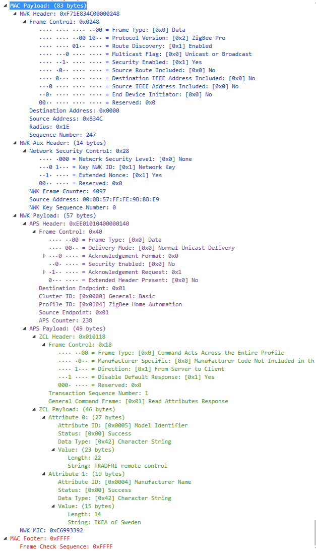

    Yes part of the payload is what I expect to be the payload of the AF_INCOMING_MESSAGE. Interesting is that almost the complete ZCL payload (response to command readAttributes['modelId','manufacturerName'] on the basic cluster) is present in the 'malformed' payload, but the last part of the ZCL payload should be 6564656e (according to sniffed network traffic), but it actually is ffffffff. Note that the difference here seems to be identical to the start of the 'malformed' payload fe456564656e0ecf... which gives the payload the unidentified command ids.
    The strange thing is that this issue only occurs when reading these specific attributes from this specific end device, if I only read 'modelId' for example I receive the AF_INCOMING_MESSAGE as expected. So it almost seems that the content of the ZCL payload is what triggers some sort of buffer overflow, or similar parsing issue.
    Received ZCL payload: 1801010500004216545241444652492072656d6f746520636f6e74726f6c040000420e494b4541206f66205377ffffffff
    Expected ZCL payload: 1801010500004216545241444652492072656d6f746520636f6e74726f6c040000420e494b4541206f662053776564656e

  • I suspect this is related to Zigbee fragment message. Can you attach your sniffer log and elaborate your issue on the sniffer log?
  • I have attached a sniffer log (Ubiqua) which shows the network join of the end device as well as the basic read attributes command which response is the malformed packet as described above. Not sure what I could/should elaborate more, please let me know.
    7827.zigbee_fragment_issue.cubx.zip
  • According to your sniffer log, it is not fragmented message. I would suggest you to enable flow control on your ZNP UART interface to see if it can solve this issue.
