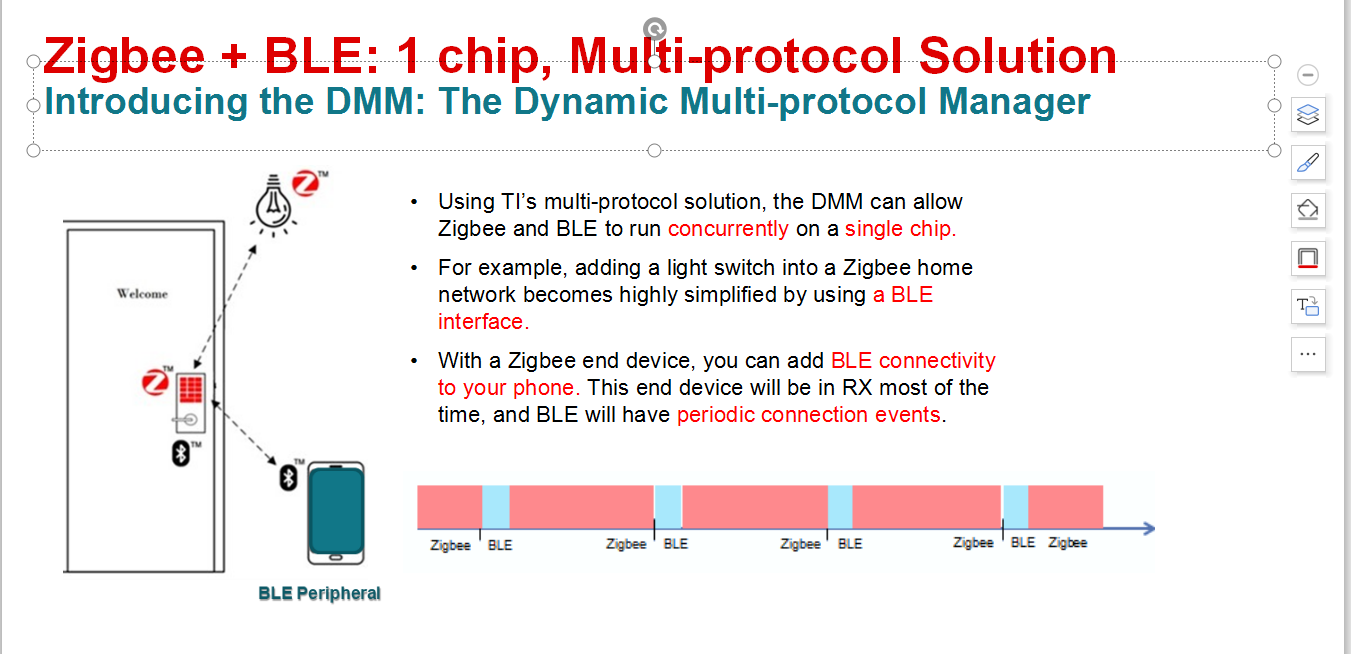

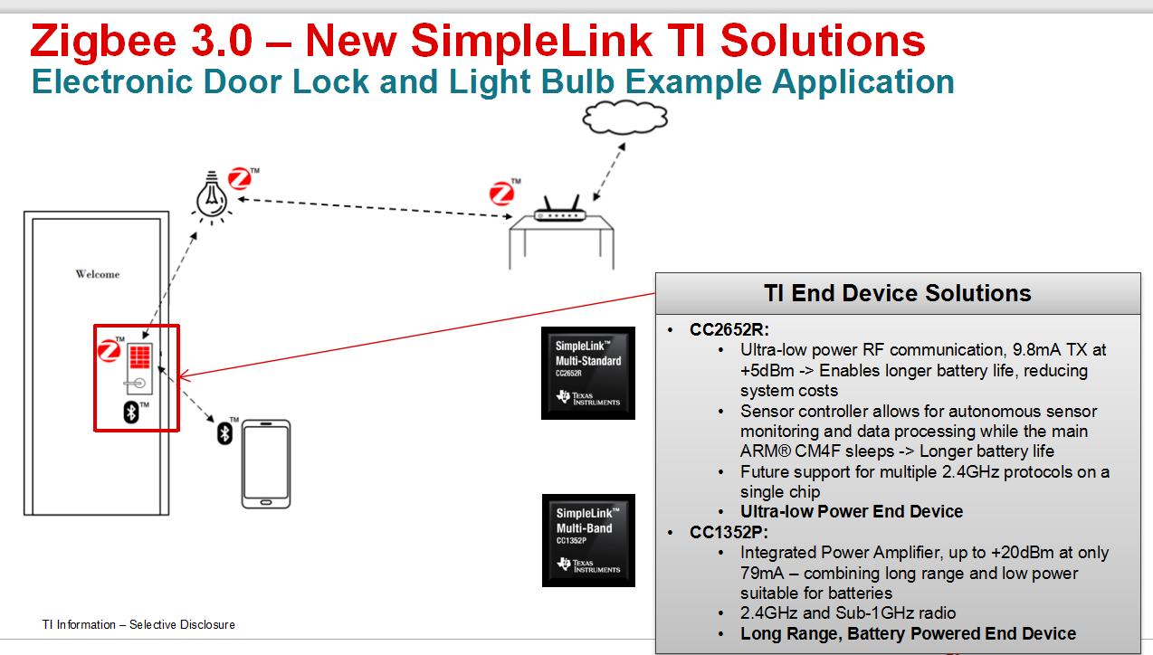

Hi TI team
I want to make sure that a point:now the CC2652 chip can run a zigbee3.0 and blue5 Dynamic mode switching?
What is  the difference between CC2652R/CC2652P ,the different power on them,the SDK can run on the 2652P?
Thanks!
