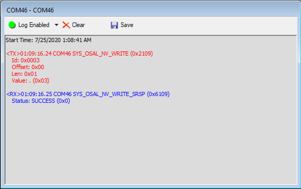

I am running Zigbee Linux Sensor to Cloud demo on BB Black and CC1352P-2 LaunchPad.
After the building of the gateway completed, I tried to run the zigbeeHAgw script with a CC1352P LaunchPad as ZNP. The below error appeared and the gateway went into an endless loop trying to reset the ZNP.
Please find the log as below and please advice about this issue, thanks!

[14:13:09.658,986] [Z_STACK/MAIN] PKTTYPE: [ NPISRVR<<Z_STACK ] [AREQ] 08:5F:00:02:5A:5F:53:54:41:43:4B
[14:13:09.660,325] [NPISRVR/MAIN] PKT_HEX: New incoming connection from client Z_STACK (connection # 5)
[14:13:09.662,238] [Z_STACK/MAIN] PKTTYPE: [ NPISRVR<<Z_STACK ] [SREQ] 02:25:3E:FF:FF
[14:13:09.664,614] [NPISRVR/MAIN] PKT_HEX: [SOCZIGB<<NPISRVR ] [send] 02:25:3E:FF:FF
ERR:: Input/output error
[ERR] npi_ipc_errno 0x02030100
Exit socket while loop
[14:13:11.674,503] [Z_STACK/MAIN] ERROR : SRSP Cond Wait timed out!
[14:13:11.674,924] [Z_STACK/MAIN] ERROR : apicSendSynchData() failed getting response
[14:13:11.675,082] [Z_STACK/MAIN] PKTTYPE: [ NPISRVR<<Z_STACK ] [SREQ] 01:2F:09:00
[14:13:13.675,885] [Z_STACK/MAIN] ERROR : SRSP Cond Wait timed out!
[14:13:13.676,292] [Z_STACK/MAIN] ERROR : apicSendSynchData() failed getting response
[14:13:13.676,441] [Z_STACK/MAIN] PKTTYPE: [ NPISRVR<<Z_STACK ] [SREQ] 01:2F:06:00
Startup phase 2 failed
