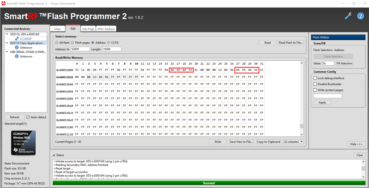

Then I read data from NV with SmartRF Flash Programmer 2 ver1.8.2, as below:
My NV start address is 0x52000. And I did find the data 0x33445566 I want to write.
But I found 0x33445566 twice. Why twice? I wrote twice, but with the same ID.
So, one ID doesn't have unique physical address?
I compare the date with this format in nvocmp.c.
Does the first data 0x7C matches header byte0 above?
If so, 0x7C in binary is b0111 1100, bit0-bit5(system id) is 11 1100, this is 0x3C, 60 in decimal. But system ID in code should be 7 not 60.
What's the relationship between systemID, itemID, subID and the physical address of an item in NV region?
Is there any document explains these concepts in detail?
And why free bytes before is 8176 not 8192, when NV is erased, there should be 8kB (8192)?
Thank you very much.

    There is a section in the 15.4-Stack User's Guide which covers non-volatile memory which I recommend you reference along with the nvocmp.c comments regarding the design overview.  The NVOCMP_writeItemApi does not check for redundancy but simply writes data for the new item and marks the old item, if it exists, as inactive.  This is why you are noticing the same NV data twice.  If you look at the bit Field Description then you will se that the system id is from 0-5 of the compressed item header information, and since nv item and system id are zero in your example they create the 0x1C0000 observed (0x13B[6/4]96 is the data length, CRC, and address). Both the flash memory page itself as well as NV items contain headers which contain pertinent addressing and ID information which explain why there are fewer bytes in the flash memory page than expected.
    Ryan
