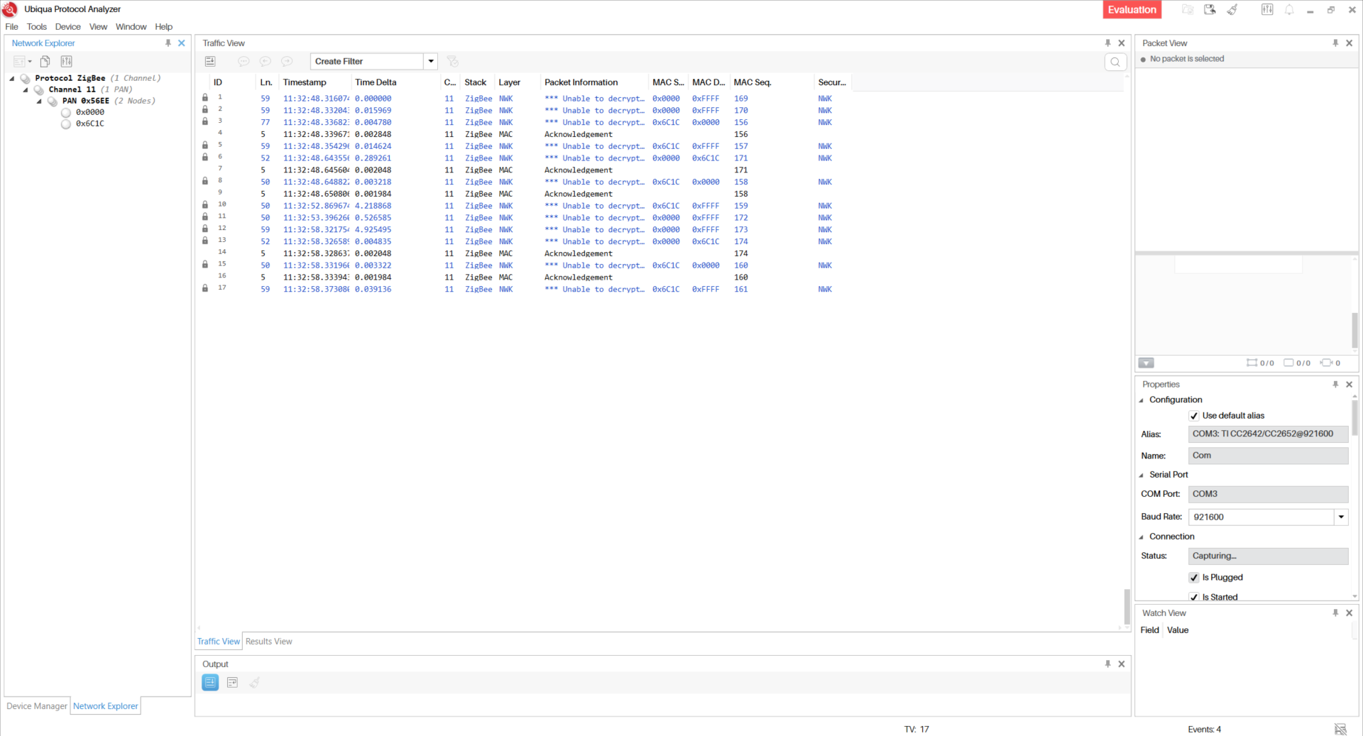

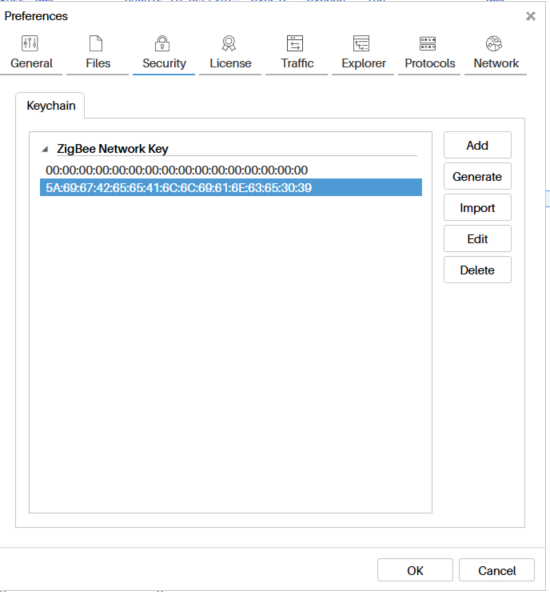

    However I face the following problems:
    The Ubiqua protocol analyzer, and as well Wireshark cannot Decrypt the packet, I triple checked the TC key in the app and is the same as the default key and the key I put in Wireshark and Ubiqua.
    Even so when the callback is called, there is no new message on the network, I cannot see any new packet that is consistent with me triggering the callback, other packets are seen when commisioning and from time to time. When looking at the rsp value it is 0,indicating that the transmission was sucessfull?
    Do you have any ideas why the protocol analyzers do not work? Also what I am doing wrong when sending a broadcast message?

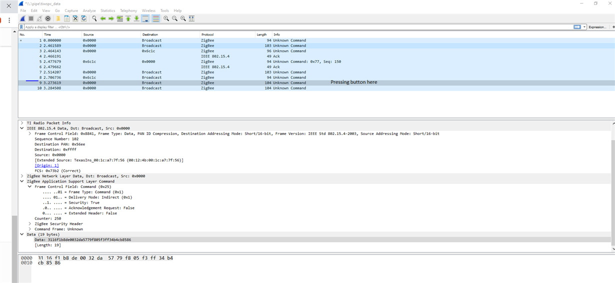

  • Try to refer to Packet Sniffer section to use Ubiqua or Wireshark to sniff Zigbee traffic.
  • Hi!
    The sniffing problem was solved by setting the following on Wireshark: AES-128 Encryption, No Integrity Protection on the Zigbee Network Layer
    Tab. In the article you send it is set to :AES-128 Encryption, 32-bit Integrity Protection.  Now wireshark does no longer report decryption issues.

    taken from the Zigbee Fundamental Project Development (plus setting the address to broadcast), however when pressing the right button of the launchpad I immediately see 2 Zigbee packets, however there is no "Hello World" String in the data, see the snipping below:
  • I cannot see your attached picture.
  • Can you try again? I have re-uploaded it
  • Also please see an attached startup of the 2 boards using ubiqua, and the configured keys
  • Can you attach your sniffer log instead of screenshot?
  • Sure,
    Here is the startup + the 2 packets that are sent when pressing the button (12 and 13).
    ubiqua_startup.zip
