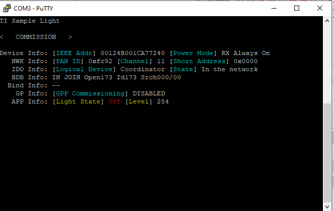

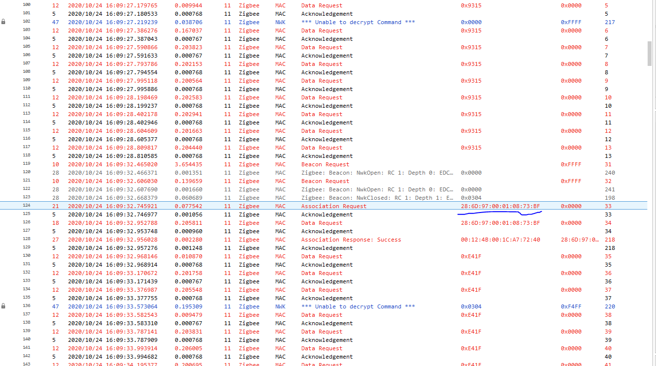

    When trying this example we set up the light coordinator with install codes gathered from the QR code of a SmartThings Switch. Then we started the coordinator light example, and did commisioning. Then we activated the switch and we see in the sniffer it started to send out Data Requests and Association Request, but why it does not connect to the network we do not understand.
    1st image showing sniffer,
    2nd image showing serial monitor in third commission attempt.

  • Can you provide your sniffer log which contains device association and key exchange process?
  • Yes, see attached from Ubiqua.1033.Smartthings_button_test.txtSmartthings_button_test.csv

  • There is no key exchange process in your sniffer log. Can you factory reset everything to test again and use sniffer to log everything?

    • Regarding checking whether they are on the same channel, if you see the screenshot above in post #3, does it not confirm they communicate on same channel 11?
      • If not, how would we confirm it?

  • Hi Fredrik,
    From what I can gather looking through the sniffer log, the SmartThings Button (ZED) completes the Association Request, broadcasts the Device Announce, sends End Device Timeout & Node Descriptor Requests to the ZC, and completes the TC Link Key update.  This confirms that the ZED supports Zigbee 3.0, the ZC is open for joining, install codes are not required, that both devices are on the same channel, and that the ZED successfully joins the ZC's network.  However the device ZED then sends Data Request every quarter second for around a minute, then at seven second intervals for about eight minutes more before ultimately Leaving the network of its own volition and restarting the process with a new short address assignment.  It seems to be waiting for some action from the ZC which never occurs, you may need to consult a SmartThings forum to find the expected hub behavior.

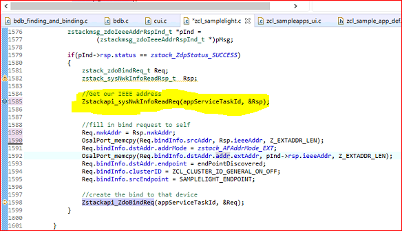

  • Hi Ryan,
    Now, we able to join button with our ZC Light example code using install code.
    I have enable Finding and Binding and when I click on commission from serial terminal menu to trigger binding
    I can see it able to receive at case zstackmsg_CmdIDs_ZDO_IEEE_ADDR_RSP: as shown in figure in function zclSampleLight_processZStackMsgs().
    Here for debug when I put breakpoint at line 1585- Zstackapi_sysNwkInforReadReq() it go into this function.
    But, after that it exit from that.
    It doesn't executing code below that line which fill and create bind request.
    So, question is what could be problem for this issue?
    Is it could be memory issue?
    Dhaval
  • Hi Dhaval,
    You will need to provide more debug information (sniffer log, call stack, device behavior, etc) in order to receive any further assistance.  The code shown would only be used in the case that an endpoint with a matching cluster was found on a remote device (i.e. button) at which point the local bind would allow for BDB reporting.  I do not know enough about the SmartThings device to know whether the On/Off Cluster client is supported.  The device would not simply "exit" the middle of a case statement so you need to determine whether it was really executed in the first place or if the device enters a bricked/unknown state.

  • I cannot decrypt the sniffer log since no NWK key is provided, the sniffer must not have captured the commissioning/joining process.  It is possible that the high level of code optimization is causing the erratic debug behavior, you may try turning it off in Properties -> Build -> ARM Compiler -> Optimization.  The sniffer log will also show whether the light application got as far as to send a Match Descriptor Request followed by the IEEE Addr Request to the button.
    The purpose of the zstackmsg_CmdIDs_ZDO_IEEE_ADDR_RSP case statement code is to create a local bind so that the light can report its status to a compatible device, in this case the SmartThings button.  If the button does not automatically bind to the light during the F&B process (in order to control the light's status) then you must manually create a bind to be sent to the remote device as well.  This type of functionality is accomplished in the ZIGBEE-LINUX-SENSOR-TO-CLOUD gateway example.
