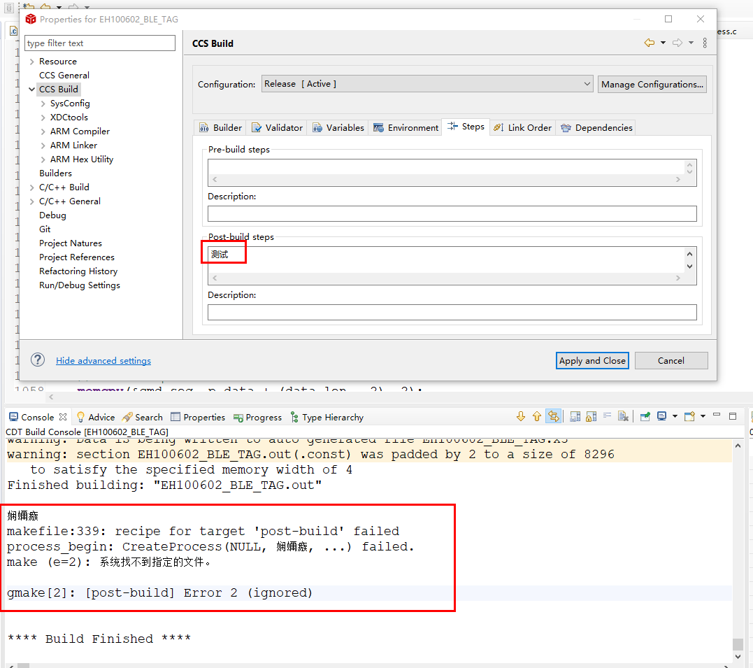

Hi, I use CCS v10.1.

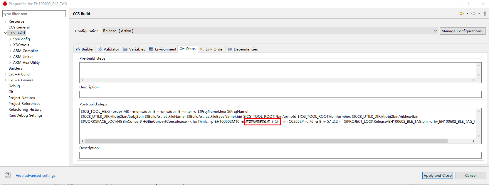

I have some Chinese parameters in post-build steps as below:
And then, I rebuild the project. After rebuild, the tool in post-build runs successfully. However, the Chinese parameter characters become unrecognizable characters in console as below:
So, how to make it display Chinese normally please?
  • I don’t think CCS is such flexible to use Chinese characters in post/pre build action and would like to suggest you to use Alphabet instead of Chinese characters.
  • I am tryng to test this out.  Could you paste the command being used in text and I can try that on my end.
    I did the following test and it worked ok.  The command was not valid but the characters look correct.

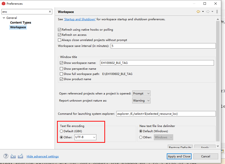

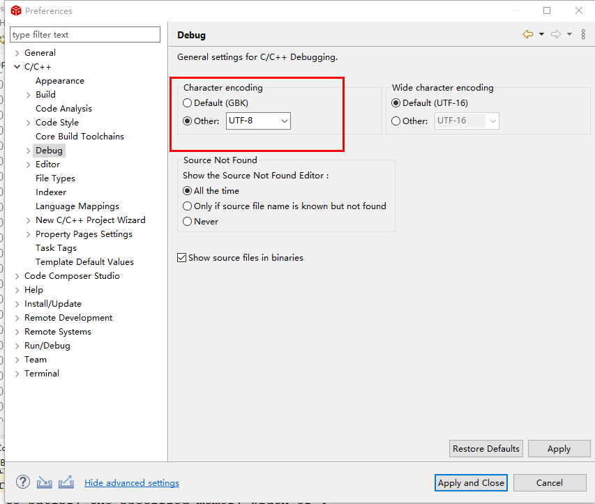

    My encoding is set as UTF-8 in these places:
    John
  • I deleted all my command and left only two Chinese characters as what you did, and I changed the two encoding setting to UTF-8(original is Default(GBK)).
    But still unrecognized characters in console.
    It seems that there is some encoding unmatched, leading to unrecognized characters in console.
