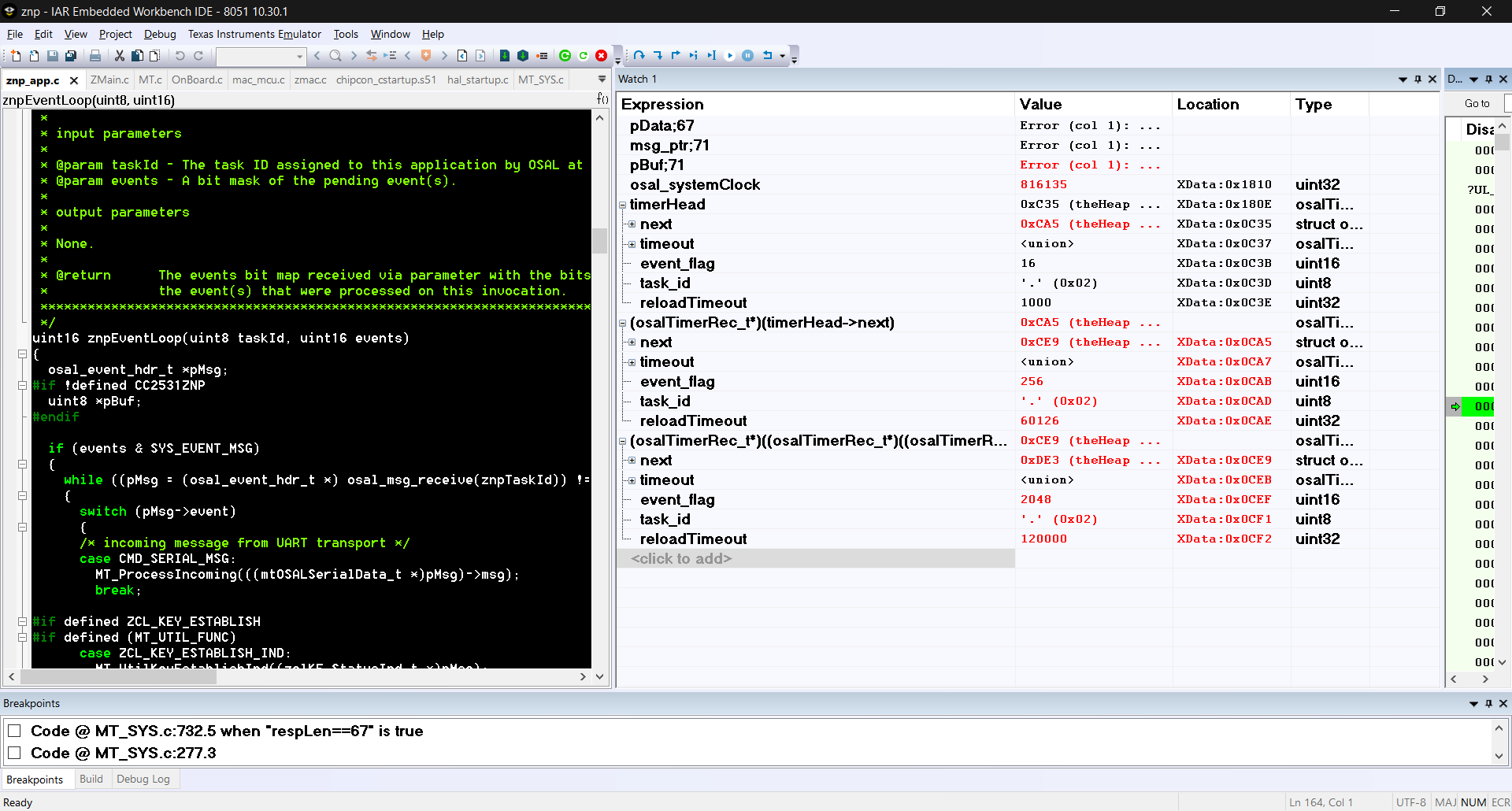

The serial interface of the ZNP was not responding, and as IAR was open in a debug sessin, I have more information.
My interpretation of the timerHead LinkedList is that it is corrupted. A clean linked list has only one bit in the event_flags .
The screenshot should help understand that. I also saved memory from using Debug > Memory > Save . I do not know what is required exactly to be able to reload it.

    Apparently the pasted images are not visible on the site, it showed that XDATA stack size is 4D0.
    We can compare the screenshots and also read the hex file dump of XDATA memory.
    In the hex dump we can find the Timerhead value, so this is the correct dump:
    This value is invalid as it is inside the STACK which ends at 0x4D0.  Unfortunately it is not initialized, so visual inspection does not allow to know if there was a lack of STACK -> I add initialisation in the code so that we can see this next time.

    I examined the variables located near Timerhead, and extracted their values from the XDATA dum:
    osalMemStat 25  -> can only be 0 or 1, so is corrupted.
    pgOff   01012502012504012506012509
    pgLost  0801250A01250C01250E012510
    pgRes   01
    hotPg   251201
    hotOff 250002180402
    pwrmgr_attribute 1B000330010322 -> These are all 0 in my case.
    TimerHead 0203  -> 0x0302
    OsalSystemClock 26030318
    tasksEvents 040318060318070342080342AB
    So it looks like the pwrmgr_attribute was also corrupted, and we are near address 0x1800.
