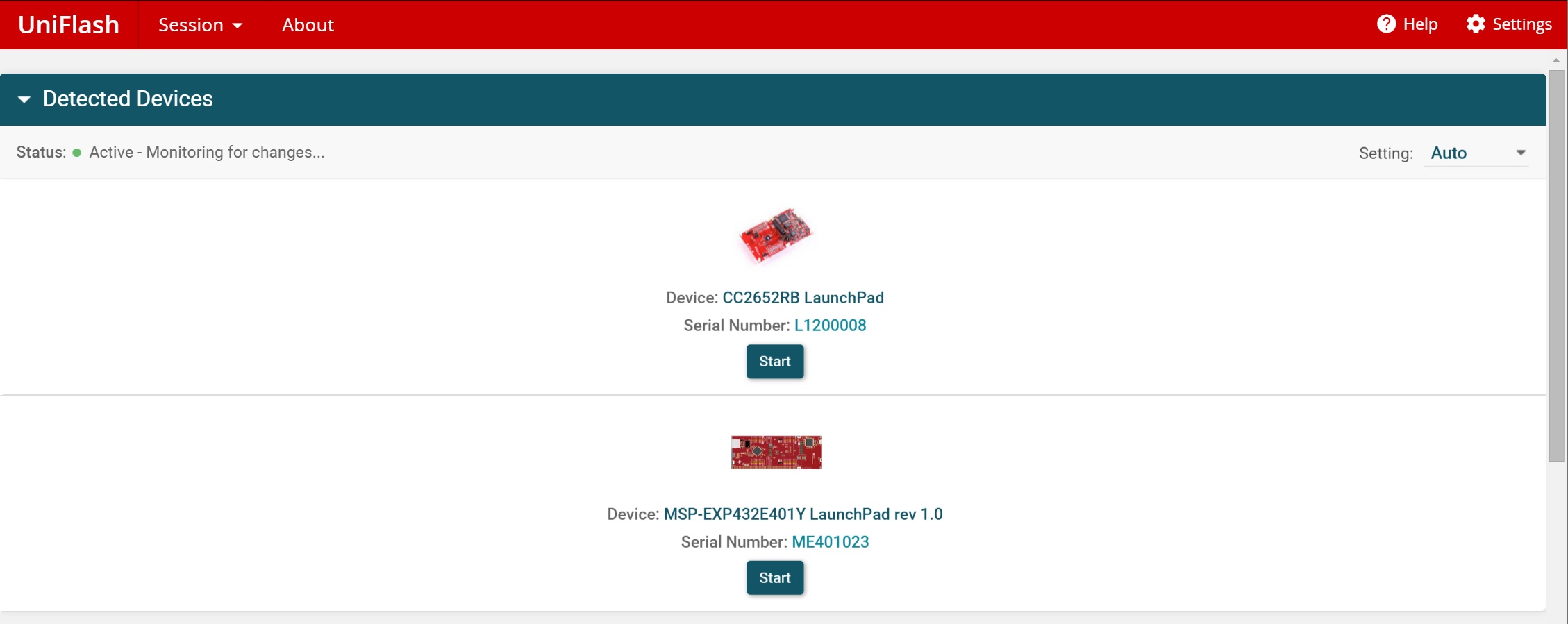

I have two CC1352P launchpads connected to my PC and am attempting to use the uniflash software to program with both launchpads.
I can program a single device with the launchpad via the following command
 dslite.bat -c \targetConfigs\CC1352P1F3.ccxml -f  myCode.bin,0x0
However, seems random in which launchpad it picks. I see both launchpads in device manager and with detect-devices.bat . Is there any way I can specify the usb-comm port (or something) via the uniflash CLI so I can select which launchpad to use?

  • Figured out a method of doing this via generating a unique CC1352P1F3.ccxml configuration for each launchpad which locks in the serial # of the launchpad. While that works, its a little bit more tricky to setup then being able to specify a comm port number

  • Hi again Nathan,
    Just heard back from the team and unfortunately using the serial numbers is the only solution.
    Elin
  • Hi Nathan,
    Note that if you start up the UniFlash GUI, our detection module will list out all your LaunchPads with the XDS serial number. If you click on one of them, it will take you to the main interface where you will be able to download the CCXML with the serial number included, or generate a fully portable command line package based on this configuration.
    Unfortunately, the ability to generate CCXML is not available from UniFlash CLI at this time, so starting the GUI is needed for this.
