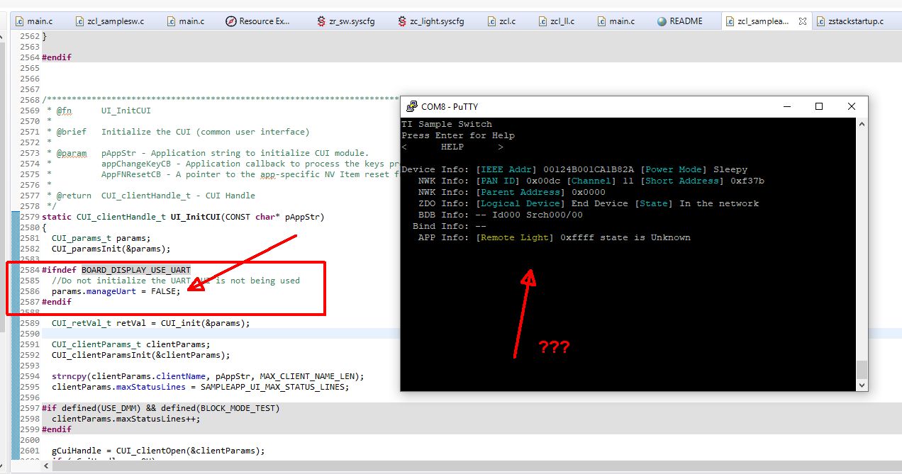

I have two LaunchPads programmed with zed_sw and zc_light Z-Stack examples.
I want to measure zed power consumption with different POLL_RATE settings. zed_sw should stay connected to zc_light.
I suppose that I have to disable the UART interface to consume less energy..
What I tried:

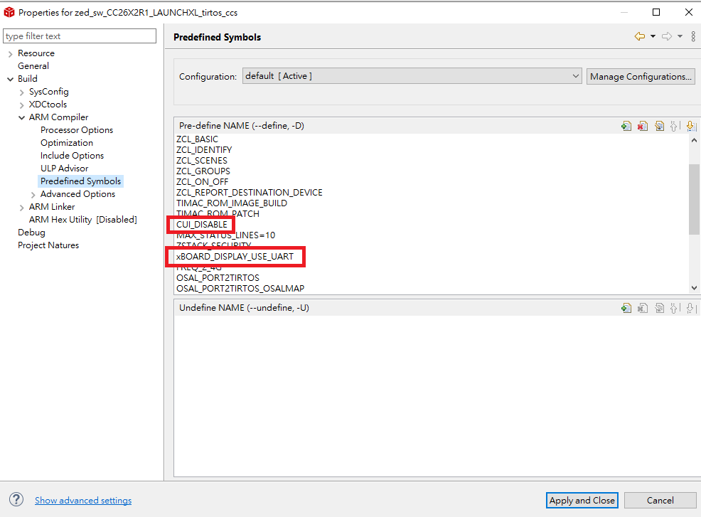

1. Changing BOARD_DISPLAY_USE_UART to xBOARD_DISPLAY_USE_UART - the UART interface still works.
2. Changing BOARD_DISPLAY_USE_UART to BOARD_DISPLAY_USE_UART=FALSE - doesn't help, still see UART update.

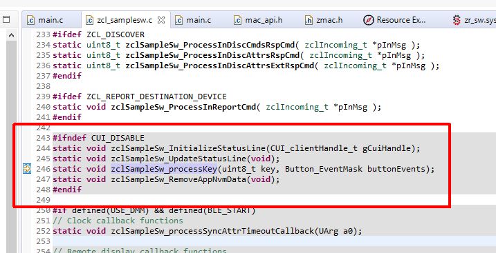

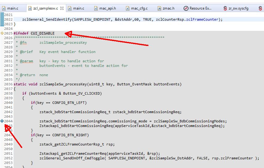

3. Changing xCUI_DISABLE to CUI_DISABLE - zed_sw doesn't connect to zc_light at all. I tried to perform Factory Reset with BTN-2 and Start Comissioning with BTN-1 - nothing.
How should I do it properly?
