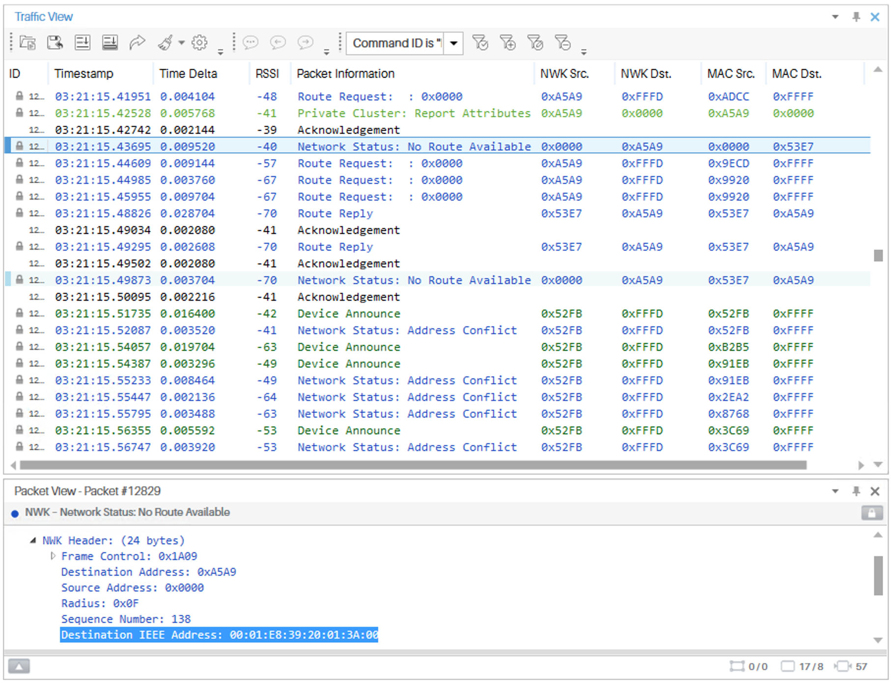

But analyzing a sniffer trace, I've found this behavior:
There is no side effects on the communication; the device 0xA5A9 changes its network address in 0x52FB and all works. I think the cause is the message highlighted because the destination IEEE address is not the IEEE address of the device 0xA5A9. This IEEE address does not exist in the network (and we don't have any device with this IEEE address).
So, why this behavior? What could have gone wrong?

  • Thanks for confirming that you use MTO routing.
    How easily reproducible is this issue ?
    Looking through the logs, I'm not sure why 0xA5A9 is reporting directly to 0x0000 (pkt 46) since it does not have a route to 0x0000 (its Link Status in pkt 1 has entry for 0x0000 with outgoing cost 0).
    Besides this, it seems like the Network Status (pkt 47) is due to 0x0000 receiving a packet from a device to which it does not have a route.
    If MTO is used, I believe 0x0000 should actually send an MTO route request instead (zgConcentratorEnable == true).

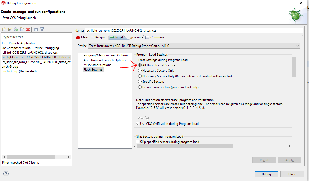

        • Did you make sure to erase all flash before flashing the new MTO-enabled image ?
          If not, the zgConcentratorEnable would be loaded from NV instead.

  • Antonio Portaluri said:
    I've flashed the CC2652 with the Code Composer Debug button: it's not enough?
    By default, CCS will flash only the executable image (the NV area is retained).
    This is useful for cases where you need to update the application logic, but want to retain the network information (e.g. to rejoin the network after flashing).
    There are a few ways you can erase all flash on the device, one of them is shown in Task 0 of this SLA.
    You can also change the default behavior of the Debug button, so that it first erases all flash on the device before loading the image:
    right-click the project --> Debug As --> Debug Configurations --> Target --> Flash Settings --> All Unprotected Sectors
