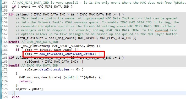

    It looks like the device will need a valid short address before it's handled :
    In <zr_*>/Stack/zmac/zmac_cb.c  --   MAC_CbackEvent :
      if ( event == MAC_MCPS_DATA_IND )
        MAP_MAC_MlmeGetReq( MAC_SHORT_ADDRESS, &tmp );
        if ( (tmp == INVALID_NODE_ADDR) ||
             (tmp == NWK_BROADCAST_SHORTADDR_DEVALL) ||
             (pData->dataInd.msdu.len == 0) )
          MAP_mac_msg_deallocate( (uint8_t **)&pData );
          return;
    Toby

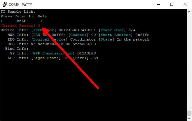

    I found another issue. If I send an Inter-PAN message from a ZC that hasn't been commissioned before (after chip erasing and programming a new firmware) and then start commissioning, it gets stuck in Main_assertHandler() with assertReason=3.
    If I reset ZC, don't send Inter-PAN and start commissioning, it works. But if I reset ZC, start inter-PAN first, then start commissioning, it doesn't work.

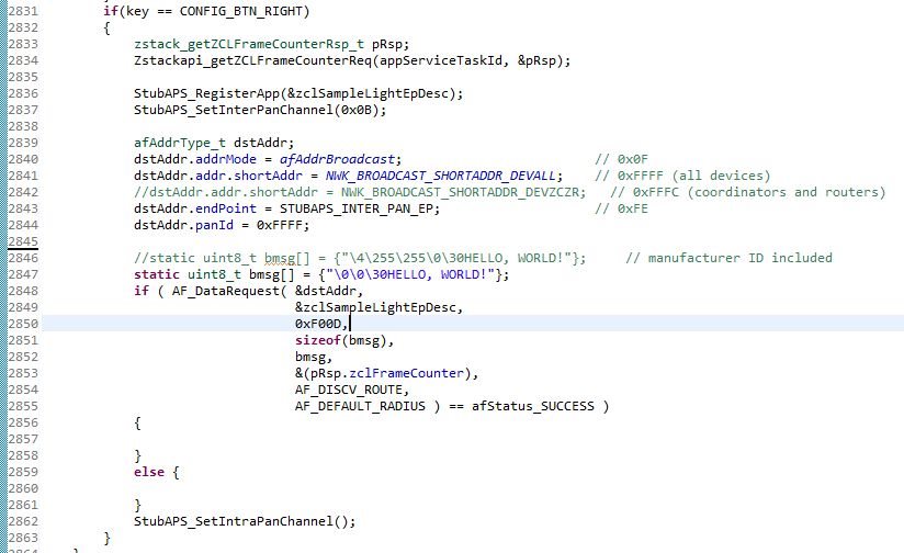

    There is a piece of code that starts Inter-PAN transmission:
    Why does it happen and how could it be fixed?

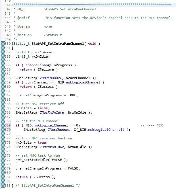

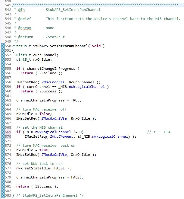

  • I fixed the issue I've talked about in my previous post. Maybe it would be interesting for you.
    If you call StubAPS_SetIntraPanChannel() after Inter-PAN transmission on a device that was not commissioned, it gets stuck on the
    ZMacSetReq( ZMacChannel, &(_NIB.nwkLogicalChannel) );
    because _NIB.nwkLogicalChannel is 0.
    So you should check "if _NIB.nwkLogicalChannel != 0" before calling StubAPS_SetIntraPanChannel() or before ZMacSetReq( ZMacChannel, &(_NIB.nwkLogicalChannel) );
    Now it works fine.

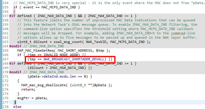

  • Also I found why ZC didn't receive Inter-PAN messages. If I comment the line of the code, Inter-PAN messages are passed by the condition and I get events  zstackmsg_CmdIDs_AF_INCOMING_MSG_IND in zclSampleLight_processZStackMsgs().
    So now it looks working and I can receive inter-PAN messages, but are there any unwanted consequences of this fix?
  • Is this after the ZC has formed a network ?
    Once a device is in a network, its short address should be assigned/initialized to a valid value (i.e. should not be a broadcast address).
    Commenting this out means that the device could receive messages before it has a valid short address (which may be ok for your use case).
    In steady state operation (device operating in network), the device would have a valid short address throughout its lifetime in the network, so the condition for this if block will evaluate true.
    Another consideration for inter-PAN would be security related. Having some kind of screening procedure could be useful (e.g. filtering out unknown commands).

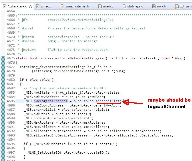

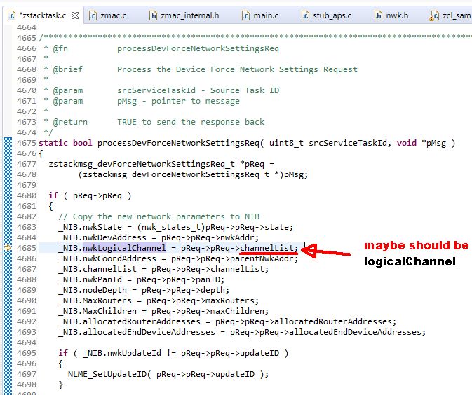

  • It looks like I found a bug in the zstacktask.c
  • Thanks for pointing this out.
    The struct zstack_devForceNetworkSettingsReq_t does not have a logicalChannel field here, so I will check with development team if this was intentional.
    At a glance, I'd agree that _NIB.nwkLogicalChannel should not be set to channelList (which is a bitmask of channels).
    Are you using this API in your code ? (The SDK examples do not use it by default).
    The MAC_NO_RESOURCES is the status returned when the MAC channel change api (i.e. MAP_macRadioSetChannel) is unsuccessful.
    It looks like StubAPS_SetIntraPanChannel and StubAPS_SetInterPanChannel both are changing the active channel.
    However, StubAPS_SetInterPanChannel is calling StubAPS_SetNewChannel,   vs   StubAPS_SetIntraPanChannel which is calling ZMacSetReq( ZMacChannel, ...) directly.
    As such, can you try something like this :
    ZStatus_t StubAPS_SetIntraPanChannel( void )
      uint8_t currChannel;
      uint8_t rxOnIdle;
      if ( channelChangeInProgress )
        return ( ZFailure );
      ZMacGetReq( ZMacChannel, &currChannel );
      if ( currChannel == _NIB.nwkLogicalChannel )
        return ( ZSuccess );
      return StubAPS_SetInterPanChannel(_NIB.nwkLogicalChannel);
  • No, I don't use this API. I found it accidentally.
    Thanks, but probably there is also required
    // set NWK task to run
    nwk_setStateIdle( FALSE );
    after StubAPS_SetInterPanChannel(), otherwise it doesn't work.
    Btw, I found the solution for my problem and now can change Inter-PAN channels and send messages any time. It doesn't depend on a formed network. It is important to call StubAPS_SetIntraPanChannel() ONLY after receiving zstackmsg_CmdIDs_AF_DATA_CONFIRM_IND event. So now it works for commissioned and non-commissioned devices.
    But I still get 0x1A status value from ZMacSetReq( ZMacChannel, &channel ) when change inter-PAN channel (if ZigBee network is formed). Although it doesn't affect on functionality, the channel is changed and I see this in the sniffer.
