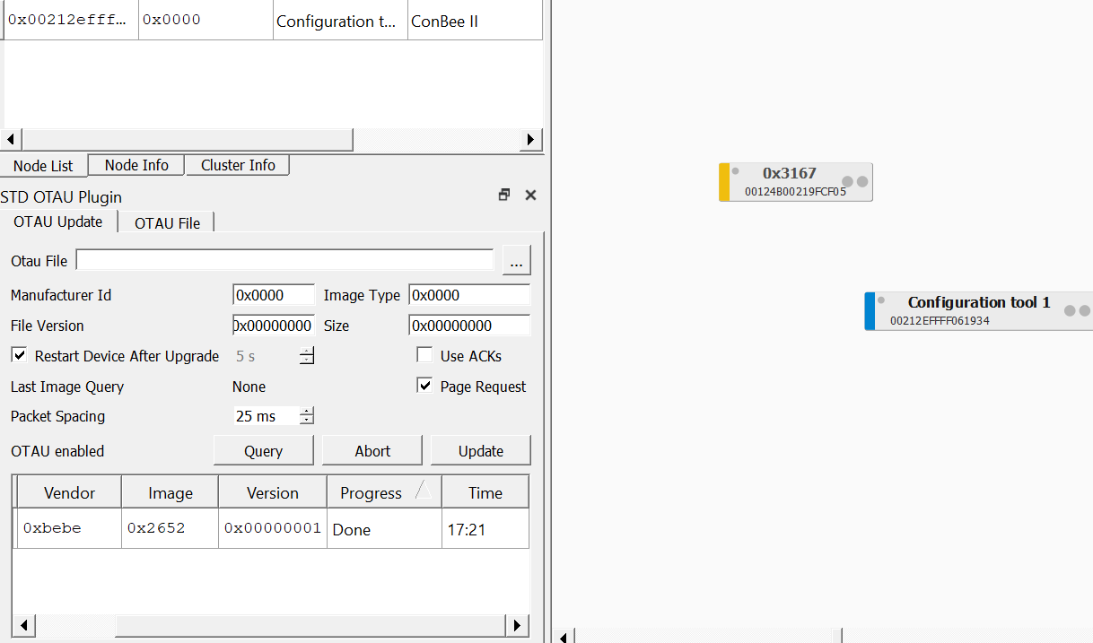

But, out goal to make it work for 3rd  part gateway like Phoscon
Walter
  • Hi TI Team,
    The sniffer log says the  fota completed trasfer of  BEBE-2652-00000001.zigbee as show n in sniffer log.
    But, my device not properly updated, and not booting properly. Is there a wat to combine the BIM offchip firmware with the zr light code to 1 firmware so 1 loading only?

  • Hi YK/Ryan,
    I compared the sniffer log of:
    https://e2e.ti.com/cfs-file/__key/communityserver-discussions-components-files/158/feb02_5F00_zr_5F00_light_5F00_otaclient0x13c6_5F00_to_5F00_zc_5F00_demo_5F00_board.7zhttps://e2e.ti.com/cfs-file/__key/communityserver-discussions-components-files/158/feb02_5F00_zr_5F00_light_5F00_otaclient0xa947_5F00_to_5F00_3rd_5F00_party_5F00_gw.7z1. zr light ota client to  zc server in a demo board - working properly
    feb02_zr_light_otaclient0x13c6_to_zc_demo_board
    2. zr light ota client to  3rd party gateway.
    feb02_zr_light_otaclient0xa947_to_3rd_party_gw - not rebooting
    Walter
  • Walter,
    The demo_board sniffer log aborts the OTA upgrade (packet 29277), I would not consider this as working properly.  The image sizes are the same in each so I'm not sure what is wrong with the image such that party_gw finishes the upgrade but cannot boot properly afterward.  You can read the flash memory content in UNIFLASH or FLASH-PROGRAMMER for each and compare the differences, and review the Z-Stack OTA Upgrade documentation.

  • Hi Ryan,
    There is a difference between 3rd party gw and  zc ota demo board.https://e2e.ti.com/cfs-file/__key/communityserver-discussions-components-files/158/memory-comparison.7z

  • Hi Walter,
    The difference in flash comparison concerns the NV memory, to_zc_serverdemobd.hex starts at 0x48000 whereas to_3rdpartygway.hex starts at 0x54000.  It is important for the application to know where the NV memory resides and this discrepancy is most likely causing the boot issues.
    Ryan
  • Hi Ryan,
    We are running same firmware and BIM.  As we know,  The start address is set in FW already.
    I check our ota tool is not setting nV start address or dont have means to change start address.
    Walter
  • The OTA image candidate typically does not overwrite the NV memory, this way the device retains network information and is able to rejoin after an update.  The OTA application does however need to know where the NV contents are located.  The flash area of NV is determined when building the application firmware.
    More information is required to determine where the inconsistency exists in the system.  Have you tried changing the OTA block request size?  Does the same node/firmware which fails to be updated with the third-party OTA server succeed when using the TI tool?  Are you able to use the third-party setup to update a default SIMPLELINK-CC13X2-26X2-SDK v4.40 OTA client?
    Ryan
