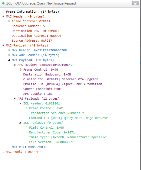

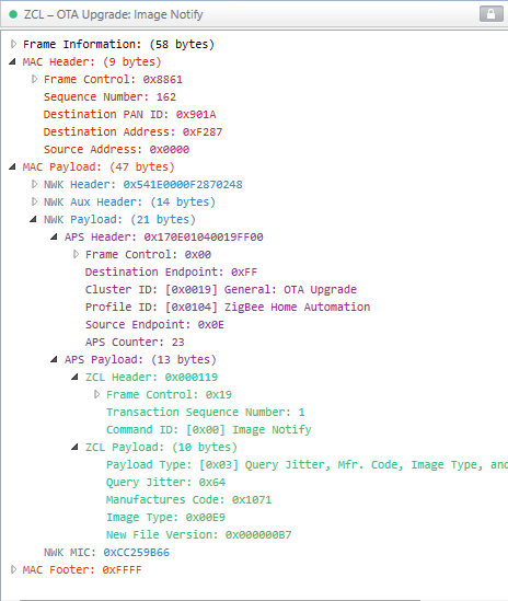

We are working on a Zigbee application on a coordinator (CC1352P and Z-Stack Linux). Now we are working with the OTA server. We managed to successfully register a .ota image, and we enabled the option to notify the device when the registration was finished, so that the update would begin.
The "Image Notify" message is:
The "Query Next Image Request" message is:
The "Query Next Image Response" message is:
It says there is no image available. However, the image is registered in the database. Also, I followed the registration process through the console, and everything happened fine. From what I can see, the reporting image is a lower version than the one registered on the device. I understand well ? If yes, how can I "force" a device to update by OTA with a lower version image?

  • Hi Randy,
    I agree that the lower versioning could be an issue, also I noticed that the image types do not match.  You should modify the image type and file version checking inside OtaServer_GetImage -> FindNextImage from OtaServer.c to meet your needs.
