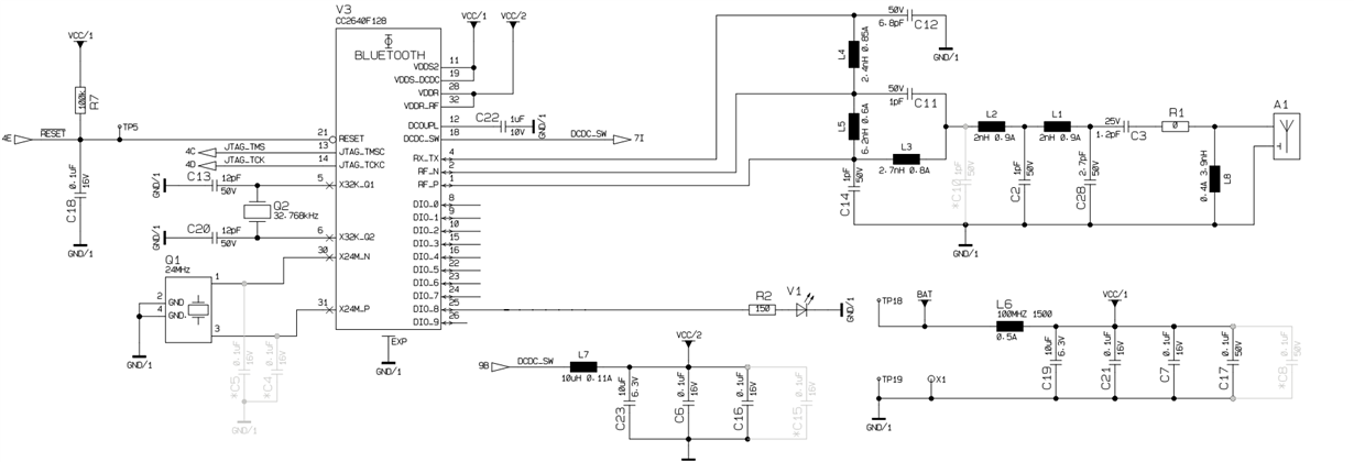

  • Hy,
    this is the relevant parts of my hardware
    Is that what you need for further support?
    Harald

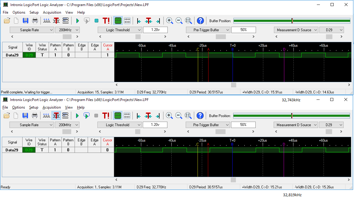

    I finally managed to measure the 32kHz signal on an IO port after activating it as described in TRM 11.3.3
    Statistically I see a constant frequency of 32.770kHz, but actually, it jitters quite a bit: The slowest I've seen is 32,743kHz, the fastest is 32,819kHz. But this might be due to my measuring equipment: I use an 200MHz logical analyzer, trigger on high state longer 16.05us to find the slowest and trigger on high state shorter 15.24us to find the slowest. Than I add high and low duration and use the reciprocal value as frequency.
    I never saw any longer droputs of the frequency, also not during the error state (immediate disconnects)
    This seems OK. What do you think?
    Harald

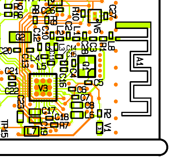

  • Sorry for the delayed reply but I have been out of office. When I asked you to try to disable the DCDC, that was meant as a test not as a solution. You can disable the DCDC in SW in the ccfg file, no HW changes needed. This is because with a non-optimal DCDC layout, the RF performance can be reduced. It is hard to say much on your HW without seeing the GND layers, can you send me a more detailed pic with the GND layers in a message? Schematic looks ok. Have you updated your SW so that it uses the correct front-end configuration (in your case differential with external bias)?
    It would be could if we could somehow verify the RF performance of your board. That is why I refer to SmartRF studio. Do you have any of our HW available so that you could do some measurements to compare performance? This way you could also verify the 32kHz clock with your measurement set-up.
