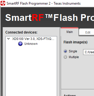

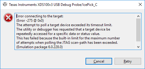

Now, in the first two badges of series production there is a strange effect, that hits about 5% of all devices: During casting the processor stops working. Devices don't advertise any more and are not connectable to the JTAG debugger, FLASH Programmer does not recognize the device.
After HW reset the devices run normal again. Unfortunately, this does not help, because JTAG connector is not accessible in the final product.
