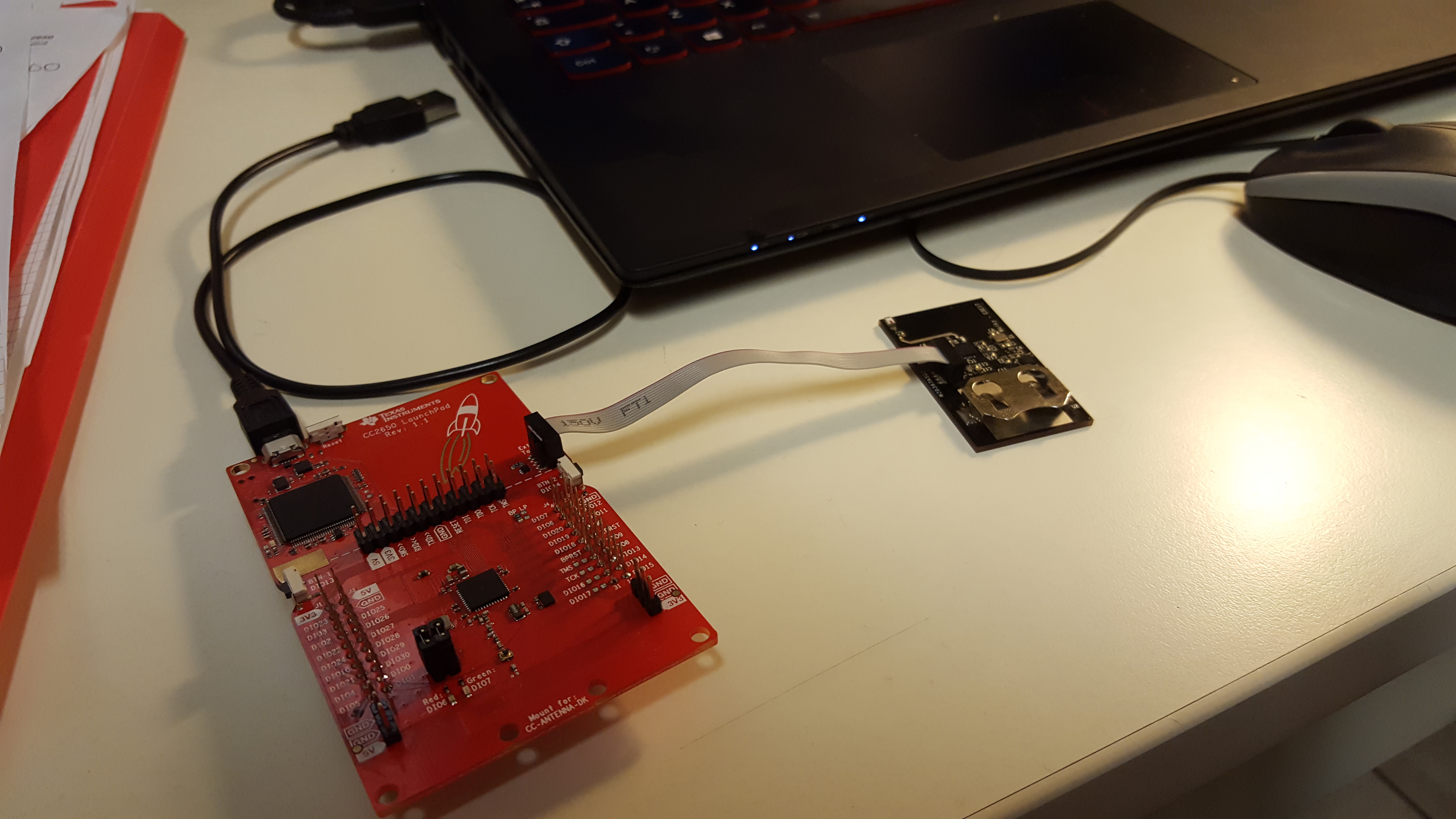

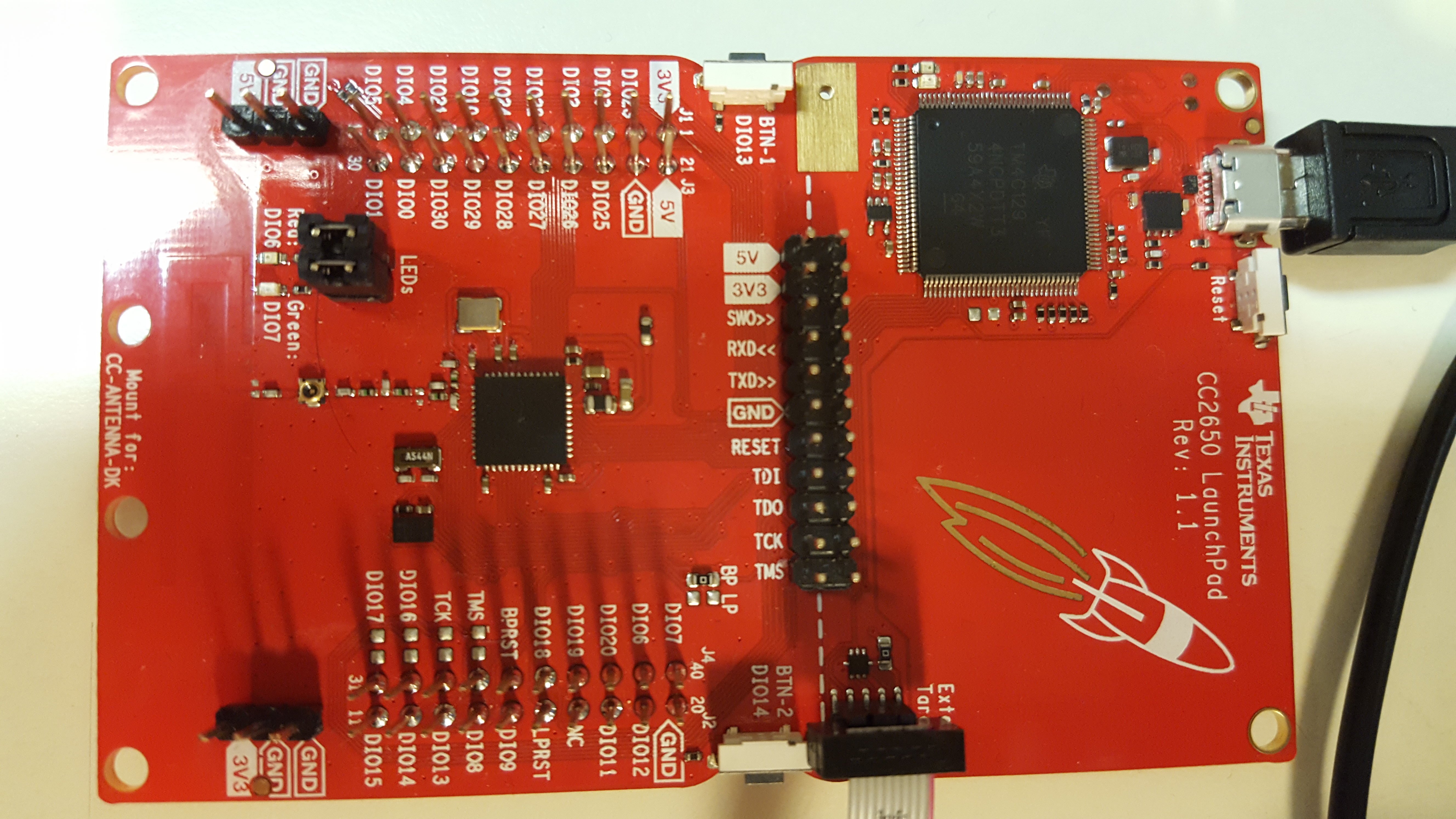

    I've merged your posts since they are covering the same topic - please use this thread for troubleshooting your board. Can you attach a photo of you debug setup? Do you see the thermal issue if you do not run with the JTAG attached but use the standby example?
    Best wishes
  • Thank you very much! Sorry if I didn't use the same thread. Here the picture of the debugging setup. I tried to download the program on the board, unplug the JTAG connector and power the board with the CR2032 and it correctly executes the code (GPIO1 is correctly initialised to HIGH). The overheating is always present, unfortunately. Obviously being the battery a cr2032 of 3 V (I measured 2.45 V) the phenomenon is less evident, but I can experience a mild heating   (which means our battery is discharging very fast).  I am attaching the picture you asked me.
