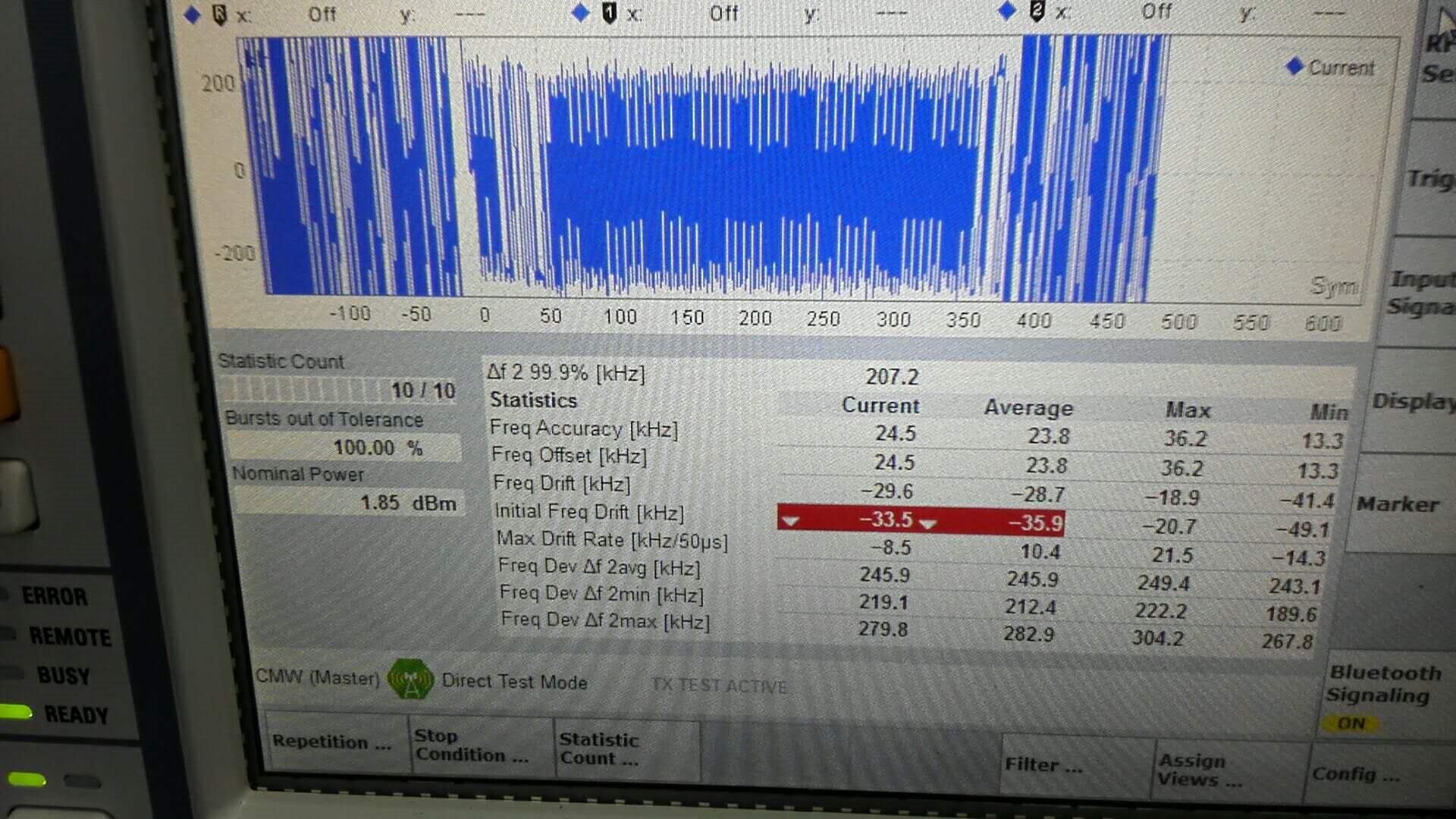

I found the following problems in the CMW270 test:
initial freq drift=30kHz,It is a bit high.What might be the reason.What happens if this parameter fails

fine tune the frequency accuray might improve it. (tune the CL)
Layout can cause the problem. you can post you snapshot here, I can help to check.
it will cuase package loss.
BR. Albin
Hank Zhang said:1.What's the effect of the initial drift too high?This is the most important question
You will not be able to pass Bluetooth qualification. Violating the PHY requirements may also lead to packet drop and connection problems.
