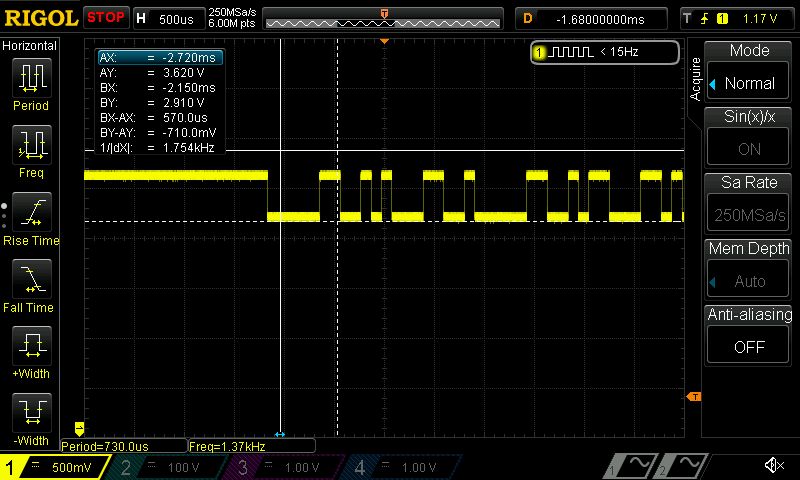

I am using the SensorTag 2 Debug DevPack Rev 1.2, and have configured it to use DP4 (UART RX) and DP5 (UART TX). But for some reason the amplitude for TX is very weak, 710mV instead of 3.3V (see image)
I am using the uartecho_CC2650F128 example that comes as with TI-RTOS, And made a few changes to configure it to use the debug devpack pins (see code changes below)
I have also seen the same issue discussed here (e2e.ti.com/.../423180) but it makes no difference if I have the battery in or not. I need to have this working when debugging.

  • I have found a resolution to the problem.
    Do not use the default setup, instead reconfigure the pins by editing the board.h file (located in C:\ti\tirtos_simplelink_2_13_01_09\packages\ti\boards\SensorTag\CC26XXST_0120)
    TX is pin DP3 on the Debug DevPack (do not pay attention to the define name)
    RX is pin DP4 on the Debug DevPack
    #define Board_DP3                   IOID_28 //IOID_27
    #define Board_DP4_UARTRX            IOID_29
    #define Board_DP5_UARTTX            IOID_27 //IOID_28
    The CC2650 seems to offer very flexible multiplexing options, details of any of this are yet to be included in the data sheet.

  • Martin Sunstrum said:
    Glenn, are you using the USB as COM ports, or adding an external RS-232 level shifter ?
    I am not using the USB COM Port for the UART.
    I am designing a board, and as such I am directly connecting the UART pins from the CC2650 to the UART pin of a OBD/CAN Controller board.
  • OK, now your changes might start to make sense.
    In your first post, you indicate you are using the Debug DevPack (presumably only for debugging purposes )
    But the microcontroller in the Debug DevPack is driving your Board_DP5_UARTTX pin, and likely was also being driven by the UART on your OBD/CAN controller board.
    Bottom line ... when using the Debug DevPack, it's microcontroller is also using the UART TX/RX pins for a USB virtual COM port, and there is a potential electrical conflict with your custom hardware.
    You have effectively moved Board_DP4_UARTRX over to the original DP3 pin which is not used by the microcontroller in the Debug DevPack, and that removed the electrical conflict.
    I don't have any info on the Debug DevPack on how to prevent it from using the UART TX/RX pins.
    Thx, Martin

  • Does anyone have an update on this problem?
    I too are experiencing the behavior mentioned here. Using the default uartCC26XXHWAttrs settings and Debugger Dev Pack I can get a functioning UART working via Debugger Dev Pack. I can put a DSO on the DP4 Test Point of the Debugger Dev Pack and observe a nice 0 to 3.3V Asynchronous Serial waveform.
    However, if I connect it to my own board and put a CRO on the pin, I get an Asynchronous Serial waveform approximately 2V to 3.3V. My board is only a breakout - there is nothing but a header connected to DP4. I connect the CC2650STK directly to my breakout board - the debugger is not in the stack.
    From my fiddling, so far it would appear to be a problem resulting in how the board is powered up.
    I have changed tx and rx pin declarations in uartCC26XXHWAttrs and obtained a functional breakout board, although with the UART output on DP4. I believe this is more of a work around than anything else.
  • I should add that changing uartCC26XXHWAttrs and assigning .txPin to almost any other pin except DP5 (IOID_29) seems to fix the problem.
    This issue seems specific to IOID_29. From the datasheet, IOID_29 appears to be Digital/Analog I/O connected to GPIO, Sensor Controller, Analog - not dissimilar to most of the other pins.
