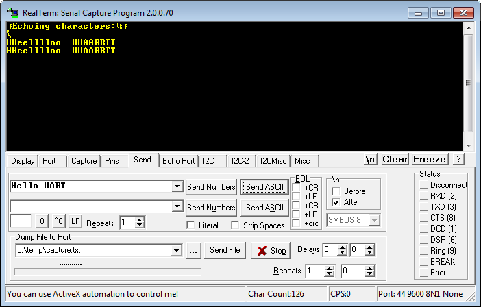

  • Martin,
    I just test your UART code above on the SensorTag project. Below is a description of what I did to make it work:
    Versions:
    • Debugger DevPack Rev 1.2.0
    • SensorTag PCB Rev 1.2 (sticker says 1.1.3)
    • BLE stack v2.1 (tested with IAR v7.40.2 and CCS v6.1)
    Steps:
    • Find XDS110 UART port in Device Manager (COM44 in my case)
    • Open BLE stack v2.1 SensorTag project
    Add a new group (IAR) / virtual folder (CCS)  "UART" in the application project
    • Add in UART.c and uart/UARTCC26XX.c to folder
    • Modify main.c with below code
    • Compile and upload stack and application
    • Open RealTerm, verify "Echoing characters" being output
    • Write data through RealTerm, verify corect data is returned.

  • My apologies.
    At some point, I reduced the Task's stack size to 80 bytes instead of your 512.
    Increased to 512, and works like a charm.
    Thanks again for your help Svend !
