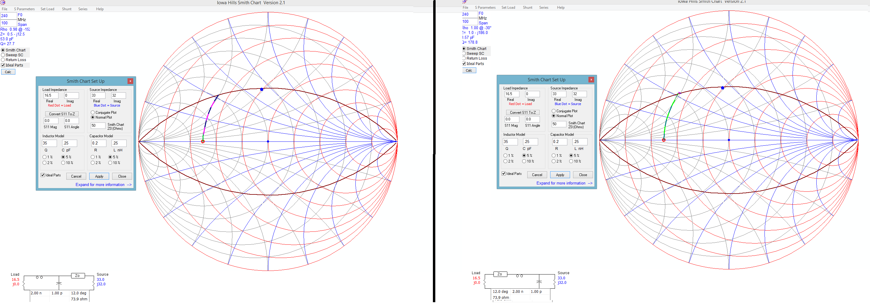

I am following the  AN068 for CC2538EM, but I can't get the impedance matching. I would appreciate if someone can tell me what I am missing.

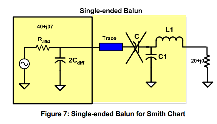

According to the datasheet, the optimum load is 66 + j64 ohm at RF_P and RF_N. Referring the Figure 7 of the App note (below):
I should have the source part as 33 + j32 ohm and the load should be 16.5 + j0 ohm.
The copper length from RF_P to L373 (RF pin to sum point of the balun) is approximately 2.564 mm. The copper width is 0.15 mm, copper thickness 35 um,  dielectric thickness to the layer 2 (ground plane) is 0.175 mm. The app note suggests to use 4.1 as dielectric constant, 0.0155 loss tanget.  I add those values into NI's line calculator which outputs impedance as 72.6885 and electrical length as 12.6265 degree
The schematics of CC2538EM uses 2 nH and 1 pF for the balun network.
I add the values to a Smith Chart as the chapter 6 of the App note does.
step 1: I added the load as 16.5 + j0 ohm (the red circle) and source as 33 + j32 ohm (blue circle)
step 2:  I add a 2 nH serial inductor and 1 pF  shunt capacitor, and then the transmission line with 73.9 ohm and 12 degree (closest possible values on the smith chart program that I use)
As you can see below, source and load is not matched. Do I miss anything on the above calculation or to follow the app note?
  • AN068 is not well written and is a bit confusing. If you remove the chip, terminate the antenna output with 50 ohm and put a differential probe between RF_P and RF_N you should see 66 + j64. This is the impedance where the PA performance is optimal. You will not get close to this number using smith chart and transmission line calculations, if you import the layout into ADS or similar you will get close. Real components have a different transfer function than ideal and parasitics alter the impedance response quite a bit.
  • It explains why I could not get the same smith chart for the board that App note analysis. Thank you for the explanation and the advice.
