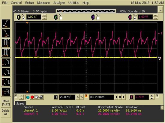

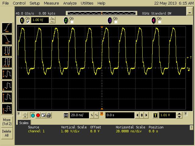

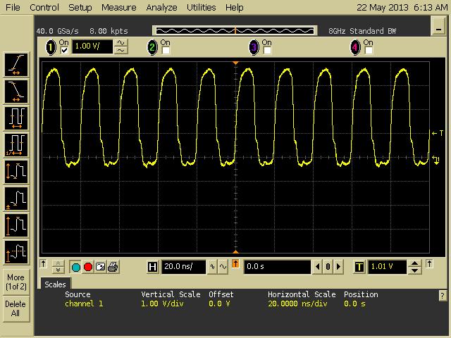

  • We've identified the issue.
    It turned out that the REFCLK was sourcing a 50 MHz clock that was colliding with the 50 Mhz Clock sourced by the LAN8720.
    The AM335x is not capable of sourcing the REFCLK which is stated in the Errata below and requires that it is sourced by the PHY for RMII operation
    Since our current prototypes are using PG 1.0 Silicon the RMII_IO_CLK_EN pin will be set to 0 by default.  This will result in both REFCLKs sourcing the 50 Mhz Clock waveform.
     In order to resolved this we had to set the rmii1_io_clk_en and  rmii2_io_clk_en bits to 1 in both the Uboot and the Kernel.
    The RMII Control registers can are controlled by the following register which is explained in the TRM (http://www.ti.com/lit/ug/spruh73h/spruh73h.pdf)
    Section 9.3.31 gmii_sel Register
    1.2.10 Changed Default Value of RMII Clock Source
    Section 9.3.31, gmii_sel Register and Errata Advisory 1.0.18.
    PG1.0: RMII1_IO_CLK_EN and RMII2_IO_CLK_EN reset value is 0.
    PG2.x: RMII1_IO_CLK_EN and RMII2_IO_CLK_EN reset value is 1.
    Advisory 1.0.16 RMII: 50-MHz RMII Reference Clock Output Does Not Satisfy Clock Input Requirements of RMII Ethernet PHYs
    REFCLK Sourced by the AM335x (Isolated):
    REFCLK Sourced by the LAN8720 (Isolated):
    REFCLK Collision:
