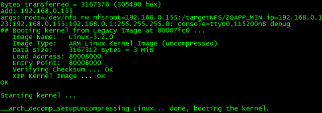

AM3359 stopped at Uncompressing Linux... done, booting the kernel.

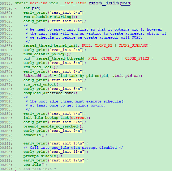

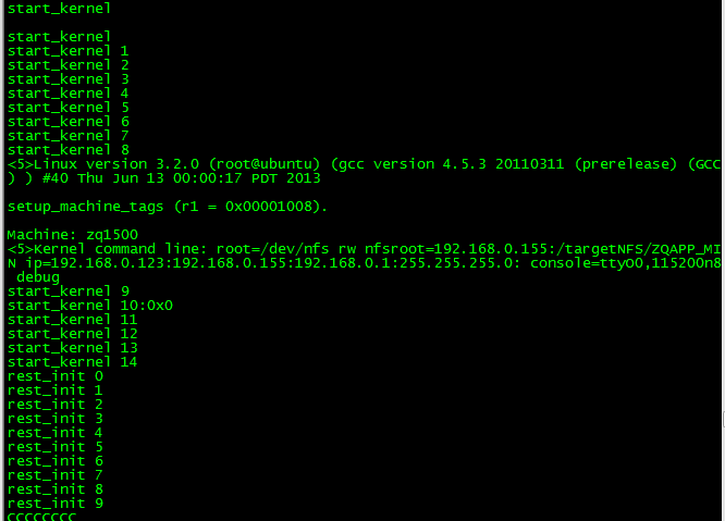

then we add some logs , we found that HW V1.1 Uncompressed successfully, but it can't change to start_kernel
it seems there is something wrong with the kernel, can anybody tell me the point? Thanks

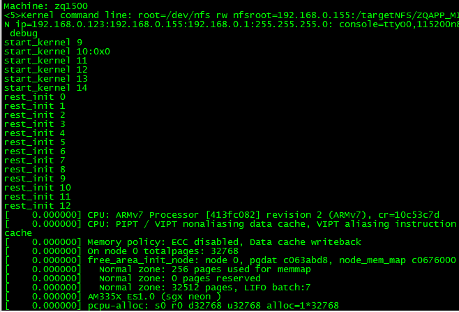

err logs:
normal logs
