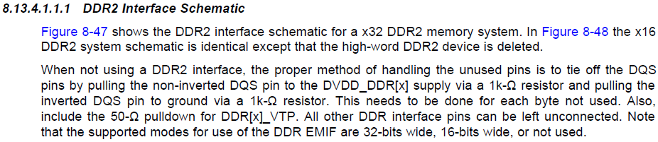

Hello.
My customer would like to NOT use the DDR I/F
There is no description about unused case of DDR I/F in the datasheet and TRM.

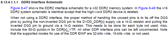

I looked at the AM3874 datasheet.
Its DDR I/F is almost same as AM335x DDR I/F, and unused case is described in the datasheet.
- Can I apply this guideline to the AM335x DDR I/F?
Or,
- Could you tell me how can I treat DDR pins as unused case?
AM3874 datasheet (sprs695b, P269):
Best regards, RY

  • Hello
    This is the recommendation configuration for the DDR pins in case the interface is not used for the AM335x processor. It is not recommended to leave any of the power pins floating unless otherwise noted.
    - Power the VDDS_DDR rail with any available 1.8V supply in the system.
    - Power the VDDS_PLL_DDR with any available 1.8V supply in the system.
    - Connect a weak pull-up to VDDS_DDR (or pull-down to GND) on the DDR_DQS0/1 pins. A value of 10K should suffice.
    - Connect a weak pull-down to GND(or pull-up to VDDS_DDR) on the DDR_DQSn0/1 pins. Make sure these are opposite of the non-inverted DQS. A value of 10K should suffice.
    - Connect a 50 ohm resistor on the DDR_VTP pin.
    - Leave rest of the DDR pins floating.
    Regards, Siva
