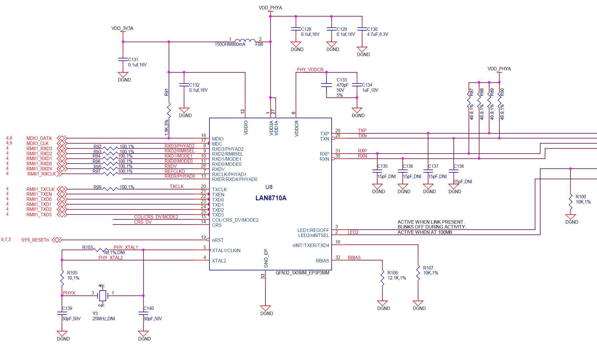

Hi, I have various custom am335x designed boards and One of them:
comes with a single PHY SMSC8710A with MII connection (same with beaglebone original).
50% of the time: it boots up successfully with PHY 0:00 fully functional. 50% of the time it boots with incorrect mdio address PHY 0:02. resulting networking not functional (error: PHY 0:00 not found)

I took some further investigation. It appeared to me in the file drivers/net/phy/mdio_bus.c after bus->reset(bus);
the phy mask changed from 0xfffffffe to 0xfffffffb, resulting PHY addr change from 0 to 2.
I have also tried to use phy_register_fixup_for_uid( BBB_PHY_ID, BBB_PHY_MASK, dummy);  in order to manually setting the phy_mask back to 0xfffffffe, but It helped nothing.
