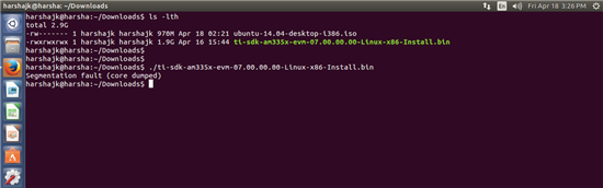

Hi All,
Please find the screen-shot attached herewith which shows the error log. I get Segmentation fault (core dumped) when I try to install the latest SDK (version 7) on Ubuntu 14.04 LTS 32 bit Operating system.

  • When I run as root- it just exits & does not install.

    #$ ./ti-sdk-am335x-evm-07.00.00.00-Linux-x86-Install.bin --mode text

    What really got me moving forward was the next line:
    # ./ti-sdk-am335x-evm-07.00.00.00-Linux-x86-Install.bin --mode text
    This finally executed without causing segmentation fault (core dump).

  • try:
    ./ti-sdk-am335x-evm-07.00.00.00-Linux-x86-Install.bin --help
    for other installation mode
  • Thank alot Marcus, It works for me!
