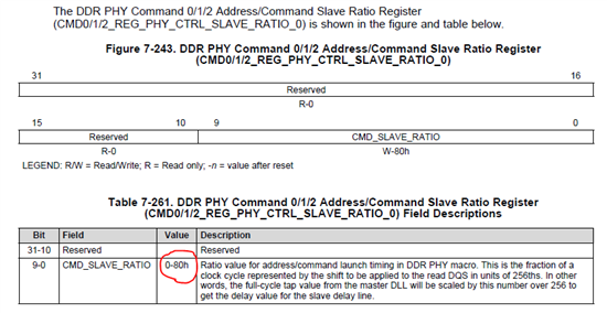

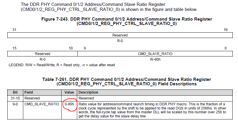

All 10 were working wonderfully for weeks now then i decided to move my speed from 303MHz to 400MHz.  After doing this i redid all the timing values and reran the leveling procedure.  9 of 10 worked fine after this, but the 10th was not functioning properly.  I found if i changed the CMDX_REG_PHY_CTRL_SLAVE_RATIO  from 0x80 (which was the value given to my by the RatioSeed spreadsheet) to 0x40 then my last board works too.  So I was looking into the reason for this and noticed in the RatioSeed spreadsheet this value is calculated by the following:
If PHY_INVERT_CLKOUT = 1 Then 0x100 Else 0x80
Then when i look in the TRM i notice this register says it can only have a value from 0 to 0x80.
So is there an error in either the TRM or in the ratio spreadsheet? According to the TRM this number is used to generate a ratio of 256ths so it would make sense that it could goto 0x100, but the values column says otherwise.  Plus i have that board that doesn't work with it set to 0x80 making me almost think the ratio spreadsheet should be:
If PHY_INVERT_CLKOUT = 1 Then 0x80 Else 0x40
I don't know though, I guess I don't fully understand what this value does and I'm just trying to figure out why changing it allows all my boards to function properly.

  • Jarrod and Taka,
    first, there is a typo in the TRM. The value has a range 0-100h. We will get this fixed.
    Second, this value should just be either 0x80 or 0x100 depending on the invert_clk value, as designated in the ratio seed spreadsheet. If you are getting 0x40 to work on some boards, there is some other underlying issue that is not correct.
