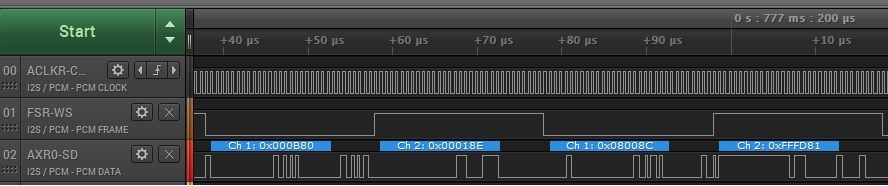

3) I connected the MCASP0 ACLKR, AFSR and AXR0 to logic analyzer, and see some signals (PICTURE1 below). Below are the terminal messages:

Q1) Is the PICTURE1 the expected result?
Q2) How do I modify from here (provided what I did so far is on the right track) to read signals from the external digital mic (the hardware is connected)? Are there any document/example that I can refer to?

    Using the AM335x loopback example, I think I have managed to get the McASP0 up with I2S comm (see attached below). I have it configured as below:
    MCASP0_ACLKR for B12
    MCASP0_FSR for C13
    MCASP0_AXR0 for D12
    Modified:
    #define RX_NUM_SERIALIZER (1u)
    #define TX_NUM_SERIALIZER (1u)
    Disabled the Loopback mode.
    I only have 1 ICS-43432, and I have the L/R pin tie to high, which means the valid data should be Channel 2; though I have no method to verify. Do you have any suggestion?
    In the function createStreams(), the software created channels for both TX and RX based on the Channel Parameters table. If I remarked the create channel for TX, and add only set ACLKXCTL ASYNC bit to 1 (so that the FSR can start clocking), I could not get anything on AXR0 (the line is always low). The software does not call mcaspAppCallback(). Why is this so? Is there any other setting? Or both TX and RX channel must be created?
    Thank you.

    The format looks better.
    Is your desired sample rate 2500 Hz. This is set in the AHCLKRCTL and ACLKRCTL registers. I use the Technical Reference Manual register definitions when verifying settings.
    Channel 1 looks possibly like audio data, although 2 samples can be deceiving.
    Channel 2 should be low. Perhaps termination could be used to set the level. The microphone data sheet recommends a pull down resistor termination on the data line of 10k to 100k ohms.
    You are correct. The application expects both the transmit and the receive to be defined.
    Audio_echo_Task which is instantiated in audiosample.cfg calls createstreams in audioSample_io.c  which creates the stream for the tranmit case and then for the receive case. If the transmit case fails then the receive case is not executed.
