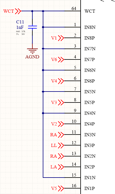

Here is the schematics for the connection of the input stages of the ECG leads to the AFE, taking in your consideration that the PGA of the AFE is set to 6.
According to the datasheet, to acquire the pacemaker pulses, only one channel must be selected at a time, so we select channel 2 to acquire the pacemaker pulse from the TESTP_PACE_OUT.

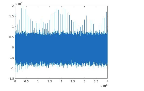

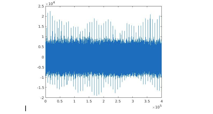

The problem appears with the pulses with small values or duration, and here is the spectrum for the samples after performing the filters (Analog and digital) on it.
2mv - 2ms
2mv - 500us
2mV - 100us
As you can see here, the pulse of the pacemaker signal is so small, the 2ms and 500us duration can be detected, but the smallest one (with 100us duration) can not be detected due to its small duration and amplitude.
Also, the signals taken from the other pin (TESTN_PACE_OUT) contains higher noise than the even ones.
Is there any way to reduce this noise, or to detect these small pulses.
Also another question, according to IEC 60601-2-25/27/47, it's required to detect the pace on every single channel, including the chest leads also, in this case how we can configure the PACE Register?, as you can see, the chest leads are connected to the WCT on there negative differential side.
