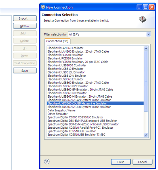

Is it possible to connect CCS 5.1 simultaniously to two EVM6457 boards?
In out test setup, we have 2 EVM 6457 boards with the SRIO connected between them. We are developing the srio SW. and desire to drive both boards from a single PC.
We have created 2 instances of the Blackhawk XDS560v2-USB Trace Emulator as targets. Using the test conection button it appears both can have a connection to the same board, which they find on USB. Is there a was to specify the USB port to be used by the Blackhawn Emularor?
Thanks in advance

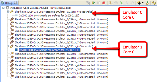

  • Robert,
    Working with Rafael this morning, we were able to get two identical EVMs running on my CCSv5.2.0.00069 installation. My BlackHawk emulator drivers are updated, and I noticed the version number on the BH560v2 Config Utility is 1.0.0.9. I am not sure what the version number for the BH drivers is.
    In my case, I was using two EVM6678-LE boards, so both have the BH 560v2 Mezzanine emulator on-board. There should be no difference in terms of getting this to work with your system even though your EVM has a different device. The emulation issues will be identical.

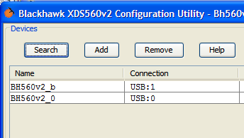

    A convenience step (I do not believe it is required) is to use the BH 560v2 Config Utility to put a dtc name on each emulator board so it can be easily identified for figuring out the order of the boards in the CCS configuration. If you plug in the USB and apply power to only the first board, open the BH 560v2 Config Utility and let it find the board. Select that board in the Devices pane at the top, then click Edit Device Parameters in the Device Configurations Options pane in the lower right. Click on the dtcName parameter and type in a string in the edit box blow the list; click Set. Then you can unplug that EVM, then plug in the USB and apply power to only the second board, repeating the process to give a different name to the second board. I would use a name that does not end in _0 and _1 because that could get confusing with the automatic naming that will occur later; I used _0 and _b, but would use _a and _b now.
    With both boards disconnected and powered off, plug in the USB and apply power to the first board. Open the BH 560v2 Config Utility or click Search if it is already open. Confirm the name and notice the Connection column to see if it is USB:0 or USB:1. Now plug in the USB and apply power to the second board also. click Search in the BH 560v2 Config Utility, look for the second board's name and notice the Connection column to see if it is USB:1 or USB:0.
    As a test, I connected board BH560v2_0, which showed up as USB:0, then added board BH560v2_b, which showed up as USB:1. I then disconnected BH560v2_0 and clicked Search to find that BH560v2_b switched to USB:0. When I had plugged board BH560v2_0 back in, it showed up at USB:0 and BH560v2_b switched back to USB:1. This tells me that the USB Connection order is not based on the sequence when they are connected but the order of the physical USB ports of the PC. If that is true, then you will be able to have the boards in the same order each time as long as you have them plugged into the same USB ports on your PC.
    If both boards show up in the list, then you have the requirements for making this work. If only one board shows up, then you have issues with your USB connections and it will not work. In the beginning, I kept having only one board show up at a time. When I would power up the second board, the first one would go away. That problem ended when I quit trying to use a USB hub for either board, and instead just connected directly from both boards to my laptop. Be aware that some PCs may implement USB hubs for multiple ports, and this may not work with those. Some docking stations also implement hubs, and this may not work with those.

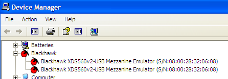

    An early clue that the USB ports are separated is to watch the Device Manager window to see if there are two items under the Blackhawk (for example) item. The picture below shows two emulators are active.
    Once you get to this point, all you have to do is create a new Target Configuration and start your debug session in CCSv5. Here are the steps to create a Target Configuration with both emulators.

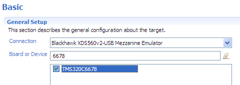

    1. Create a New Target Configuration for a single EVM. For my case, I selected the Blackhawk XDS560v2-USB Mezzanine Emulator and the TMS320C6678.
    2. After clicking save and then clicking on the Advanced tab in the bottom left, you will see the correct Target Configuration for a single EVM. I like to move slowly, so I tried this with one board to make sure the connection works and I can connect to the board in the debugger. If you do that, Terminate the session before coming back for the next step.
    3. To add the second EVM, go back to the Target Configuration you just made for the single EVM and go to the Advanced tab again. Click the New button and find the same BH Mezzanine Emulator in the Connections list. Double-click on it or select it and click Finish.
    4. Select the new Emulator_1 line and set the I/O Port to 1 on the right side.
    5. With  the new Emulator_1 line still selected, click the Add button, change the "Filter selection" to your ISA (TMS320C66xx for my board, TMS320C64xx for the C6457, and so on), go to the Devices tab and select the device you want.
    6. Your Target Configuration will now look like this. Some of the tree has been collapsed to make this fit on the forum better.

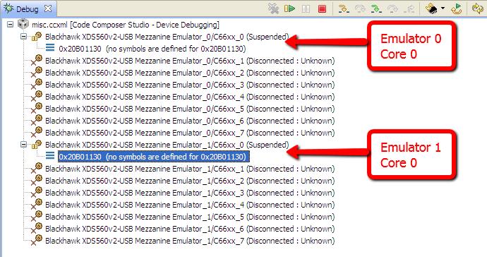

    7. Click Save, then Launch this Target Configuration. For my confirmation, I Connected to Core0 of both Emulator_0 and Emulator_1. With one of those selected, I used a Memory Browser Window to go to local L2 at 0x00800000. I changed a value there to 123, then selected the other Core0 and went to 0x00800000, observed that the 123 was not there and changed the same offset value to 654, then went back to the first Core0 to make sure the two were unique so I was really working on two different boards.

    I ran into some forum limit on images or post length. Here is my picture for #6. You can tell that I meant for there to be a picture there, but my re-edit did not catch up.

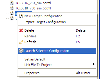

    7. Once you have saved the Target Configuration, you can go to the Target Configurations window where this Target Configuration is listed, then right-click on it and click on the Launch Selected Configuration. This will open the Debug Perspective and for my EVMs I got the second picture below.
    Debug Perspective / Debug Window:
    Since you already have something looking close to what I showed above, I think you are very close to this working. Your pictures show both emulators in the BH Config Utility, which is key.
    You definitely only want one instance of CCS running at a time for this method we are discussing here.
