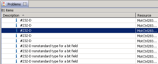

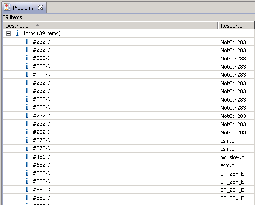

  • Thank you for your answer.
    This was done with a new workspace in which I imported a existing project.

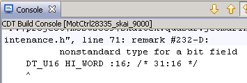

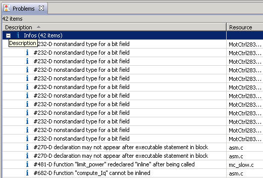

    The console output seems to be ok, the "Problems" window which lists all the erros, warnings and remarks as summery is the one which  is affected.
    The output without -pdv (verbose diagnostics is deactivated):
    In the console the remark is one line:
    All OK.
    Now with -pdv
    In this case the remarks on the console output take more than one line (this must be the problem for the Problems window):
    The additional mentioned 'feature' is:
    If a do simply a "Build" (without Clean before), the Problems view is not cleared as it was before 5.2.1. The warnings and remarks of last build are still listed. Here you can see the output of 2 builds (one without -pdv, one with -pdv)

  • Roger,
    Thank you for the clear explanation. I can reproduce the issue with the Problems view displaying only the first line of a multi-line remark. I have filed bug # SDSCM00044803 to track this issue. Feel free to track it using the SDOWP link in my signature.
