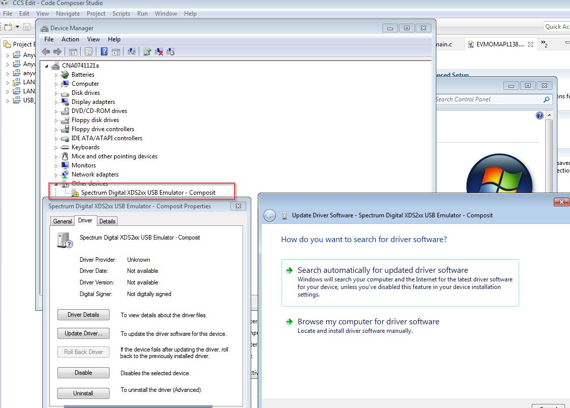

  • Hi John,
    Is there a way to force the XDS200 driver installation?
    Using CCSv6 on Win7 the XDS200 driver does not seem the be installed or found.
    See below picture:
    Where is the driver file located so that I can manually install it?
    I am trying to use the XDS200 through an AnywhereUSB (for Ethernet to USB interfacing). The XDS200 is detected when connected to the AnywhereUSB but the drivers can not be found.
    I tried as well with the BH USB560 (in fact LAN560 but used via USB) on the AnywhereUSB and in this case the driver is found and installed successfully.
    Anthony
  • Anthony,
    You could try right clicking on the inf file in \ccsv6\ccs_base\emulation\windows\xds2xx_drivers and selecting install.
    John
