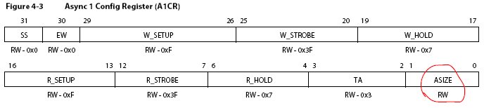

    That means ASIZE bit area of Async 1 Config Register(A1CR) is 0. But there is no reset values in sprugz3a.pdf, as following:
    Guoman
  • Actually ASIZE = 1 is 16-bit mode. The default (reset) value for ASIZE is 1. I will make sure the reset value is clarified in the users guide going forward.
    The timing values used will be default as shown in the figure for read and write setup/strobe/hold as well as turnaround (TA).
