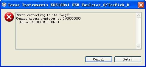

TMDXEVM6678l "IcePick_D: Error connecting to the target: Cannot access register at 0x00000000 (Error -2131) @ 0 (0x0)"
Other Parts Discussed in Thread: TMS320C6678
I buy a kit of TMDXEVM6678LE,
my CCS version is: 5.0.3
I setup an new target configuration:
and launch, when I connect target, there is a error:
please tell me how i can deal with this problem. Thank you in advance.

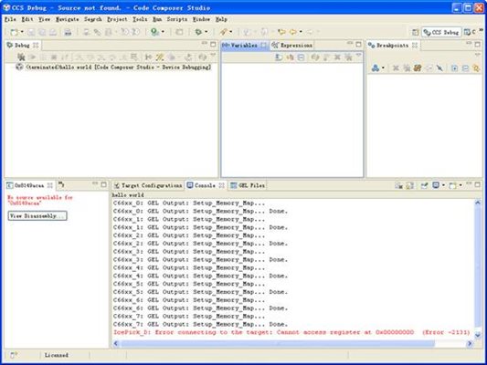

  • Did you attach the GEL file for each core in Target Configuration--> Advanced?
    The GEL for TMDXEVM6678LE should located in 'xx:\Texas Instruments\ccsv5\ccs_base_5.0.3.00023\emulation\boards\evmc6678l\gel'
  •  I just want to run the program "hello world",  can you tell me in detail about " attach the GEL file for each core in Target Configuration--> Advanced? ",  my target configuration file is  TMS320C6678, and use XDSv1 USB emulater.
  • Hi jeremy,
    Firstly you should open the  target configuration file such as C6678.ccxml. Choose XDSv1 emulator for C6678 device and click save. Then in the lower left corner find the advanced button and click in.
    Then you can see the list of 8 cores in left side of window. And click each of these cores "C66xx_0"~"C66xx_7", you will see a initialization script in the right side, then locate the GEL file for each core and click save.

  • Hi Allen,
        I have tried to initialize these cores "C66xx_0"~"C66xx_7" with GEL file. but the result shows
    So I donot know weather the Evaluation module has problem or others,  I also try it in another PC and restall the software saveral times, the problem remains.

  • Jeremy, Allen,
    The linker command file (or lack thereof) will not have any effect at this point.  The linker command file tells the compiler where to put sections when building an application.  Having an incorrect one can cause problems when you try to load a .out file, but we're not at that point yet.  Jeremy is just trying to connect to the device.
    At this point, there,problems can be binned into a few categories.  1. CCS Install Issue (missing drivers, XML files, etc). 2. CCS Target Configuration problem.  3. Target Configruation issue (i.e. board not hooked up right) or 4. Windows issue (USB driver not installed correctly)  or 5.  Board Issue (some problem specific to your board.)
    For #1, make sure you've installed CCS 5.0.3.  If you have, I doubt this is the issue.
    For #2, the most obvious problem would be something like selecting XDS100v2 instead of XDS100v1, or selecting the wrong target (make sure you have XDS100v1 and C6678 selected.
    # 3 might be a USB conection issue.  I doubt this is the issue, but make sure the USB cable is properly connected.  Check your Device Manager in Windows and make sure you can find an XDS100 Channel A and Channel B in the list of USB devices.  If you don't see this, then we likely need to reprograom your XDS100, and I can tell you how to do that.
    Assume for now it's not #4.  This is rare. And assume it's not #5 for now also, unless we can't attribute it to one of the prior issues.

  • Allen, Dan,
         Thank you for your help. The problem has been solved. Thank you. I removed the external emulator and connected to the target throngh XDS100 embeded emulator successfully.  Maybe there is conflict between those emulators. My second error is because the project lacked of .cmd file.
