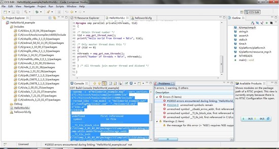

      I  download 7.4.0B2 code generation tools  to compile "helloworld_example" project, but  when i build the project and  i have following errors:
    **** Build of configuration Debug for project HelloWorld_example ****
    C:\ti\ccsv5\utils\bin\gmake -k all
    'Building target: HelloWorld_example.out'
    'Invoking: C6000 Linker'
    "C:/ti/ccsv5/tools/compiler/c6000/bin/cl6x" -mv6600 -g --display_error_number --diag_warning=225 --abi=eabi --openmp -z -m"HelloWorld_example.map" --warn_sections -i"C:/ti/ccsv5/tools/compiler/c6000/lib" -i"C:/ti/ccsv5/tools/compiler/c6000/include" --reread_libs --rom_model -o "HelloWorld_example.out" -l"./configPkg/linker.cmd"  "./HelloWorld.obj" -l"libc.a"
    <Linking>
     undefined           first referenced
      symbol                 in file
     __TI_tls_block_size C:\ti\omp_1_01_02_06\packages\ti\omp\utils\lib\debug\ti.omp.utils.ae66<ThreadLocalStorage.oe66>
     __TI_tls_init       C:\ti\omp_1_01_02_06\packages\ti\omp\utils\lib\debug\ti.omp.utils.ae66<ThreadLocalStorage.oe66>
     __c6xabi_errno_addr C:\ti\omp_1_01_02_06\packages\ti\omp\lib\debug\ti.omp.ae66<env.oe66>
    error #10234-D: unresolved symbols remain
    error #10010: errors encountered during linking; "HelloWorld_example.out" not
       built
    >> Compilation failure
    gmake: *** [HelloWorld_example.out] Error 1
    gmake: Target `all' not remade because of errors.
    **** Build Finished ****
    i used  IPC 1.24.2.27     PDK  1.1.03   OPENMP  1.01.02.06_BETA  SYS\BIOS  6.33.04.39  BIOS_MCSDK   2.01.03  BETA
    Would you please let me know how to fix the problem? Thank you.

  • Can you please try with Compiler cgtools version 7.4.1, available at
    https://www-a.ti.com/downloads/sds_support/TICodegenerationTools/download.htm
    Hope this resolves.
