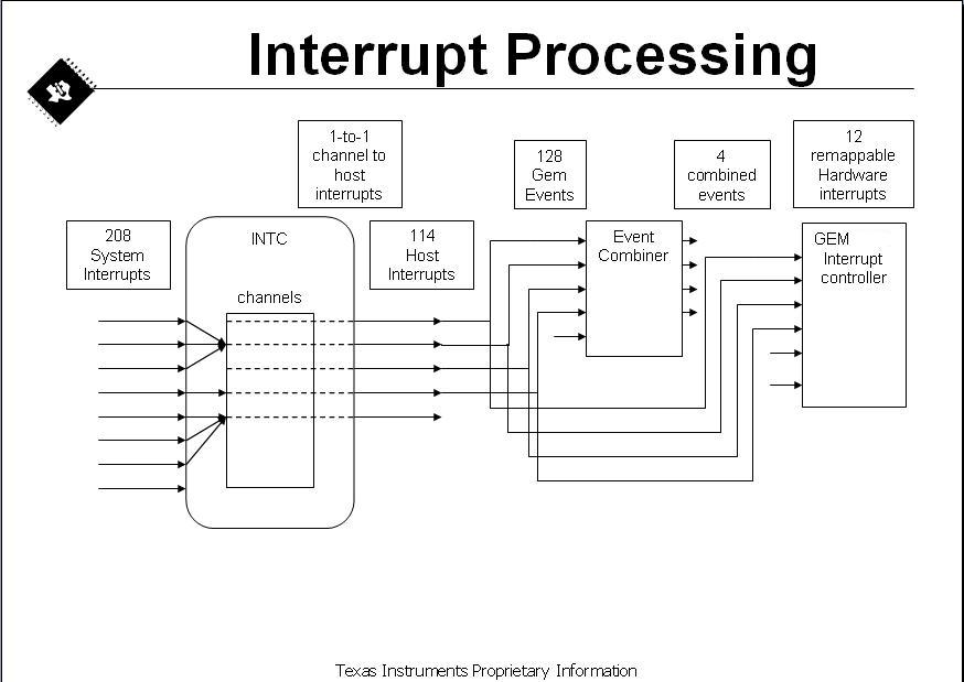

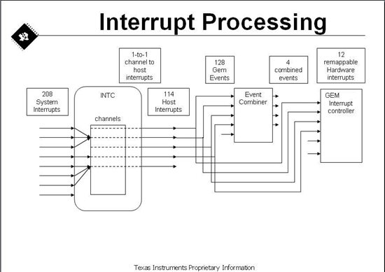

  • RC Reddy,
    I don't know the answer to questions #1-4
    As far as #5 is concerned.  CpIntc_dispatchPlug simply plugs a table with your function and argument.  This table then is used by CpIntc_dispatch when processing CpIntc interrupts.
    Hwi_create() - this plugs the interrupt vector and the ISR fxn.  When using CpIntc, you must plug the Hwi fxn with CpIntc_dispatch so it knows how to process the CpIntc interrupts.
    CpIntc- deals with System interrupts and Host Interrupts.
    Hwi - deals with the GEM interrupt contorller.
    EventCombiner - deals with the Event Combiner.
    Here is a picture, hope this helps:
    Judah
