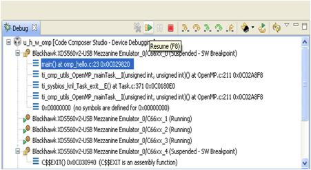

[C66xx_0]
[C66xx_0] Starting values of matrix A and vector b:
[C66xx_0]   A[0]= 1.0 2.0 3.0 4.0 5.0 6.0 7.0 8.0 9.0 10.0   b[0]= 1.0
[C66xx_0]   A[1]= 1.0 2.0 3.0 4.0 5.0 6.0 7.0 8.0 9.0 10.0   b[1]= 2.0
[C66xx_0]   A[2]= 1.0 2.0 3.0 4.0 5.0 6.0 7.0 8.0 9.0 10.0   b[2]= 3.0
[C66xx_0]   A[3]= 1.0 2.0 3.0 4.0 5.0 6.0 7.0 8.0 9.0 10.0   b[3]= 4.0
[C66xx_0]   A[4]= 1.0 2.0 3.0 4.0 5.0 6.0 7.0 8.0 9.0 10.0   b[4]= 5.0
[C66xx_0]   A[5]= 1.0 2.0 3.0 4.0 5.0 6.0 7.0 8.0 9.0 10.0   b[5]= 6.0
[C66xx_0]   A[6]= 1.0 2.0 3.0 4.0 5.0 6.0 7.0 8.0 9.0 10.0   b[6]= 7.0
[C66xx_0]   A[7]= 1.0 2.0 3.0 4.0 5.0 6.0 7.0 8.0 9.0 10.0   b[7]= 8.0
[C66xx_0]   A[8]= 1.0 2.0 3.0 4.0 5.0 6.0 7.0 8.0 9.0 10.0   b[8]= 9.0
[C66xx_0]   A[9]= 1.0 2.0 3.0 4.0 5.0 6.0 7.0 8.0 9.0 10.0   b[9]= 10.0
[C66xx_0]
[C66xx_0] Results by thread/row:
[C66xx_0] ti.omp.utils.ThreadLocal: line 132: assertion failure: A_invalidKey: Invalid key encountered
xdc.runtime.Error.raise: terminating execution

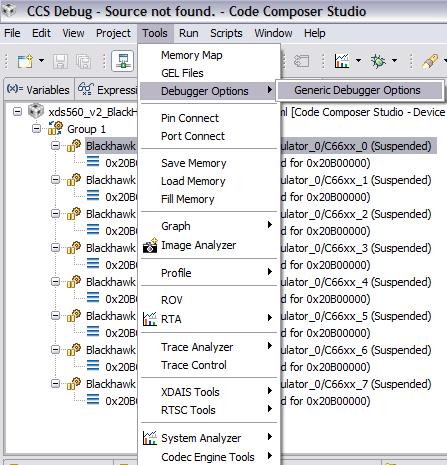

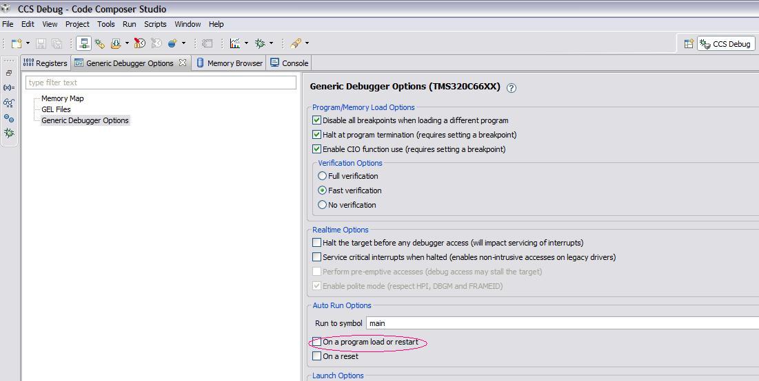

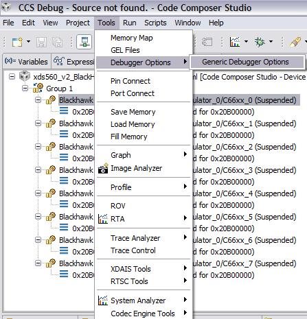

    Can you'll please try the following and let us know if it solves the problem
    1. Select Core 0 and then go to Tools--> Debugger Options --> Generic Debugger Options
    2. Under 'General Debugger Options' ---> 'Auto Run Options' uncheck the box that says "On a program load or restart," and click "Remember My Settings" at the bottom
    3. Repeat steps 1 and 2 for all cores
    4. Load the .out file on each of the cores (or you can group them like you were doing earlier)
    5. Run the program on all cores

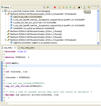

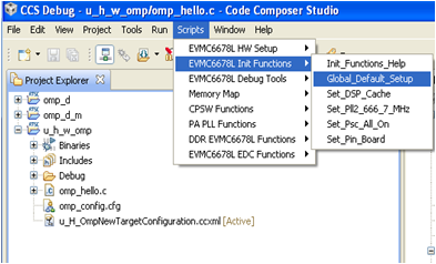

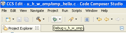

    I didn`t try Udays suggestions yet but I did solve my problem. by the following way.
    Step1.Debug
    Sometimes this error occurs (if it does I ignore it and debug again)
    Step 3.
    •Scripts-> EVMC6678L Init Functions -> Global_Default_Setup
    Step 4.
    •Press Restart
    Step 5.
    •Select Resume
    As I said before I didn't tried Udays suggestions yet but I will try it as soon as I get my board back (I dot have it now)
    Umar
  • Both UDay's and Umar's suggestions worked for me, but turning off auto-run is a bit of a nuisance during debug, is there any other way round this problem that won't slow down my workflow?
    When the problem happens, repeated retries always make it work, but when I've got a real application with real bugs, I don't want random ones like this causing confusion- any ideas of how to fix the source, configuration or CCS setup so this problem is properly fixed?
    Is there some synchronisation needed between the cores so they start up correctly?
