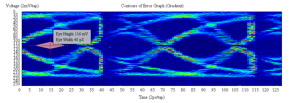

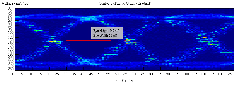

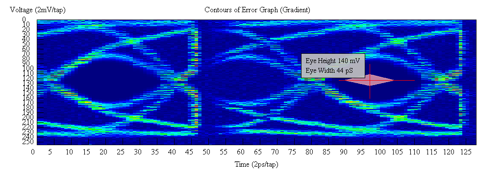

Hi!
We use custom board with Keystone 2 66AK2E05 <--> DS100DF410 <--> SFP_Module_10Gb.
We are testing a 10GbE link on line 0 between two our boards. We use utilities iperf3 and netperf under Linux (last SDK). We can not get a speed higher than 1.7 Gbit / s. Processor utilization does not exceed 25%.
SFP modules and cable have been tested on another system. They are capable of running at 10 Gbit / s.
Here is a discussion about the settings of the retimer.
What is our problem?

  • Rex,
    we run eye and ber tests:
    There are two questions:
    1. What is these artifacts in the eye diagram?
    2. How can I measure the data rate?
  • Hi, Eduard,
    The BER looks good, all green and centered. I am not familiar with EYE diagram and had forwarded to Hardware for more info. I did a google search on ethernet eye diagram, but think you may need more info than that wiki page. I'll post back if I heard back from hardware engineer.
    Rex
  • Eduard,
    How is the DS100DF410 implemented around the 66AK2E05?  Does one exist both in the RX path and the TX path or only in one direction?  Is it physically close to the  66AK2E05?  How close?
    The DS100DF410 has the ability perform RX equalization and then transmit shaping.  It can also interface with SFP+ modules that require interface metrics that the  66AK2E05 cannot meet.
    The EYE tool uses the capabilities of the receiver logic in  66AK2E05 to image the eye diagram *after* RX equalization has been performed.  It then provides an estimate of the eye amplitude and the eye width.  The images provided look very good.
    The EYE tool works in tap delay increments.  It is not aware of the data rate.  If you are not certain that your data rate is correct, I recommend using an oscilloscope to measure the data rate.
    The multiple levels in the eye diagram are the result of inter-symbol interference.  This is normal in multi-gigabit interfaces.  The RX equalization adjusts the receiver logic to maximize the eye opening.
    Tom
  • Tom,
    The retimer is installed on the Rx and Tx lines.
    The screenshot shows the part of the board and the differential lines SFP connector - retimer - Keystone. The length of the lines in the table on the left.
    The Serdes Diag User Guide  shows a drawing of eye diagram:
    But on our diagram there are some strange artifacts. I highlighted them with a red ellipse:
    Why is that?
  • Eduard,
    The routed lengths look reasonable.  Since the links are short, you might want to try adjusting the TX settings in the DS100 so that the eye image at the K2K device is improved.  Over-driving the receiver creates non-linear distortion that the receiver cannot equalize.
    The part of the eye image circled above in red is an artifact of the eye tool.  It is not part of the true image.  Do you see the same thing on every run?  The recovered clock from the CDR appears to have a phase alignment that causes the eye tool to saturate at the edge of the image and the results are distorted.  Regardless of whether you can make this go away, it is not indicative of a transmission problem.
    Tom
  • Hi Tom!
    Yes, every run.
