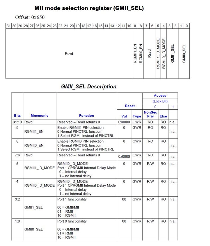

I'm troubleshooting an issue with a AM3874/TI8148 talking to a Broadcom gigabit PHY using RGMII.  The processor can receive data at gigabit link speeds, and sends replies out the RGMII interface, yet the PHY fails to send this out to the magnetics.  This leads me to question the internal delay for GTXCLK-to-TXD[3..0] signals on the EMAC for the processor.
The AM3874 datasheet mentions a "EMAC RGMII_ID_MODE_N register" (pg 222-223) that controls whether this internal delay is enabled or disabled; however I can't find any more information about this register.
Does somebody know what it's memory address is and have a description for each bit?

    RGMII internal delay can be controlled using GMII_SEL register. Its offset is 0x48140650. The description as follows.

  • This was my issue, thank you very much.   After I updated the value to 0x112 and all is well on my end for RGMII0.
    For others interested, I updated u-boot which set this register in board_init().  The previous code was __raw_writel(0x30a,GMII_SEL);
    I have another question, do you know if RGMIIx_ID_MODE affects the internal delay for RX and TX clocks?  It doesn't explain exactly, and I'm trying to understand why disabling the disabling the GTXCLK delay on the PHY didn't resolve the problem in the same manner.
