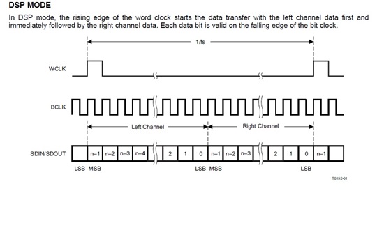

I am working on a custom dm8148 board and we have a hdmi rx to feed stereo I2S audio data to the McAsp of Davinci.
When I trying to modify audio format in davinic-evm.c from SND_SOC_DAIFMT_DSP_B to SND_SOC_DAIFMT_I2S, I can only get either left or right channel data.
Then I checked the davinci-mcasp.c driver file and found that it seems right now McAsp only support DSP mode.
It is okay for tlv320 analog decoder, cuz it support either I2S or DSP mode, however it is a big issue for us. We only have standard I2S audio data from our HDMI rx.
Could any TI employee clarify this for us, in the datasheet of DAvinci 8148, it clearly claim support I2S mode however, in the driver only support DSP_B mode?
How can I set the registers to support standard I2S mode? I hope this is only a driver side limitation.

  • I found following comments from /sound/soc/davinci/davinci-i2s.c:
        case SND_SOC_DAIFMT_I2S:
            /* Davinci doesn't support TRUE I2S, but some codecs will have
             * the left and right channels contiguous. This allows
             * dsp_a mode to be used with an inverted normal frame clk.
             * If your codec is master and does not have contiguous
             * channels, then you will have sound on only one channel.
             * Try using a different mode, or codec as slave.
             * The TLV320AIC33 is an example of a codec where this works.
             * It has a variable bit clock frequency allowing it to have
             * valid data on every bit clock.
             * The TLV320AIC23 is an example of a codec where this does not
             * work. It has a fixed bit clock frequency with progressively
             * more empty bit clock slots between channels as the sample
             * rate is lowered.
    Although this driver file is for old mode Davinci, it this also the case for DM8148?
    Please verify.
    Jun

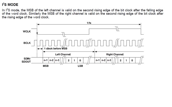

    Maybe I am wrong. My HDMI rx will output standard I2S master Wclk and bclk to DM8148.
    I was expecting McAsp can accept data as following way.
    However, I checked the driver of McAsp, and found it only support namly DSP mode.
    Do you have any idea, how to set McASp to take standard I2S?
    Or, If McBSP is the right one to process I2S data, how can I enable that in EZSDK5.04?
    Jun

    In section 17 of McBsP, it seems that McBsP can accept true I2S (first figure above).
    Here are my questions:
    1. Right now McAsp is all I got. If it cannot receive true I2S, is any way I can do to access the data registers to convert the audio data to the right format I want?
    2. How can I enable s/pdif receive mode in McAsp in the dirvers? By defult, s/pdif receiver mode seems to be deactive in ezsdk5.04?
    3. If I want to implement 4 channel true I2S, how can I do that?
    Jun

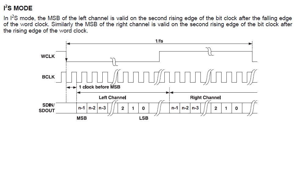

  • Hi Andreas,
    Glad to know that I am the only one facing this issue.
    We have the same problem as you. dm8148 working as slave mode and get stereo data and clocks (wclk,bclk) from our HDMI rx.
    I2S protocol will insert frame sync bit before MSB of left and right channel, however McAsp by default working at DSP_B mode and will consider that frame sync bit as MSB. So far we have not prograss well, the audio I captured is full of noise.
    Could you please share more details with us regarding the driver file you modified?
    Did you mean you modify the function static void davinci_hw_param(struct davinci_audio_dev *dev, int stream) of davinci-mcasp.c?
    Jun
  • Hi Jun,
    to get the driver working in i2s mode, you have to modify the static void davinci_hw_param(struct davinci_audio_dev *dev, int stream)  function. We added a case for case SND_SOC_DAIFMT_I2S with register settings corresponding to our i2s device.
    Andreas

  • Jun,
    here our code for the reception of a 32bit wide stereo i2s data stream. we receive frame, clk and data over mcasp2.afsx, mcasp2.aclkx mcasp2.axr0 working in ASYNC=0 (synchronous mode).
    soc-dai.h:
    #define SND_SOC_DAIFMT_I2S_WORD16   7 /* I2S mode slot-size 16*/
    davinci-mcasp.c:
    static int davinci_mcasp_set_dai_fmt(struct snd_soc_dai *cpu_dai,
                         unsigned int fmt)
        struct davinci_audio_dev *dev = snd_soc_dai_get_drvdata(cpu_dai);
        void __iomem *base = dev->base;
       switch (fmt & SND_SOC_DAIFMT_FORMAT_MASK) {
             //codec is using i2s data format 32bits
             mcasp_set_bits(base + DAVINCI_MCASP_RXFMCTL_REG,   0x00000111);
             mcasp_set_bits(base + DAVINCI_MCASP_RXTDM_REG,     0x00000003);
             mcasp_set_bits(base + DAVINCI_MCASP_RXFMT_REG,     0x000180F4);
             mcasp_set_bits(base + DAVINCI_MCASP_ACLKXCTL_REG, ACLKXPOL);
             break;
