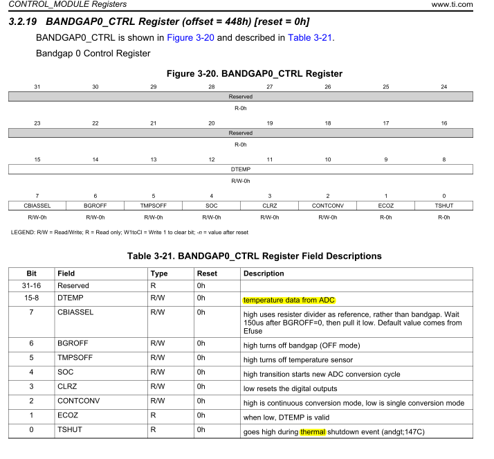

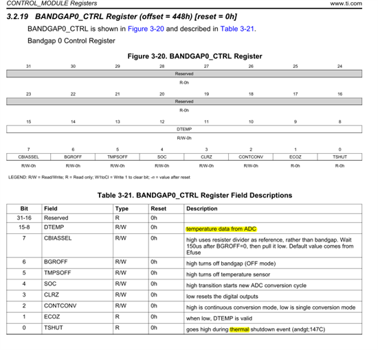

Is their an internal core temperature sensor that Smart Reflex uses to determine the Adaptive Voltage Scaling of the processor?  If so must it be enabled in the kernel or in u-boot? Cann its values be accessed, i was unabl to find a register in the TRM.
Technical Reference Manual:
