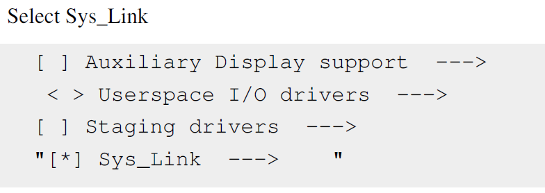

    In TI81XX_VPSS_Video_Driver_User_Guide
    sys_link is choosed ,so I think where was no modules that named syslink.ko
    but in the filesystem /etc/init.d/load-hd-firmware.sh have the following sentences:
    "modprobe syslink
    until [[ -e /dev/syslinkipc_ProcMgr && -e /dev/syslinkipc_ClientNotifyMgr ]]"
    enson
    Syslink is divided into two parts. One is kernel level syslink and other is Userlever syslink. Kernel level syslink is handled by above flag. While for userlevel syslink you need to have syslink package.  Kernel level syslink contains only notify which is used by Linux video drivers. But userlevel syslink support many other features
    I have rebuilt the kernel and the question then insmod the prebulit syslink.ko
    It have error:
    syslink: disagrees about version of symbol module_layout
    FATAL: Error inserting syslink (/lib/modules/2.6.37/kernel/drivers/dsp/syslink.ko): Invalid module format
    What should I do,rebuilt the syslink.ko?But I don't know how to built it,please tell me the steps.
    thank you
    enson
