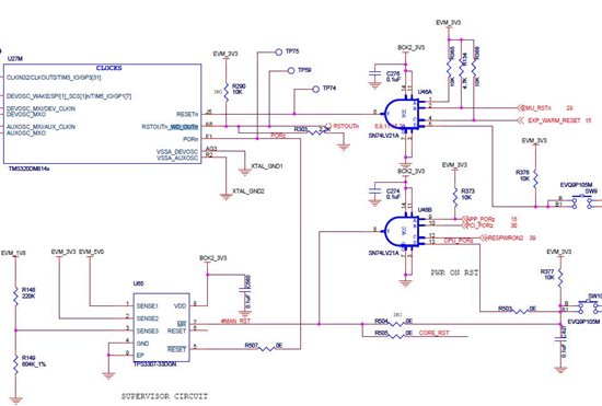

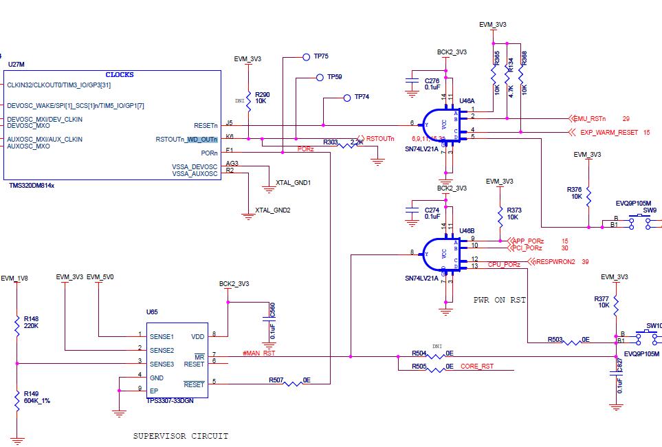

    Below is part of  hardware schematic of TI8148 EVM board which is related with RSTOUTn_WD_OUT.
    I do not know if there is something wrong with the circuit.
    I have test sawatchdog in TI8148EVM board, but I do not see RSTOUT_WD_OUTn is pulled low when watchdog overflow.
    I also use SD card that comes from with TI8148 EVM board and execute sawatchdog to test  RSTOUT_WD_OUTn, but the result is the same.
    RSTOUT_WD_OUTn is always high even though the watchdog overflow and system reboot.
    I compared with my working circuit, everything is the same. Please make sure you are attaching the oscilloscope to TP59 (RST OUT) and TP67 (GND). Also double check your oscilloscope settings. The expected/default RSTOUT_WD_OUTn signal is 600ns.
