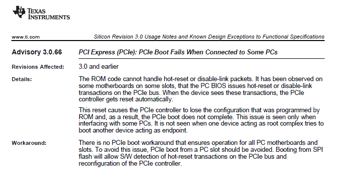

  • Hi Pavel
    I note the following errata:
    Advisory 3.0.66 PCI Express (PCIe): PCIe Boot Fails When Connected to Some PCs
    Revisions Affected:3.0 and earlier
    Details:
    The ROM code cannot handle hot-reset or disable-link packets. It has been observed on
    some motherboards on some slots, that the PC BIOS issues hot-reset or disable-link
    transactions on the PCIe bus. When the device sees these transactions, the PCIe
    controller gets reset automatically.
    This reset causes the PCIe controller to lose the configuration that was programmed by
    ROM and, as a result, the PCIe boot does not complete. This issue is seen only when
    interfacing with some PCs. It is not seen when one device acting as root complex tries to
    boot another device acting as endpoint.
    Workaround:
    There is no PCIe boot workaround that ensures operation for all PC motherboards and
    slots. To avoid this issue, PCIe boot from a PC slot should be avoided. Booting from SPI
    flash will allow S/W detection of hot-reset transactions on the PCIe bus and
    reconfiguration of the PCIe controller.
    Does TI have u-boot or linux driver code that shows how to apply the workaround?.
    thanks
    Steve

  • Hi Pavel
    Any more info on this?.  I need u-boot code to support the  following highlighted statement:
    Workaround:
    thanks

  • Pavel,
    The patched updates did not resolve the issue.
    The issue is stated in the DM814x Errata, Advisory 3.0.66 PCI Express (PCIe): PCIe Boot Fails When Connected to Some PCs.
    Is there any work being done on our end to find a work-around? In this application it is not an option to boot from SPI flash.
